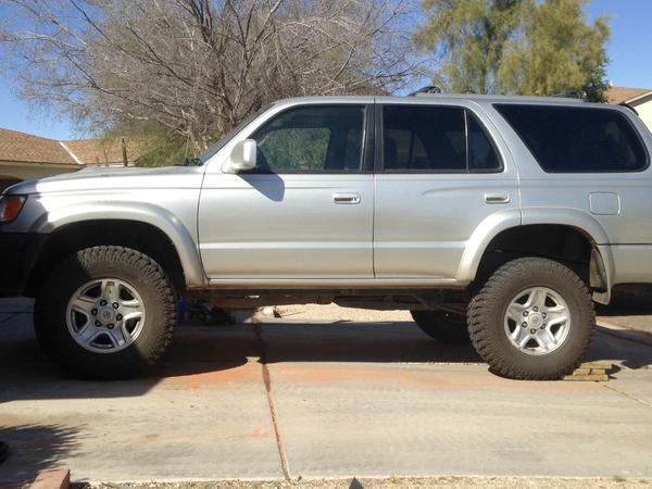

Yeah I heard the tundra coils are a little more comfortable than the omes. I do like the ride of my 881s though. But the front shocks are on the second perch also. Probably smoother on the bottom one. Which they will probably be on soon. Starting to look like some negative rake
So I've been looking at lift options for the truck I just bought. I think I've decided that the lift springs from OME seem like the way to go for me. I'm leaning towards the 881/890 combination. The truck has 222k on it so I'm thinking I should replace the shocks as well? Or is it possible that I could get away without doing that now and maybe doing it sometime down the road if it becomes necessary? The picture shows how it currently sits on 265/70/16s, any advice is greatly appreciated!

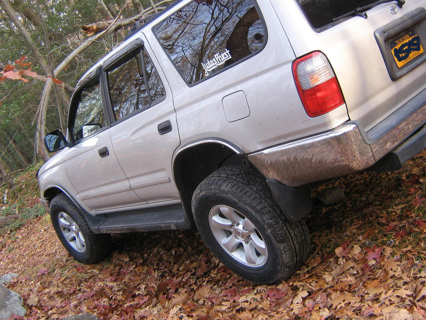

I know highway tires aren't sexy but they're cheap. I have these in my yard with about 5000 miles on them... I should sell them!
They still got me down easy trails because of the new meat. (from 2 years ago)
