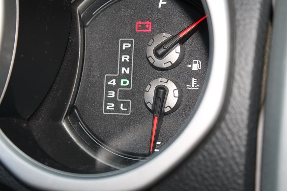

Hmmm curious. I do like a mystery lol.

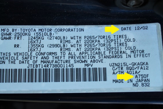

carfax says it was purchased and registered in GA as a personal vehicle March of 03', with no car dealer mentioned. The next entry is a US Customs declaration that it was shipped here from Germany in Dec. of 03'. There are several entries as being registered in Washington DC after that. PO said it was a military owned vehicle and that the original owners manual indicated a German delivery.
I did a quick search but didn't find anything conclusive again but I thought I remember seeing that it was a half year change over to the sealed A750. Whether it was 03' or 04' I can't confirm that either. Wondering if this thing is rare and I should start a thread and see what everyone says.

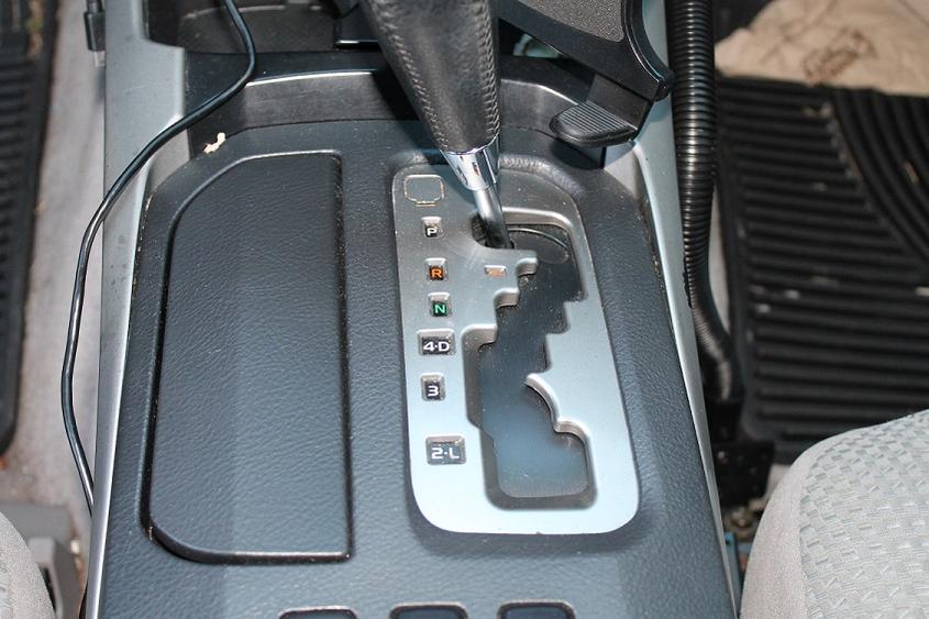

Here are some pics I took this morning.
carfax says it was purchased and registered in GA as a personal vehicle March of 03', with no car dealer mentioned. The next entry is a US Customs declaration that it was shipped here from Germany in Dec. of 03'. There are several entries as being registered in Washington DC after that. PO said it was a military owned vehicle and he himself served as well.

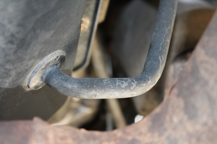

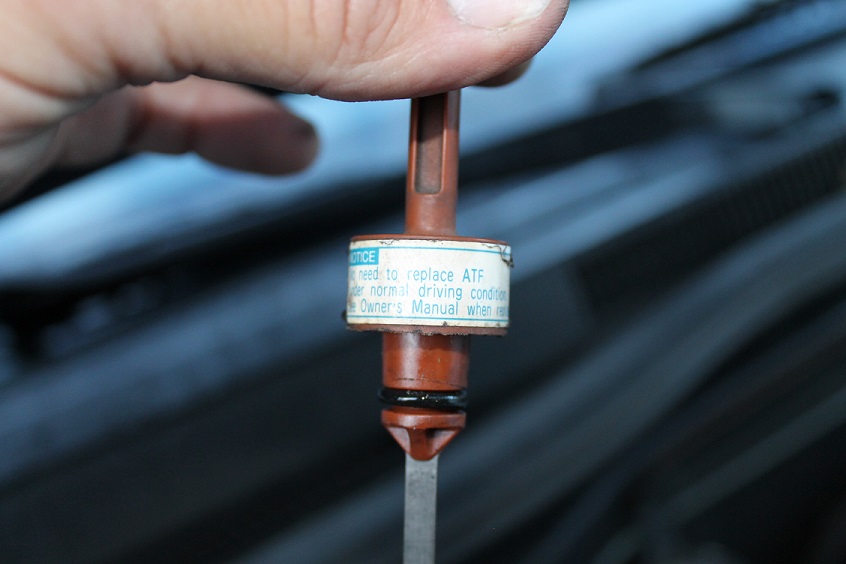

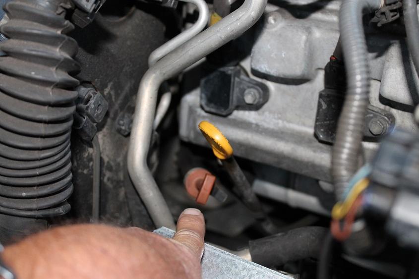

Well now that's extremely interesting, I would love to know more about why your's has the dipstick and it seems that all others 5 speeds transmission don't, does it say on the dipstick what type fluid to use, WS or Type T-IV , and also can use tell if the dipstick goes into the side of the pan or through the body of the transmission?
Sorry forgot about checking that. Just looked, T-IV. Gonna look at the the tube next.

I have an '03 V8 Limited, production date 03/03. 2nd owner, and I know the original owner. It definitely has the 5-speed trans with a dipstick, and I have another friend that bought an '03 V8 shortly after I bought my 1st 4Runner, an "03 V6, and his V8 also had a dipstick. As I recall, it was in the '04 model year that the V8 was switched to the 'sealed' trans.
