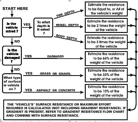

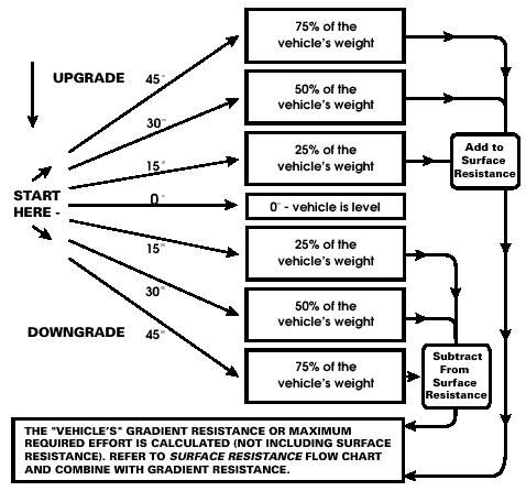

This was instructive: Pirate4x4.Com - Extreme Four Wheel Drive. Posted by Bill Vista. These are his charts showing pulling capacities + ramp angle + surface friction.
Thanks for linking to that, slap. It is a good resource with lots of good info. I have read the whole page before, but it never hurts to re-read it!
