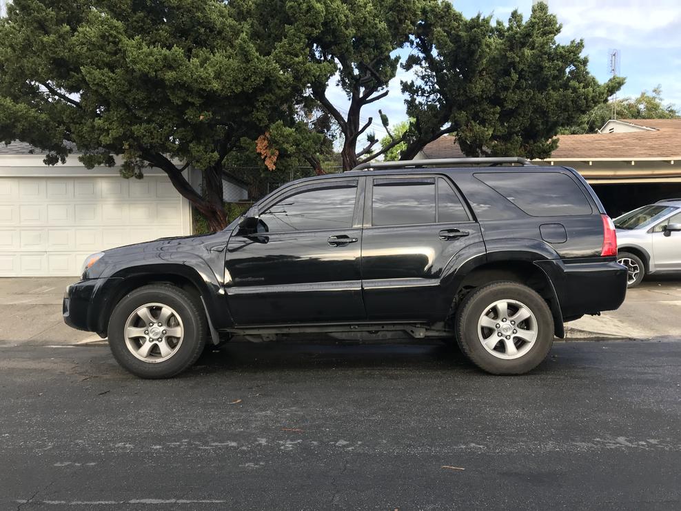

Ride - 07 Sport 2wd
Suspension - 17 4runner TRD pro with 2 inch toy Tec lift
Rims - Scs F5’s 16x8 3.5 backspace
I’m choosing between 285/75/16’s or 255/85/16’s. I’m 90% LA City/highway driving and 10% basic off road, nothing crazy. I know I’m going to lose some MPG’s but trying to retain as much as possible. I’ve read the 255’s are perfect for that but seem to only come in Mud Terrians if I want them light, BFG KM2’s. Anybody running 255/85/16’s with pics would be much appreciated. I’ve been looking for days now. Also, 285/75/16 pics would be great. Which one would provide a better ride and noise? All your opinions will help a ton.
THANKS!
Ronnie
