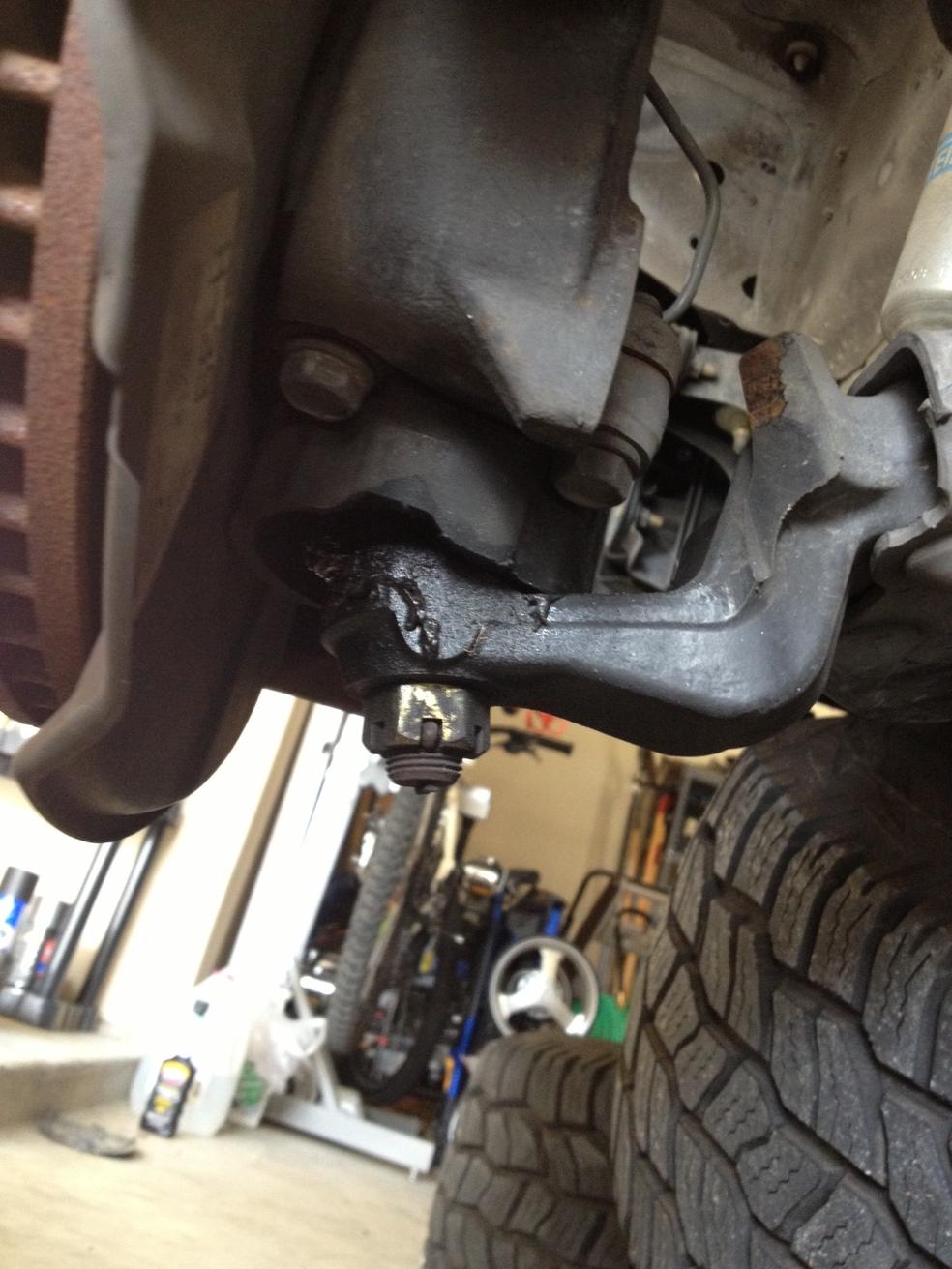

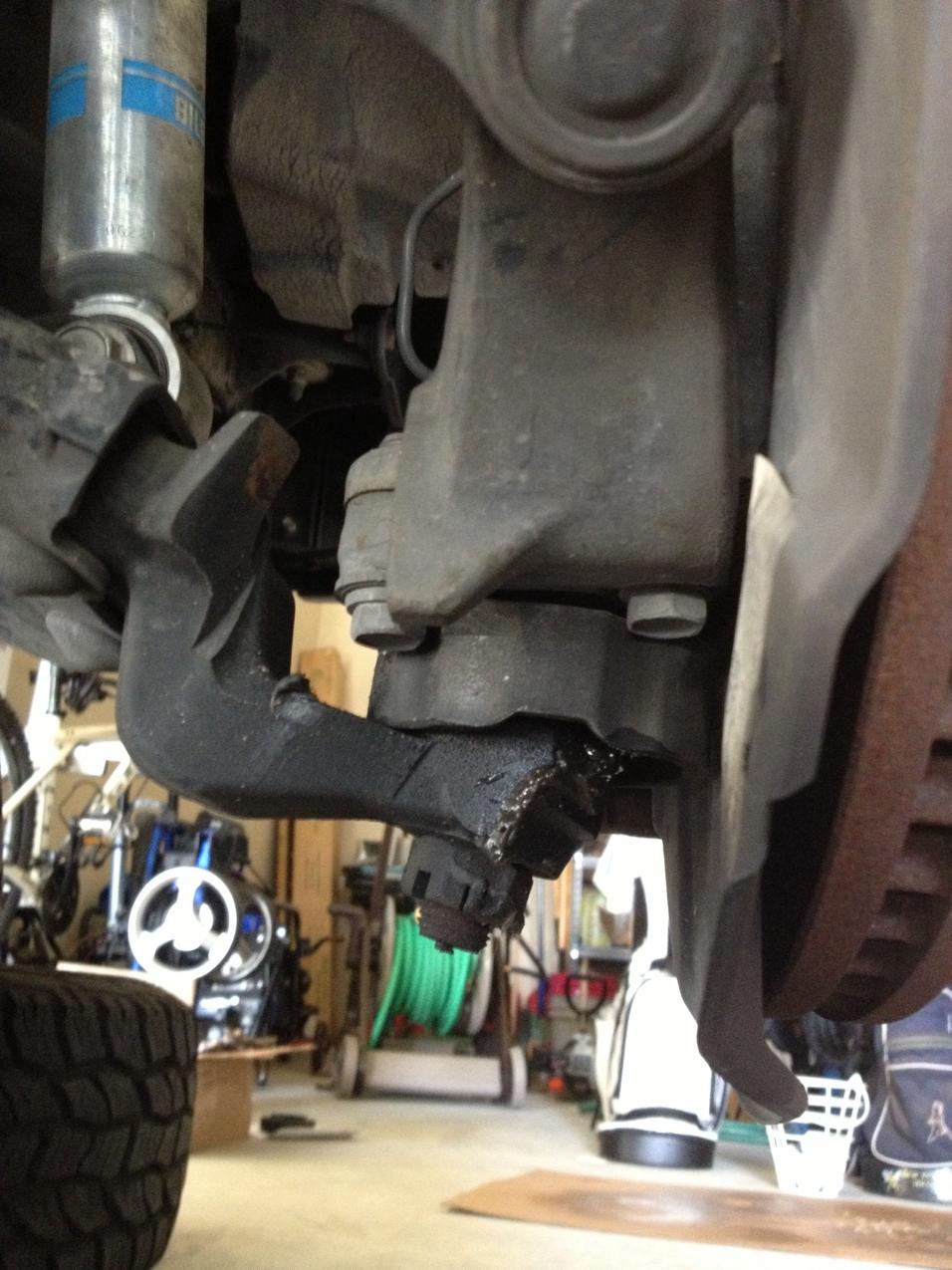

I replaced the front springs this weekend and noticed some grease leaking from where the LCA meets the LBJ. Should I replace these LBJs? They've only got 75K miles - 35K were on the stock 2002 2wd suspension and 30K were on the SS 3.0, so only 10K miles have been lifted above a stock ride. I wouldn't think they'd need replacing just yet.

I'd replace them. Once grease starts coming out, the ball joint will start to deteriorate fast. As far as should you drive your other vehicle? If it was my rig I would. I don't take any chances with LBJ. Did you use OEM?
During a cv replacement this weekend I discovered my LBJ boots were torn and leaking. No telling how long they've been like this. I'm getting replacements at the dealer today and replacing tonight. Given the flurry of threads over the weekend everyone should be checking and/or replacing asap. And use oem parts life is way too valuable to go cheap..

Even with the low mileage the LBJs are partly made of rubber compound and the material breaks down over time. Your are almost 12 years old.
Take them to a Toyota certified mechanic to be inspected or do it yourself.
