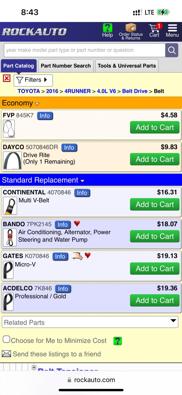

Okay, I am ready to try this on my own, but cannot figure out if OEM is the Bando 7PK2150 or the 7PK2145. I've seen threads here that don't make it clear, but seem to lean toward the 2150, which is also what this video says. That belt is only $20. But when I go to RockAuto or Napa, they all say the 2150 will not fit my 4Runner so now I am confused. I've also seen reviews of the 2150 on Amazon from people saying the belt shredded after 1k or 250 miles. Really want to get into doing some of my own maintenance but worried Im going to put the wrong size belt on and destroy my car, lol. But I definitely don't want to spend $270 that my dealer wants to charge me.

What about reaching out to a Toyota dealership parts department for the information. Or since you have already reached out to their service department ask them for that information. Both should be able to get that information for you. Your receipt will have the part’s and number’s listed so it’s simple for them to see this information before the work is done. The parts department I deal with is usually very good with knowing what parts are correct for a particular job. Just keep your discussion to the bare minimum, just ask for what you’re looking for, because they’ll probably get confused otherwise.

OEM is 90916a2015. Pictures of this part show the text 7PK2150. You may even be able to see the text on your own belt.

Okay thanks. I'm going with the 2150 and will see what happens. Crazy that this BANDO belt is only $7 at Rock Auto. My dealer's price is $88. I got the belt, a belt tool, and two wiper blades for $45 shipped.
Just because Bando is the OE supplier to Toyota does not mean that the belts they sell under their own brand name are the same as the ones they supply to Toyota. Same goes for Denso (and other) OE and aftermarket parts.

Recently replaced mine at 100K km. Super easy to due with just a 14mm socket. I used the 7PK2145 version and no issues (1000 km so far.)

BTW, I just bought a Bando 7PK2150 on amazon because I can see the "7PK2150" printed on the original belt. I'll compare it to the original belt very closely before I install it. I don't want to take any chances with this.
