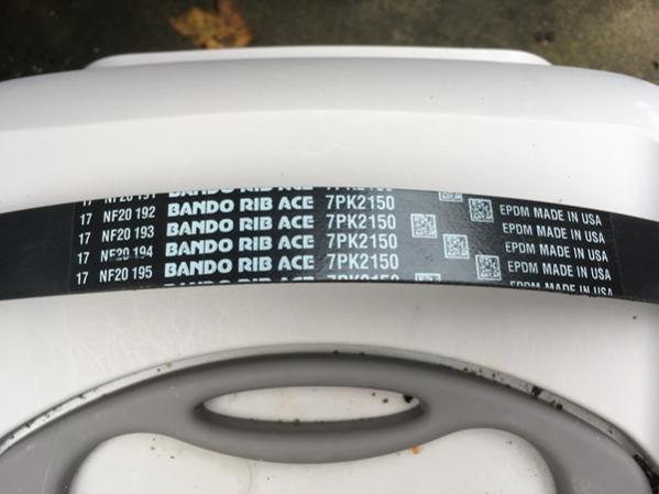

The belt did arrive and looks good but I have not yet installed it or compared it side by side. I can report the new belt has "BANDO RIB ACE" printed on it and so far looks the same as the stock belt. Once I get it installed I will update this thread.

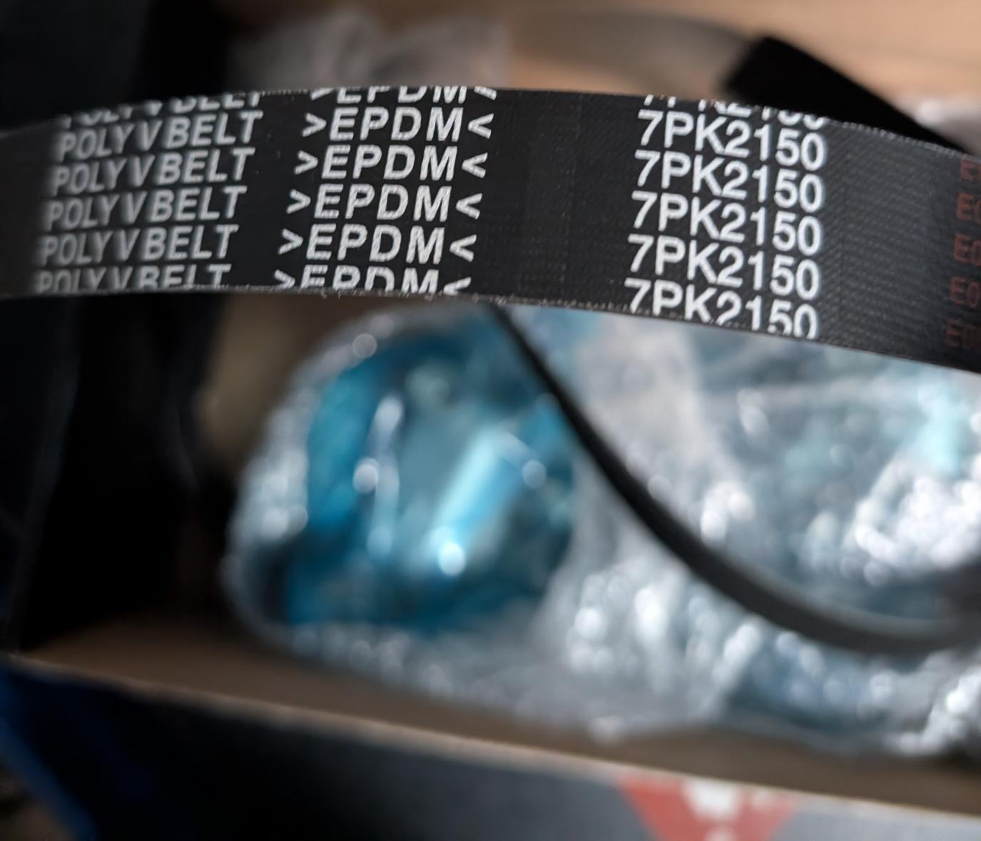

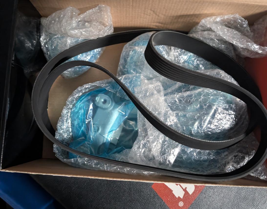

I got these from amazon, idlier pulleys and tensioner as well for $100 cad, everything looks good so far.

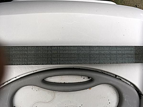

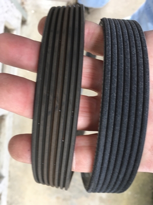

I finally got around to attempting the serpentine belt replacement with the Bando 2150. It did not go so well. I have confirmed the Bando 2150 is the exact same size as the stock belt, but the rib design is different.
The belt on the left is the stock belt which is a Toyota part number 99367-H2150 made by Mitsuboshi (part # 7PK2150) made in Indonesia.
The Bando on the right.
The bottom pic shows the different rib design. The stock belt on the left.
