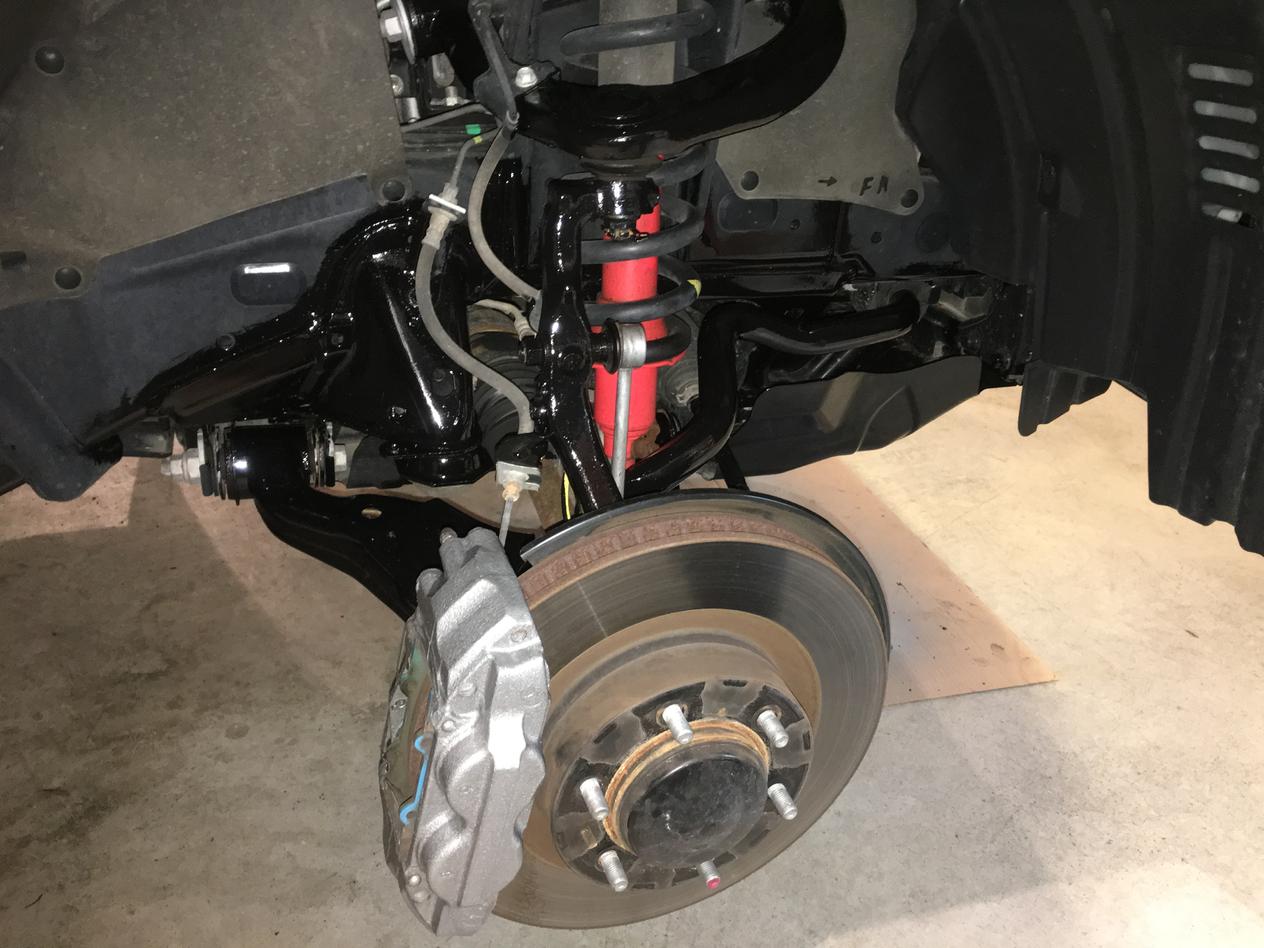

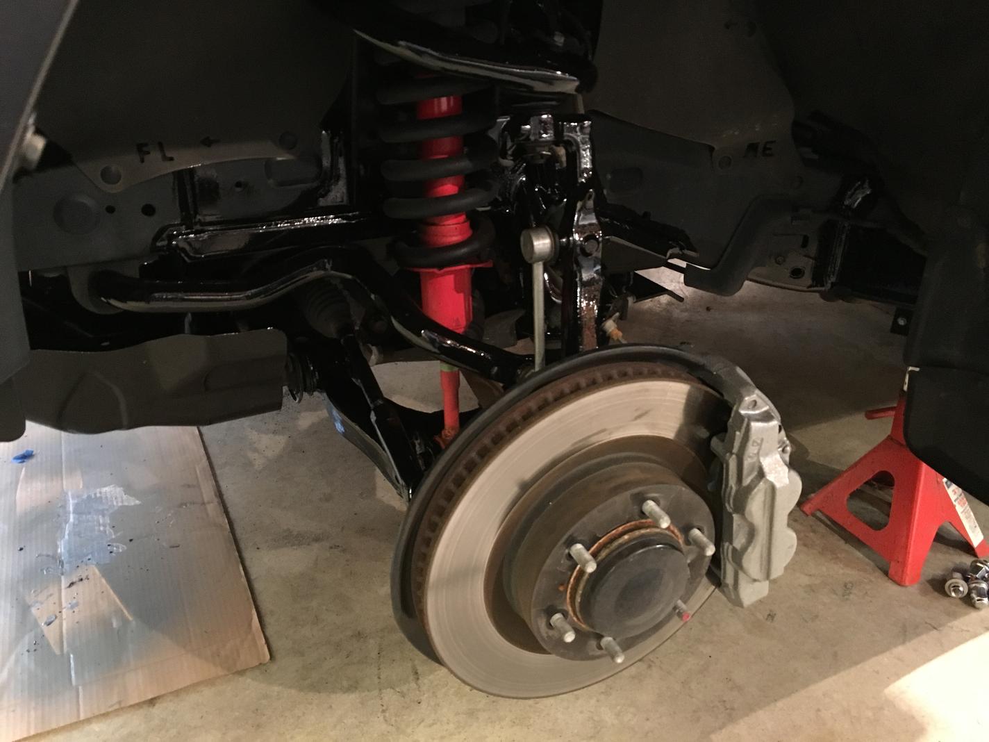

In spring of '15 I acquired a 2010 limited exposed to five years of central & northern Ohio winter driving. Top side is in great shape but underside had some areas of rust forming . For about fifteen years I've been using POR-15 on corroded surfaces or just painting items where I want a permanent coating , it pretty awesome stuff. Last year did most of the rear frame, axle, links, etc. and the front skid plate on the Runner in gloss black. Rear swaybar links were in pretty bad shape so pulled them and coated in grey. Have a little spare time on my hands lately so last week pulled the wheels and did a little detailing, coated calipers with silver ( good to about 450*) and got areas of rear that I missed and front items I wanted to get coated. Will probably touch up a few more areas next week. Search POR-15.com , it's pretty wicked stuff , kind of expensive but if you want to do it once and be done.......
