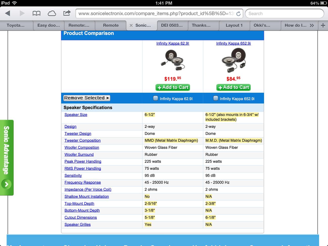

Trying to upgrade my door speakers I want to stay with kappas to match throughout the car. I was recommended to go with:Infinity 6529I 225W (Peak) 165mm Two-Way Speakers....but they are hard to find (in-stock) so think I am going to go with these: Infinity 629I 225W (Peak) Two-Way Speakers (Pair)- 6-1/2 x 6-3/4 -Inch (closet I could find) also putting these in front/rear/tailgate...

Thanks for your input... To be honest until you posted those great pics of your install I really never thought about that much water getting inside the door frame.
I wasn't able to find the kappa 6529i (out of stock) so went with 629i think the only difference is the Top-Mount Depth 2-5/16" vs 2-3/8" that I could tell anyways.

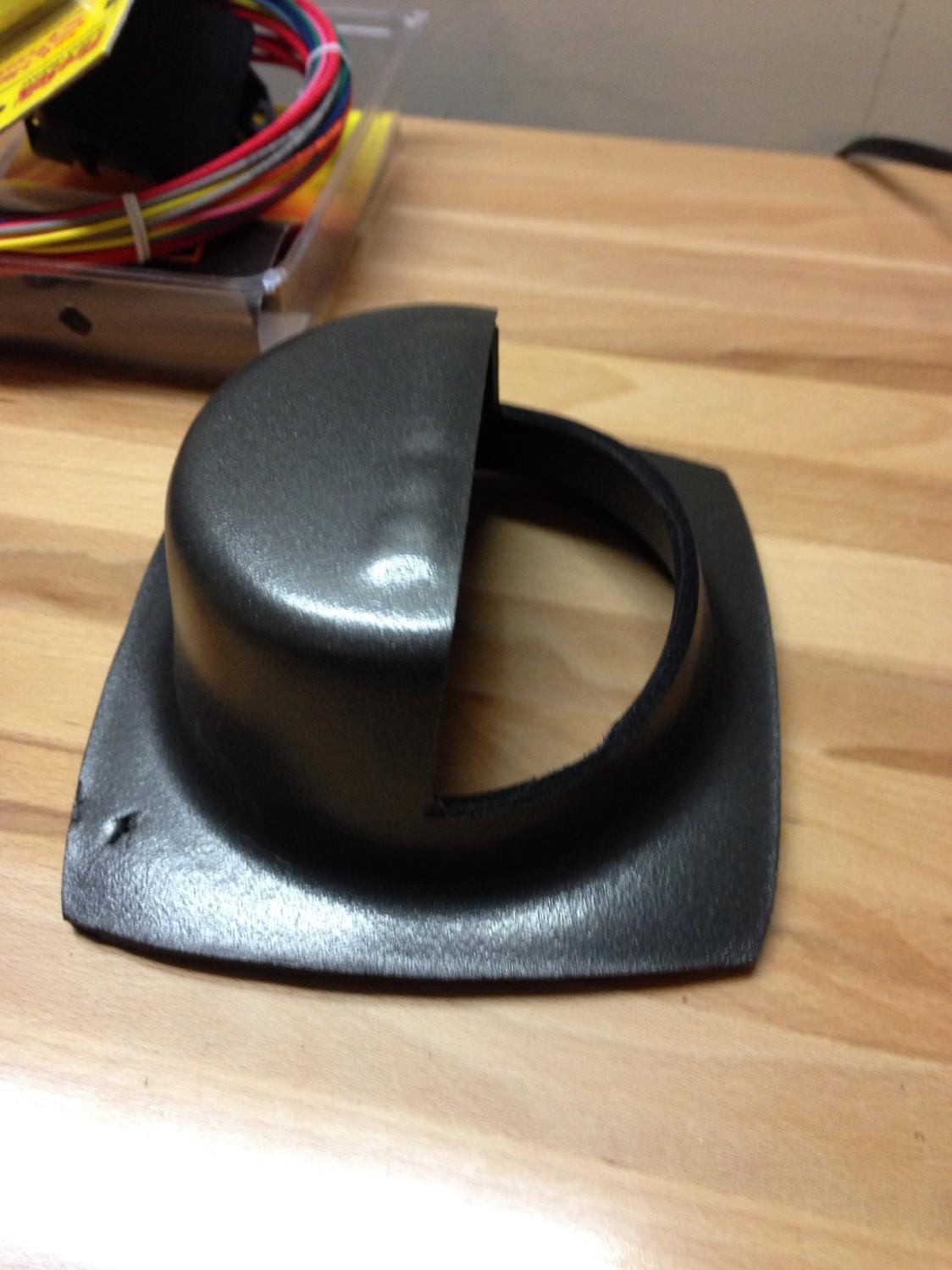

I'm using them but with modifications. First I cut them off so they're just a little deeper than the speakers and then cut off the bottom half just behind the speaker. What I'm left with is a cushion between the speaker and door and a drip guard/umbrella for the speaker inside the door.

To give more info on the Boom Mat, I've heard that they interfere with the sound, that's why I trimmed them into just moisture protection. I haven't heard any vibrations from anything and I don't think it's possible for them to vibrate based on what they're made of (dense foam rubber). This is based on listening to all sorts of music at lots of different volume levels.

Like this? Or should I take off the bottom completely? (((I know nothing of audio install so any help is great)))

Hey, sorry to bump an old thread, but when you cut the back end of the baffle off, what if you went ahead and attached it to the inner door directly behind the speaker in order to help absorb the back wave? Would it work? Some of the backwave dampeners I have seen online often have grooves in them.
Did the same for my doors (modified baffles like those by removing most of the bottom/rear for use as a "speaker umbrella" as GrantK said - lol).
Then used blackhole blocks (forgot the exact brand/model - used like 5x 4"x4"x1" blocks) behind the 9" Morel Elate's in the front doors for additional enclosure (door cavity) damping. Added a few of those blocks to the rear doors, but the rear speakers generally stay faded off to preserve front stage imaging...
