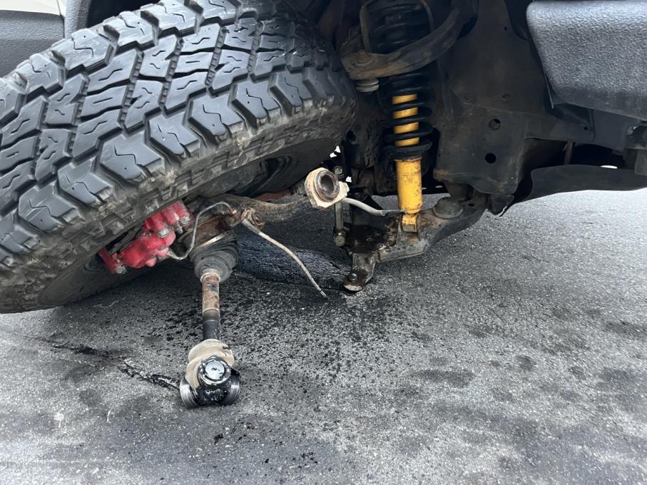

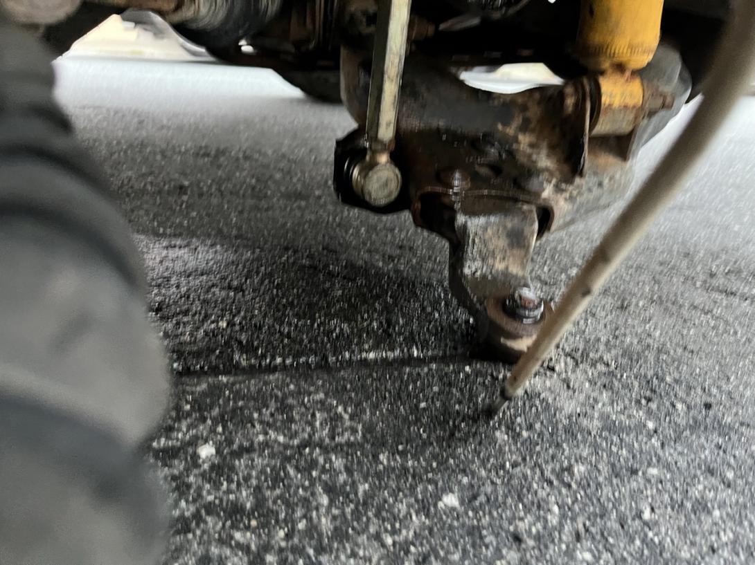

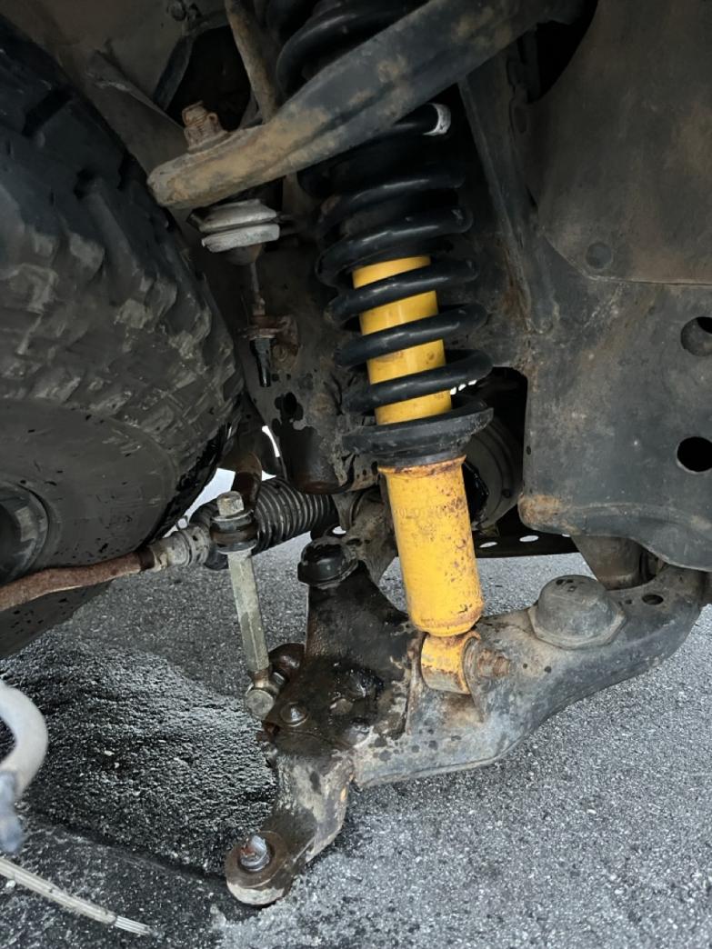

My 265k 97 TR4 likely has original UCA/LCA's and bushings. A local shop recently mentioned there's significant play in them and that I should replace them.
I understand often it's just bushings that need replacement; however last fall my passenger LBJ gave out (thankfully I was just going about 20mph) and I ended driving ~100ft on the passenger LCA itself (see pics) -- so I'm wondering if this is sufficient cause to replace the LCA's vs just doing bushings?
Some more details: when that happened, I got a tow to a local shop who replaced all 4 ball joints, replaced axle, and reconnected brake line. They didn't mention anything about the LCA's at that point, so I assumed they were ok.
Thanks for any insights

If the previous shop was able to align the front after the event without and problems you are probably fine. If an LCA was bent it would cause issues. But I can understand why you’d want to replace the side that got drug on the ground. If it were my truck I would replace it.
Not only should you replace it, but I also see this as an opportunity to UPGRADE if you so desire, although it isn't mandatory. Just my suggestion. I'd just be concerned about the overall integrity of the LCA itself after having driven on it.
This. If its not bent, there's no cracks or play around the rivets and the welds on the seams aren't split then it's fine.

For lowers, I don't have any personal recommendations. All the aftermarket ones I've seen are like heavy duty ones, and expensive. When in doubt, new OEM is never a bad thing, but it's just a good excuse/opportunity to upgrade.
The part that drug on the ground is getting replaced (ball joint) and the forces are in-line with a hard braking event... I don't see a reason why it will need to get replaced proactively. Obviously, a visual inspection would be prudent.
