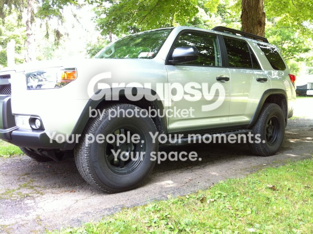

285 70-17 Michelin AT2 on Konig Countersteer X
Fender liners adjusted and mud flaps removed. Fronts rub slightly on body mount at full lock in reverse (why only in reverse? this puzzles me). I'm guessing the rub can be eliminated with caster adjustment, if not I'll chop the body mounts.

I'm sure you have read all kind of posts on tires rubbing at full lock correct? Think for a minute: Where do the tire edges go if I turn the steering wheel all the way to lock? Correct - they go towards the place where the center of the tire is when the wheels are straight except they go further forward and backward because of simple geometry. Right now at full lock with stock sizes the tire edges don't touch anything but they are close to the liner and the mudflap. By putting a spacer on or using a wheel with incorrect offset or backspace what will happen is this:
When wheels are straight the tire will stick out further by the thickness of the spacer. When you turn the wheel to full lock the spacers that widened the stance in the straight position will now move the tire edges much further backwards and forwards, which will cause the rubbing. Taking off a mudflap or moving the inner fender liner forward by a 1/4 inch is not hacking anything up. Body mount chop is a little different story.
