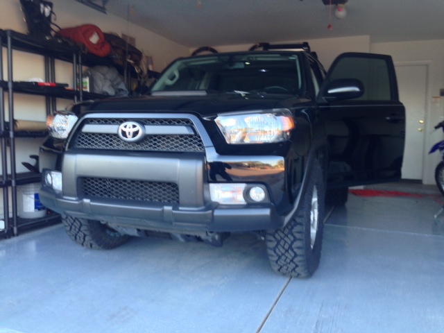

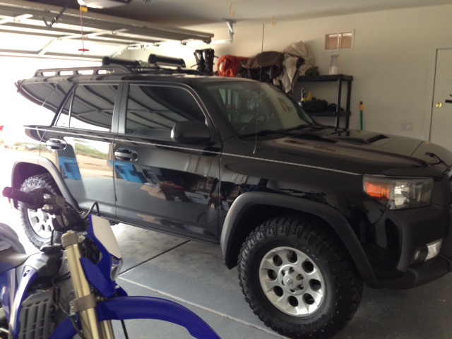

Stock trail edition with 285/70/17 Duratrac's

Thank you , that's what I am getting. And I won't buy my tires from him :)

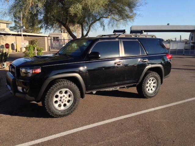

And here we are. I had 285/70/17 Cooper A/TW put on today. I pulled the front fender liners forward and massaged the front mudflaps with a heat gun last night and so far so good. No rubbing while driving around today on pavement or over curbs and speed bumps. I'll have to get out and have some fun with it soon and see if there is any rubbing under compression but it looked pretty good to the naked eye.
