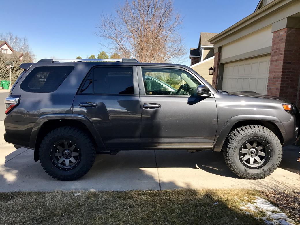

Did a ton of reading here and decided to try and fit 285/70/17 BFG KO2 tires on my 2013 fully stock SR5. Long story short: They fit just fine! No rubbing and no issues so far. Mind you, I don't know how they will behave off-road but I rarely go off road so I am not too concerned.
Tire shop didn't want to put them on stock wheels, but I asked them to try and it worked!
Will get pictures later.

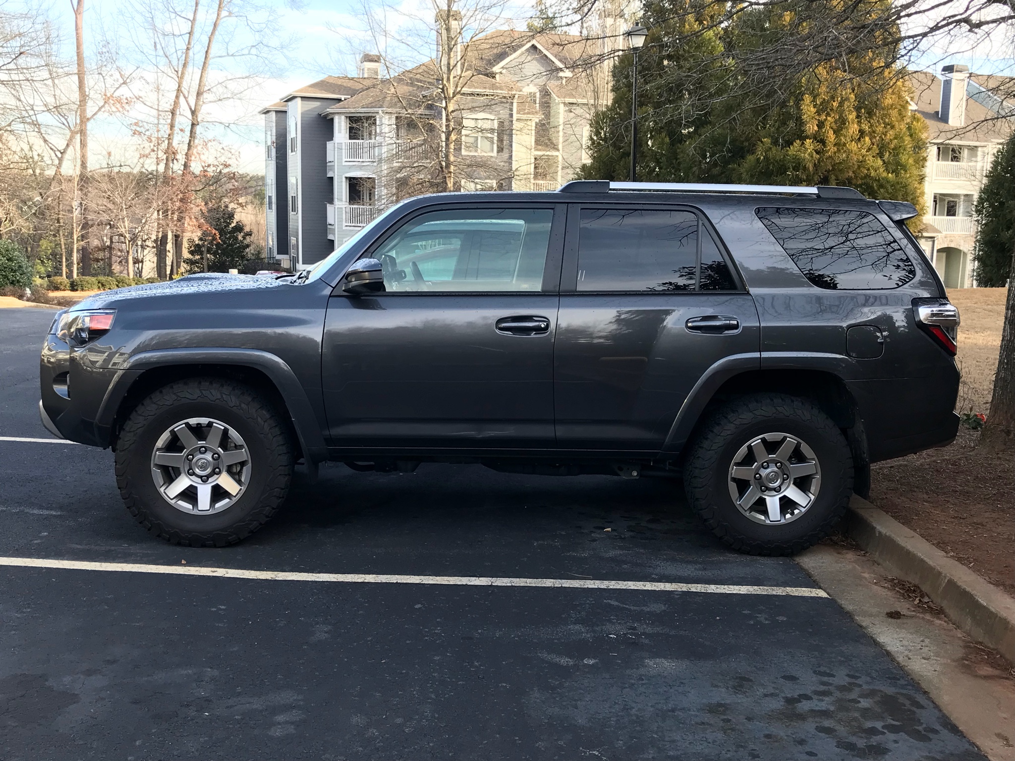

285 Ko2 on stock trail rims and no lift or wheel spacers-----> no rub
285 k02 on stock trail rims and 1 inch wheel spacers and lift ----> rubbed on body mount and front inner fender.
so as someone pointed out, YMMV

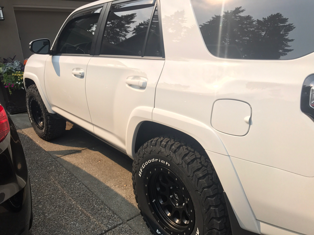

Stock height 2016 Trail Edition KDSS on 285/70/17 KO2s. I made a video on the fender and mud flap modifications I had to do. Does not rub off-road as far as I can tell.
There are some experienced installers in the southeast that didn’t seem to think this could be done. Unsure if an SR5 would have more issues with the different wheel size.
