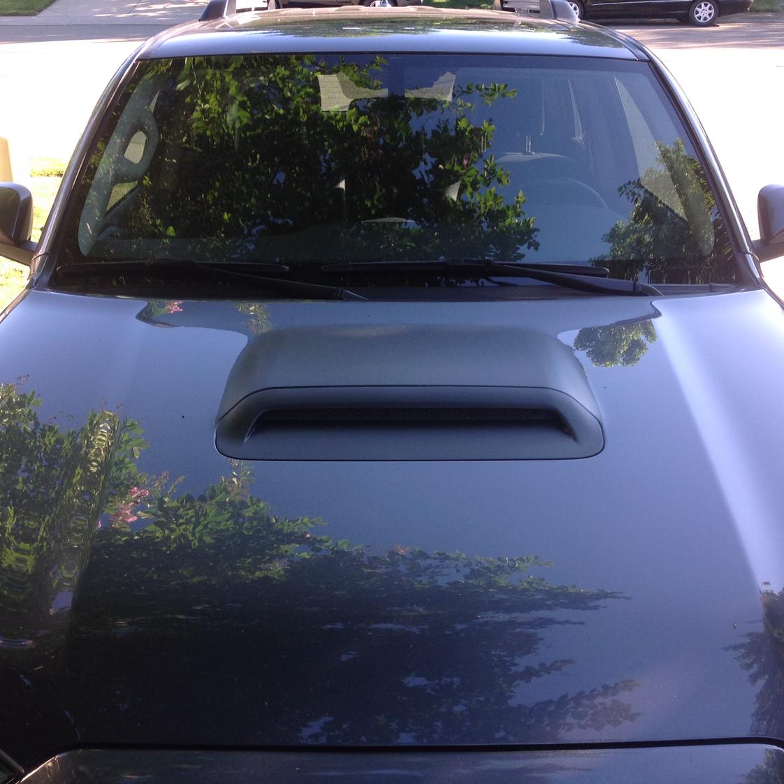

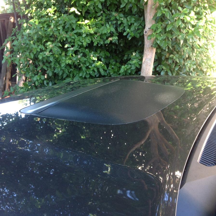

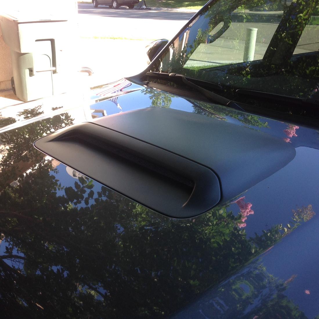

Hey guys and gals,
I made a template the first year I owned the rig, couldn't take the glare.
Pretty easy to do the back half of the scoop, I'm not a professional vinyl guy, but you can find good deals on high quality 3M matte black vinyl on Amazon.
It's one of those projects that "hey what do you have to loose?" A few bucks for vinyl.
The key is to take it slow, watch YouTube videos ect... The new 3M stuff is really amazing to work with and has very small "channels" in the sticky side... This makes it super easy to remove any trapped air. Plus you can peal it back off and reposition it... If you get a wrinkle or crease just hit it with a heat gun and it will return back to its original shape...
Like I said... What do you have to loose...
I'll see if I can find some vinyl install links. I did spend some time in a vinyl shop years ago, but I'm no profession installer. The hardest part was the actual intake. I finally did that about 2 weeks ago, the inside crease is just beyond the limits of the vinyl... But for me, having the vinyl already to do it, I might as well try vs. pay someone.
-A

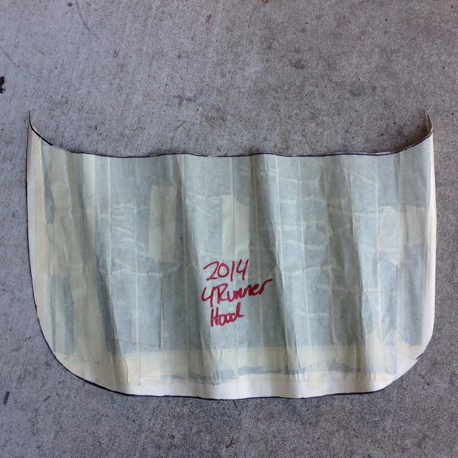

[MENTION=107788]Trail-AMMO[/MENTION] how did you shape your template?
Here are a few more pic's...
To make the template I used masking tape, basically lay it on the hood and sketch the lines. It can be messy and doesn't have to match side to side. Somewhere in the mess will be the "right" line... Peal the tape off the truck and stick it on something, like an old poster.... cut out the basic shape and find the middle of the scoop. now fold that in half over on its self and cut the "best" line you have to make the pattern mirror both sides.
Use the pattern to cut the vinyl.
I've thought about scanning the pattern into auto cad and then getting them cut on a plotter... Wasn't sure if the cost would equal the demand tho.
-A

[MENTION=107788]Trail-AMMO[/MENTION] did you removed the scoop insert during the installation or the vinyl just runs along the edge of the scoop?
when I did the top of the scoop I didn't remove the scoop insert... But later when I wrapped the insert I removed that.
-A

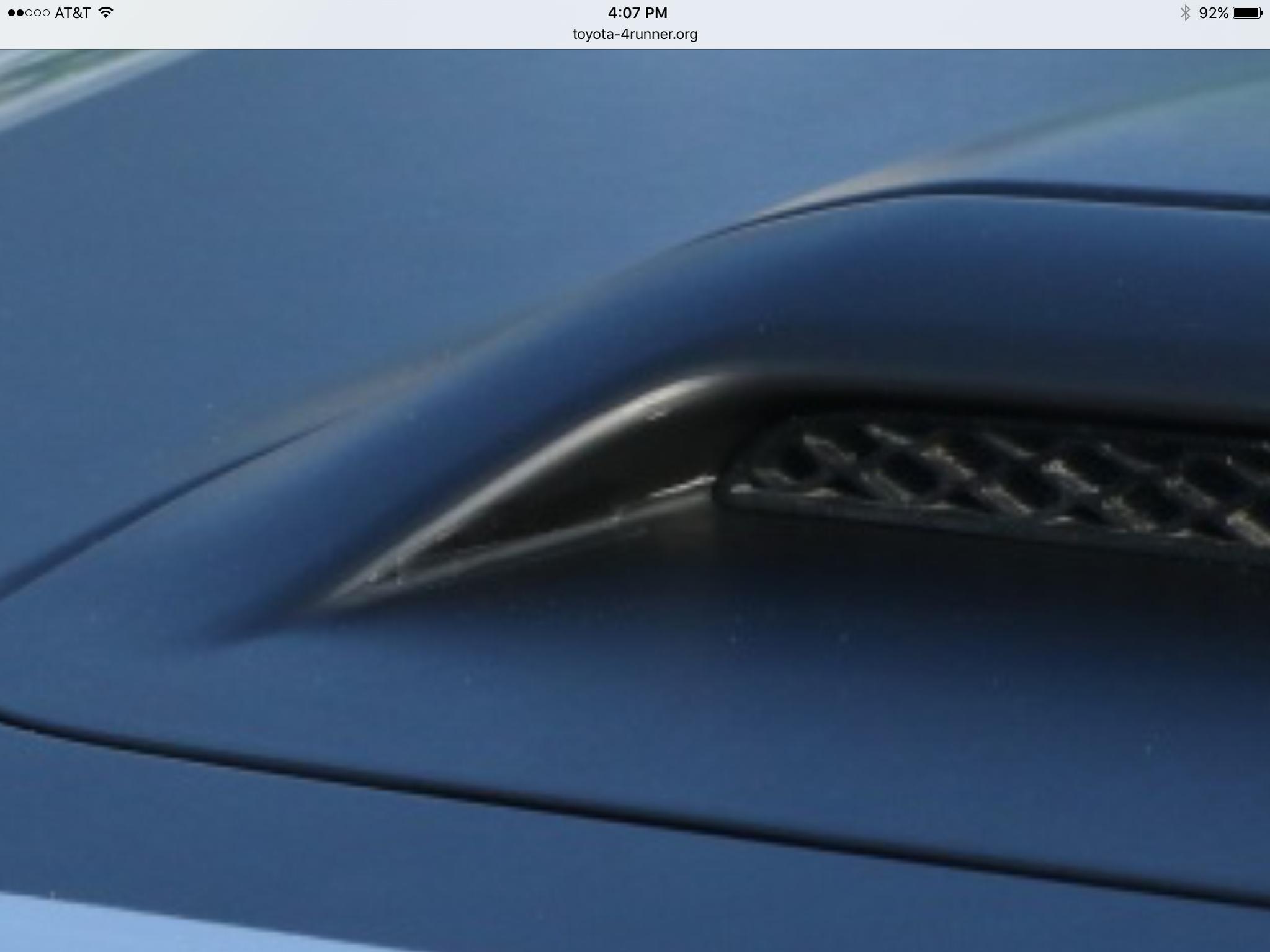

Here is my hood and scoop wrapped by professional since I am not good at these delicate tasks.
The scoop insert was removed for the installation. The vinyl follows the hood lines and goes down to the Protex film without overlapping.

More details and pictures in my Build thread.
In short, they used 3M 1080. They removed the small black plastic insert in the scoop, the applied two parts of material inside on the top and bottom of the scoop hole. Then they applied a single layer for the remain of the scoop.

Yes, they had to put two small pieces inside the hole of the scoop in each corner since the material wasn't sufficient large enough for this area. They are not apparent at all.
Complicated part to wrap he said. I am really glad I didn't try it myself. I would have gone the Plasti-dip way instead.
