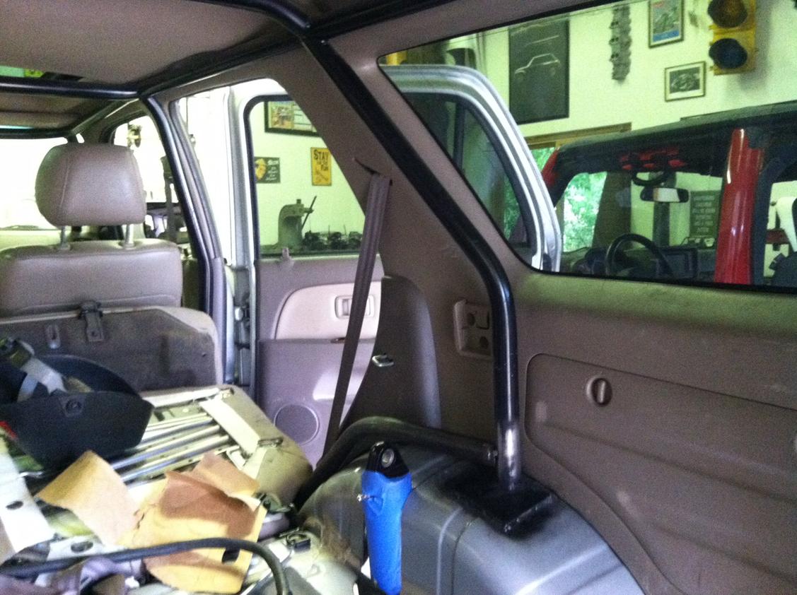

This is what I used. Cut 2" and reweld the plate. Then drill the holes in your floor, and cut slits in your carpet for the bolts. And it's much easier with two sets of hands.
I have a few pics in my build thread too.

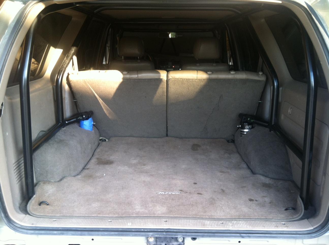

Not the best of pictures but the roll bar is still there.

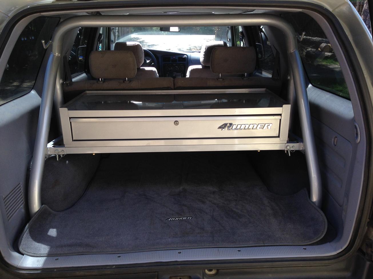

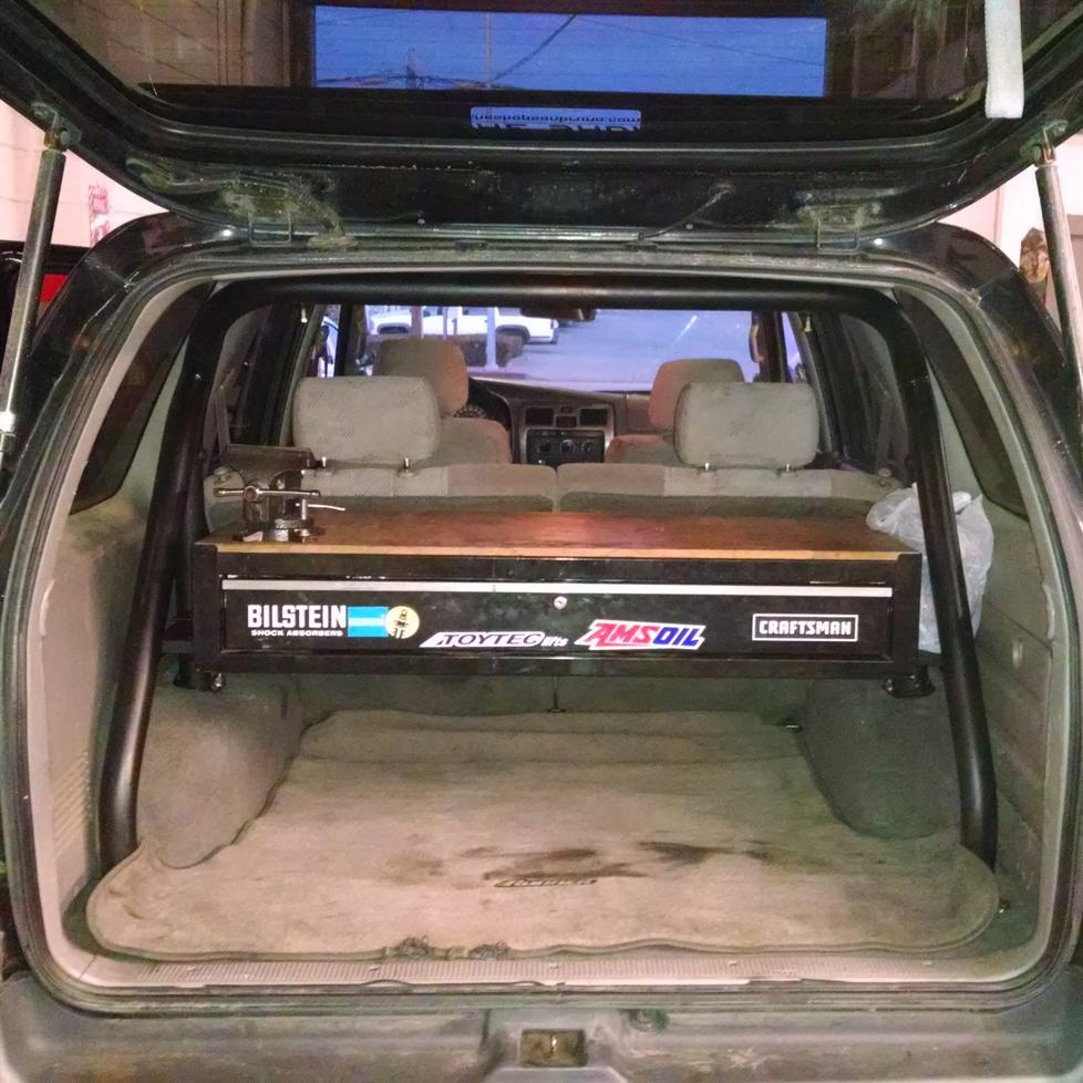

Look at my build thread, and check the one out that I made for [MENTION=81971]Rudy97[/MENTION].
Mine's going to be similar, but the drawer system is going to be removable, incase I need to put the seats down to fit some stuff in.

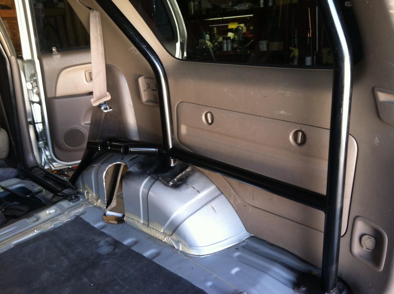

Did mine today... Holy hell, I was shocked at how thin the sheet metal actually was in the wheelwells... Used the biggest plate I could find to spread the load.. Otherwise I love it, will be mounting my fire ext, mag lite and first aid box

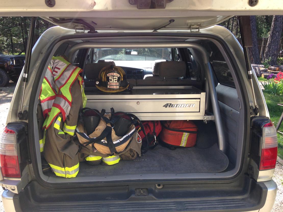

It's been a few years since I installed mine, and I'm still extremely happy with it. I carry a lot of wheeling gear, and it keeps everything organized and easy to get to.
Here is how it looks after a couple years of wheeling, and changing stuff around.
