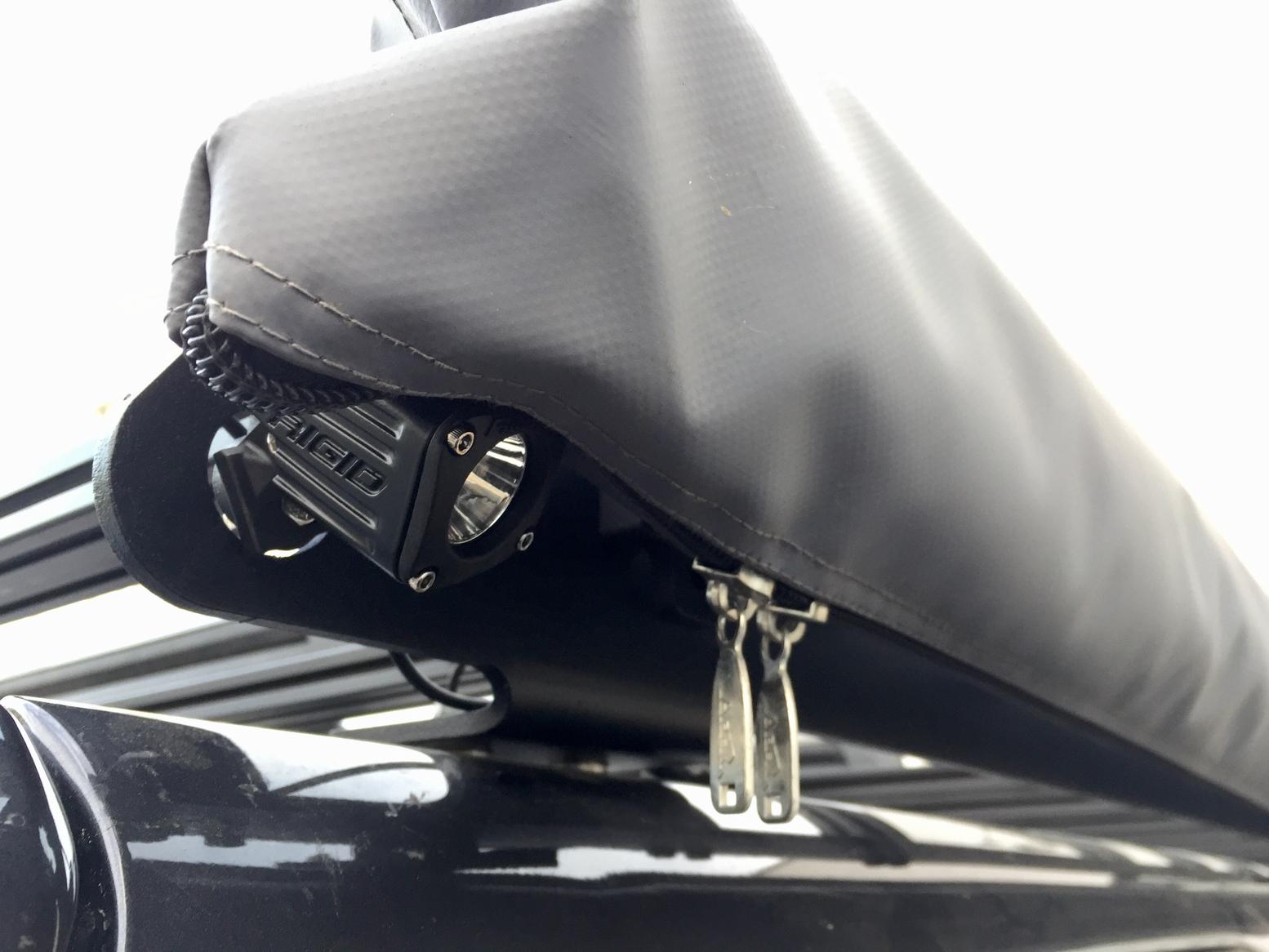

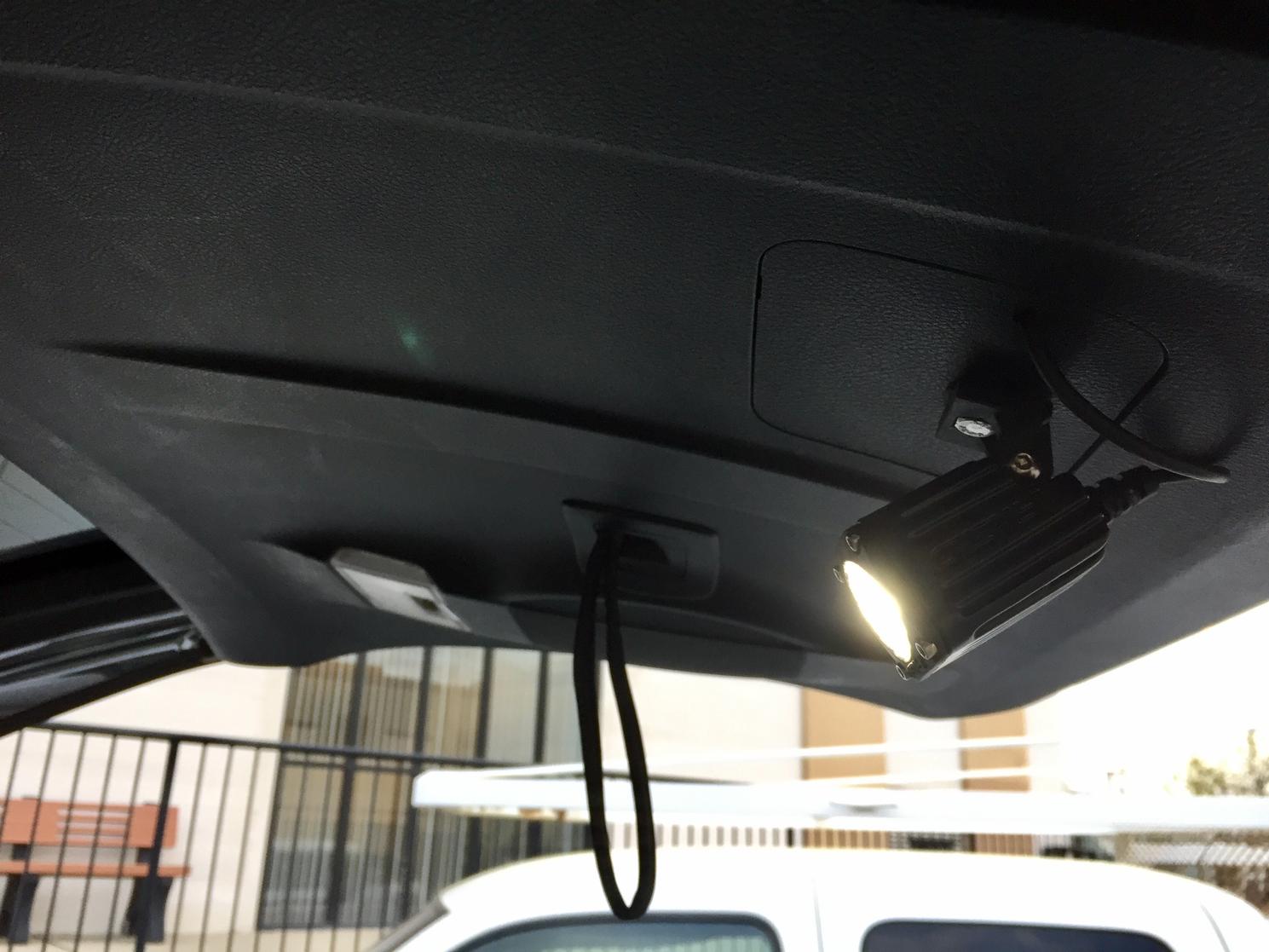

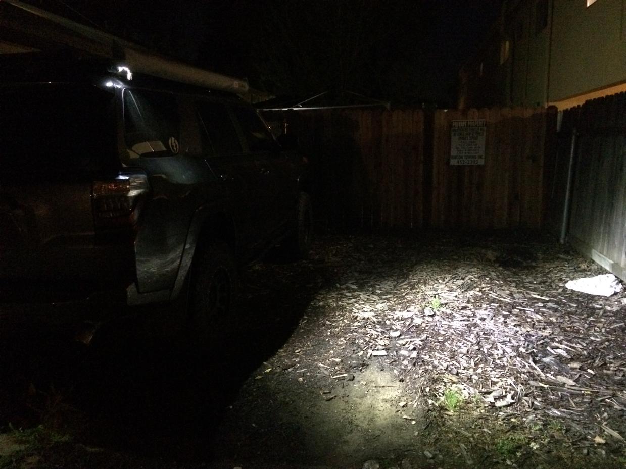

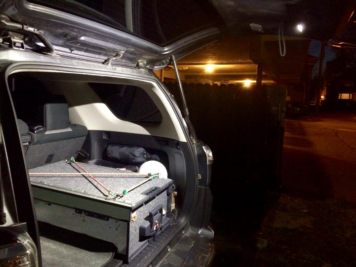

Rigid Ignite camp/cargo lights
Installed a couple Rigid Industries Ignite LEDs for additional camp & cargo lighting. Super impressed with the output for such a small light! The cargo area is WAY brighter now and I can also rotate the light 360-degrees when the hatch is open to use for extra camp/work lighting. Also mounted one under my ARB awning for some camp lighting. I may add a few more of these eventually if I feel the need more lighting.

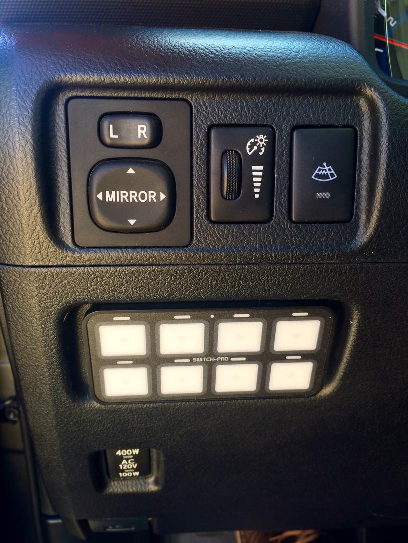

Received my Switchpro unit the other day from the latest group buy and got it all wired up to an aux fuse block.
The switch button panel fits perfectly in the OEM switch blank location... I relocated the wiper defroster to the upper blank (it's flipped upside down because it will not fit normally due to the "keyed" blanks).

SwitchPro says on their website that the SP8100 control panel is
  • 4”L x 2”W x .5”H (excluding tabs)
I thought I measured that it wouldn't fit in that spot. What are you measuring as the dimensions for the control panel switch?
Those dimensions are correct. I think the OEM switch location is about 5"L which is just about a perfect fit. I bought the concealed mount style panel and used (2) #6 x 1.5" machine bolts & nuts instead of the supplied all-thread hardware. No modification to the factory dash/cutouts required.

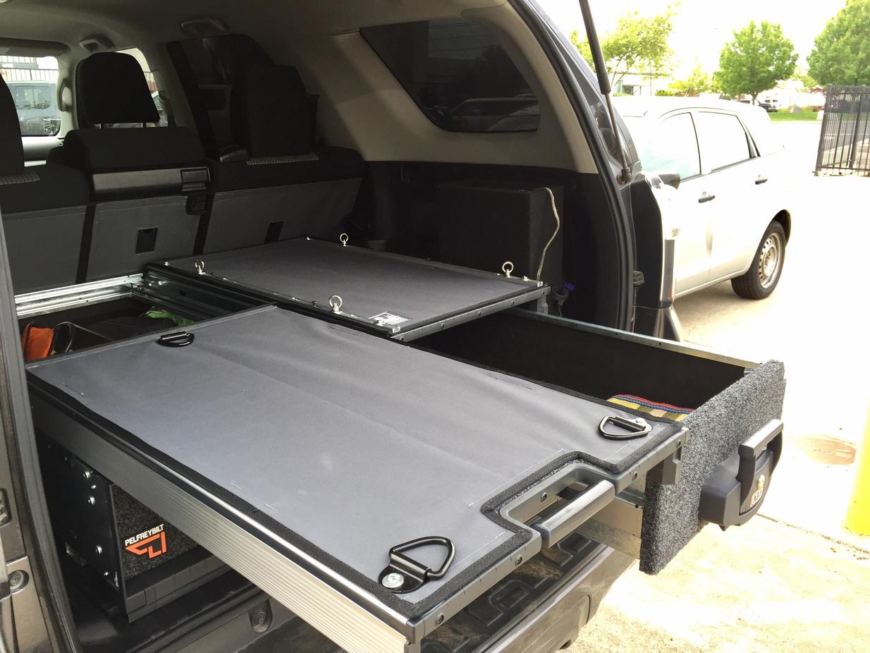

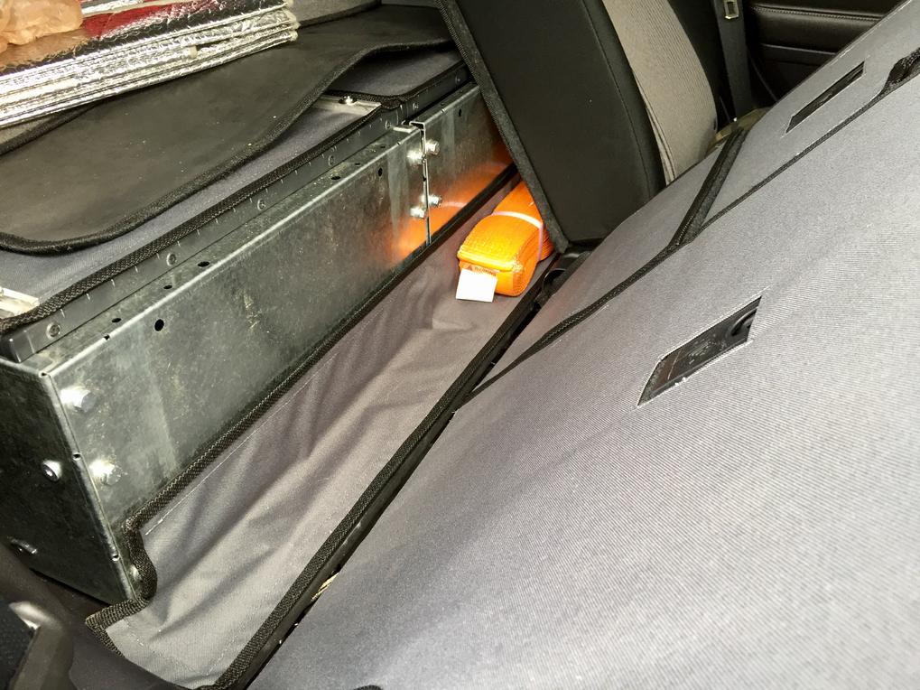

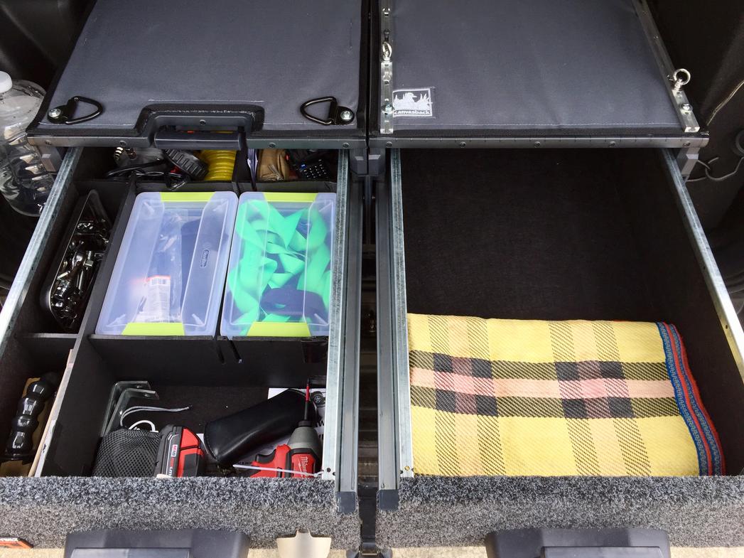

4/21/17- Installed 2nd ARB drawer & Canvasback Seatback/cargo liners:
Well, i didn't wait nearly as long as I had originally planned before adding a 2nd ARB Outback drawer. Thanks to the latest ARB Drawer group buy, i couldn't pass this up!
I also called Canvasback and had them make some custom cargo liners for the ARB drawers. They fit perfectly and use velcro to attach to the drawer tops. I also had them make a little canvas strip to go behind the drawers.
My next project will be building a sleeping platform attachment to bolt the back of the drawers. Hopefully ARB will make a side floor kit specifically fit for 5th gens, otherwise I will eventually make some side panels out of wood & carpet.

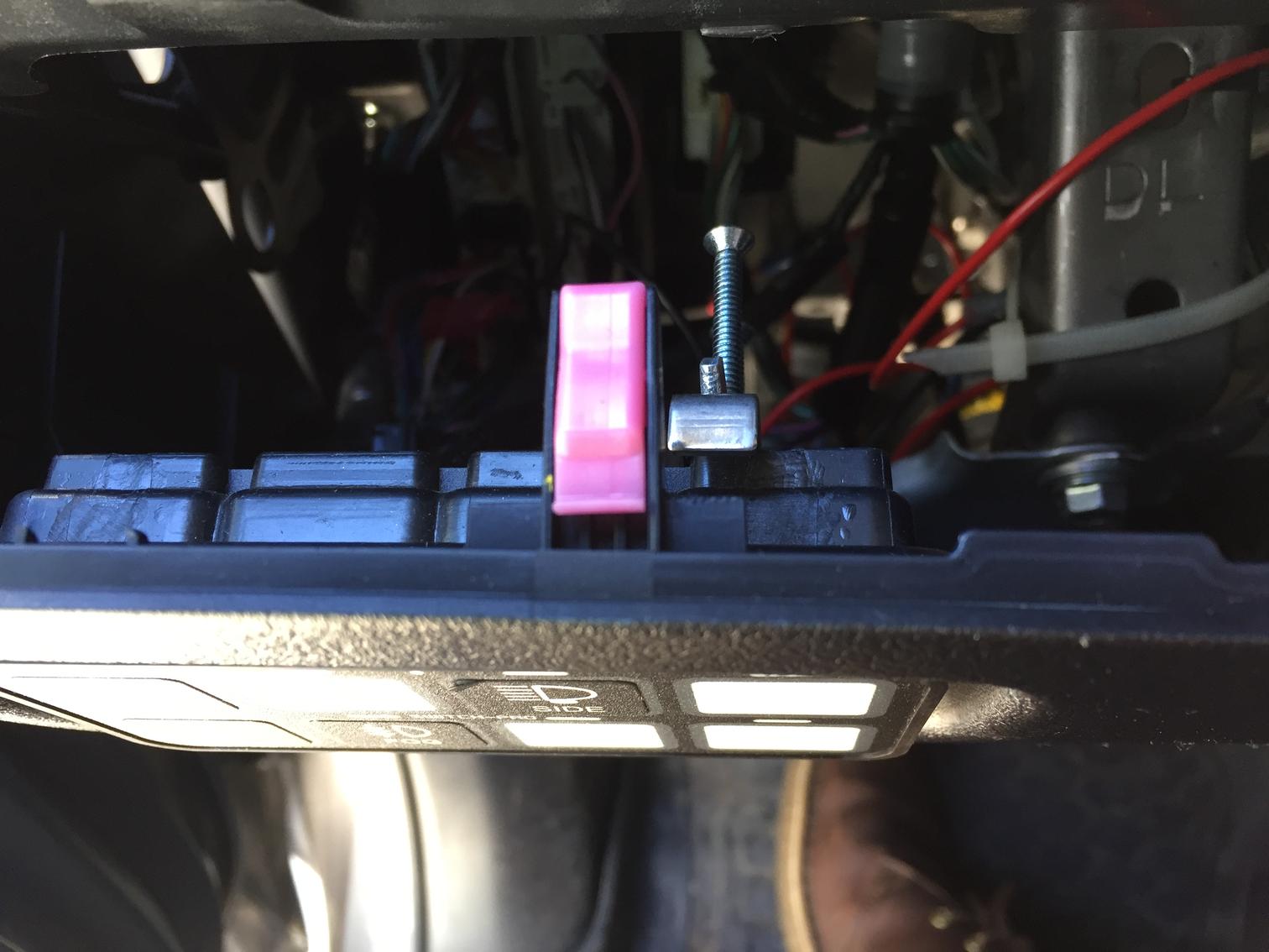

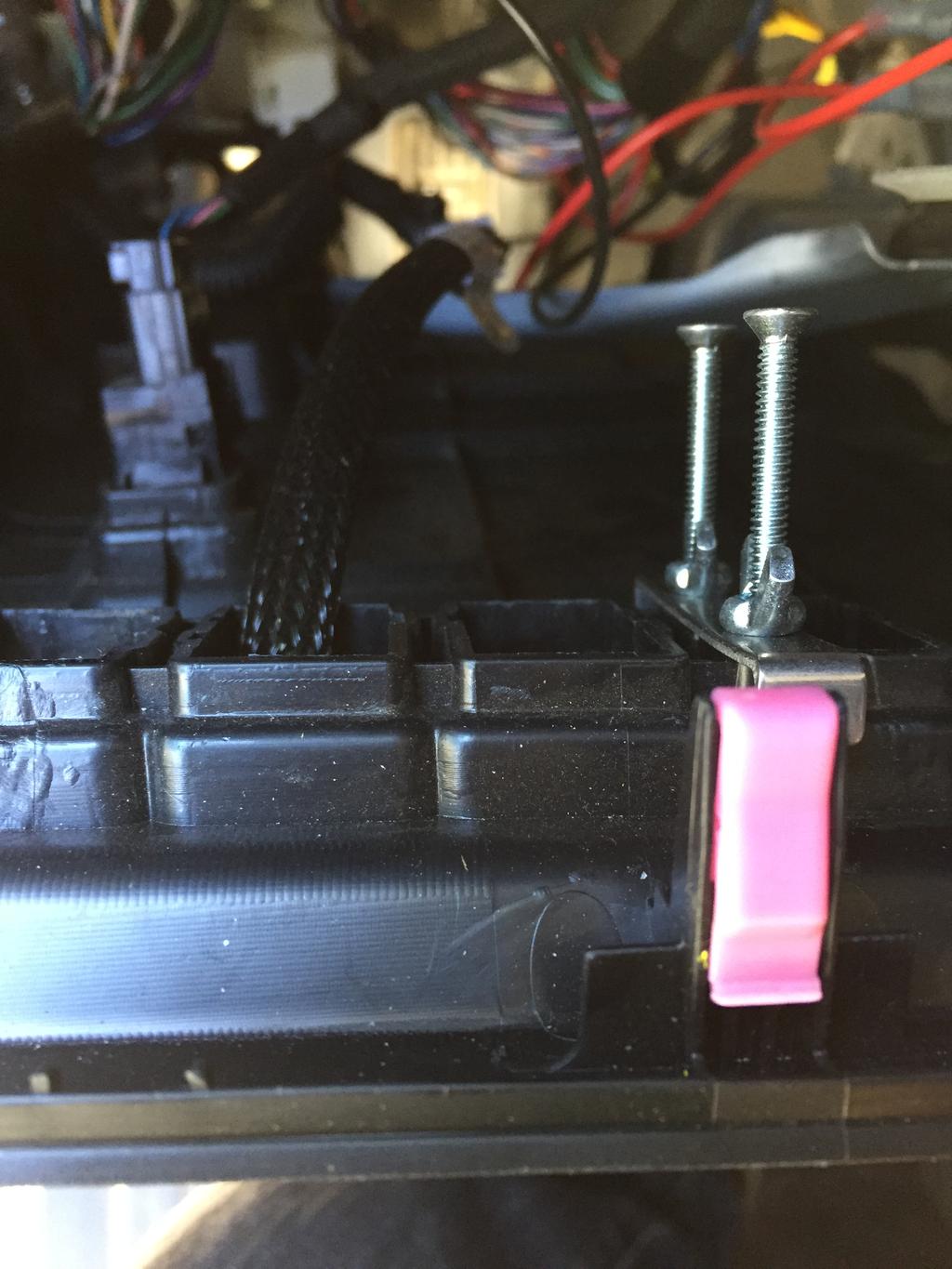

Do you have any pictures of how you attached the panel? I have my dash broken down and tried the 1.5" bolts and threaded them into the back of the switchpro panel but its not snug against the dash.
I'll snap a pic for you this afternoon.
I used wing-nuts (threaded onto 1.5"L bolts) to clamp the brackets snug against the backside of the OEM panel blanks... it's hard to explain but simple once you see a picture.
Here is how i mounted my control panel... hope this gives you a better idea!
I only could use 1 of the concealed mounting brackets because the other side didn't line up right with the switch cutouts and i did not want to drill a hole in the plastic for the other bracket, so I just tightened down the one side. So far it has been perfect and does not wiggle or come loose at all.
I think i used 2 or 3"L bolts since I wasn't sure how long i needed the bolts to be, but 1.5" L bolts would be perfect.
