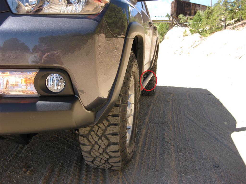

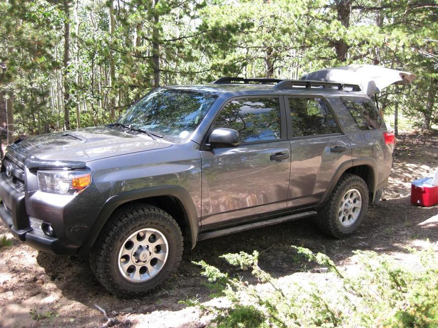

Installation was straight forward. My only hiccup was not having as many threaded holes in my frame (which Jim alerts to in the instructions) as anticipated. There is an option to drill extra holes up front which I have not yet done, so these are attached with 6 bolts on each side.
As others have pointed out, they sit perfectly parallel to the line of the tires, meaning if you look straight down they appear deeper towards the rear as the body curves in. They look awesome and could not be stronger, and are very functional as steps. After picking up two paint chips from a door ding on my 3rd day of ownership, I only wish Jim offered a telescoping version that extend out another 12" when I park the truck. Two thumbs way up on these rock rails :thumb3: :thumb3:

Did you get the semi-gloss powder coat finish or the textured black powder coat finish (satin/flat)? Two supports or three? Thanks!!!
3 supports. Jim at SW told me the semi-gloss is thicker and more durable, so it was my choice. Had I not been told that I would have tried the textured.
Thanks for the info! In person, does the semi-gloss look alright alongside all of the matte black plastic and tires on the truck or does it stand out?

I was going to go for the wrinkled set too but decided on the semi-gloss - I had the same concerns as you at first but now that they are on you can't even tell. I also decided that that semi-gloss would be easier to touch up if they were to ever get any scratches :biggrin2:

Sorry I missed this question. As someone else already added the match is super. Don't stand out at all IMO.

Nice rig and color. I'm liking the sliders though and will get a pair for sure but it will be a step sliders, will be flat and no angle. Can you please provide pics of the sliders as if you are sitting on driver's seat looking down so it will give an idea how far round tube sticks out? Thanks.

If you google 'shrockworks' you'll find their website - Bumpers, Rock Sliders, Rocker Protection, Skid Plates, ShrockWorks - then just click Toyota and 5th Gen. They've got about 8 photos on the 4Runner from most angles, including above, in line with the body.
Yeah, I saw those pics but would like from the OP to provide a closer pics and clearer pics as if he/she is sitting down on driver's seat getting ready to step out of the truck. What I'm trying to calculate is the distance/gap from the edge of the round tube to the edge of the square tube. I know the website said 4 1/2 distance on a 30 degree angle but if layed out flat, would it look a lot wider? I'm planning to put a diamond plate as a step board, that is why I'm trying to figure how far will it stick out:D.
