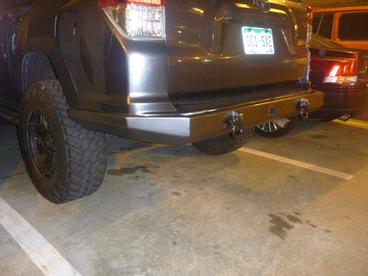

Shrockworks Modular Rear Bumper/Tire Carrier

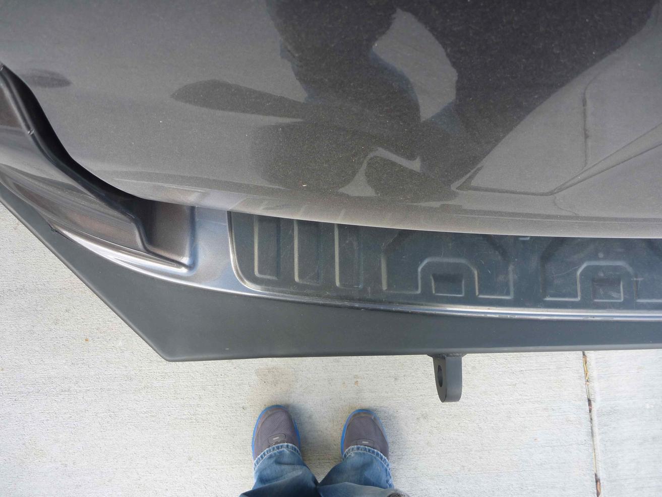

This is worthless, besides looking "cool". It dos not address the lowest part of the bumper, directly behind the rear tire since it leaves the stock bumper in place.
1. If you go over a large rock, that is the first area that hits and the rock pushes the bumper out, pushing the bumper holders out of place. It is an easy fix with the hand to put it back in place.
2. If you go up or over a significant drop, your trailer hitch will hit and absorb the impact, so no added benefit there with the bumper. If it does hit, it pushes back into place easily. And how often do you rock crawl on obstacles that big?
3. We already have a rear tow hook, so again no benefit with shackle holders since I can place a shackle on the existing tow hook.
4. With the tire underneath, it's still not the lowest area and vulnerable.
5. How likely am I to carry extra gas? Not very considering I get 360 miles to a tank. Extra water goes inside or on the roof rack.
Missed the mark if you ask me.
Where does it leave the stock bumper in place????
The shackles on both sides of the bumper are easier to reach and use than one underneath the existing bumper, especially during a complicated extraction.
Having the tire mounted out back makes for easier access to your spare, while also protecting it and freeing up room for other items underneath (air compressor...).
You may not need extra gas, but in reality, 360 miles is not a lot, and if you are in 4wd, esp. 4wd lo, your mileage will drop. For those taking extended off road trips, extra gas is a necessity.
not trying to argue with you, but this may not be for you, but it could be for someone else.

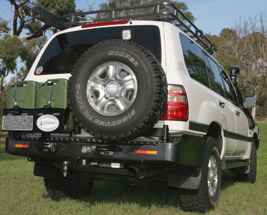

These guys are an Australian company (Kaymar) who make great bumpers too. Sadly there is no 4-runner like the 2010 in Australia therefore they don’t make a bumper for our model. Though I think they have it down as far as what I’m looking for in a bumper. Just some thoughts.
Thanks for your time!
MeBe4running
The only reason I would get a rear bumper is to have a better departure angle then the stock rear bumper. To me that's the most important aspect. Not knocking what they have made, just voicing my opinion.
It does look nice
I like the Kaymar design as well. Better departure angle is indeed desirable, but I suspect there are some limitations to accomplishing that and yet still making it a bolt-on replacement. I think that moving the spare tire to the rear is the most important consideration. Since I did my lift and increased my tire size, the spare for what I am now running will not fit in the standard underbody position. Even if it would, I wouldn't want it to be there since that is only going to subject the spare to damage. As I was saying before, you will not be able to make everybody happy; however you would probably make the most sales by keeping it modular with various configurations and options.

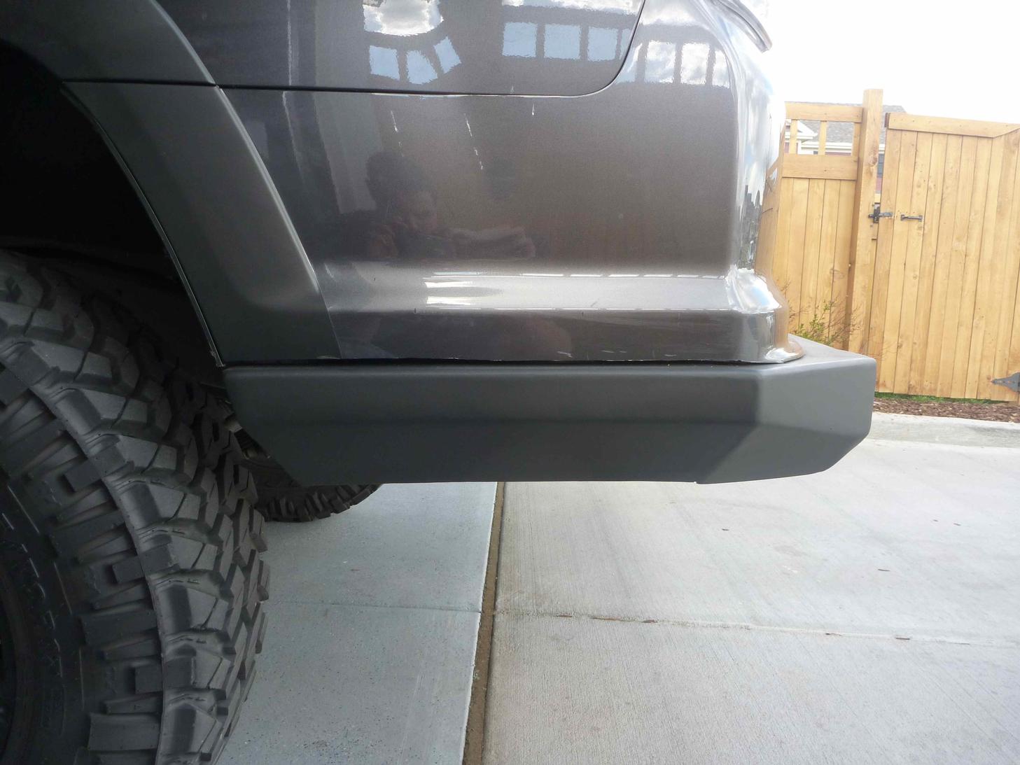

If you look at the picture is post 23, you can see the white bumper still exists as the lowest part, as well as above the aftermarket bumper. If should have a slight gap like you have with a front bumper to account for flex.
Your points for the most part are unrealistic.
- How often have you had a "complicated" extraction where you have needed more than one pull point? And at that, when have you needed to leverage 2 pull points? Sure if you have a 6inch lift, tires and do a lot of rock crawling you can get in those situtations. To me, thats not the justifier in a rear bumper
- The air compressor fits under the hood. You could put a CO2 tank back there, which is still as vulnerble as the spare tire and more deadly than a spare tire it was to hit. You could put a water tank under there, but then you have the weight of water sloshing around when the tank is not topped off.
- I can't remember ever tearing my spare tire up underneath. Agree, a justifier if you run a large tire and need space for the spare. But then again, you could also use the roof.
I think budbuilts and BFLANs look 100x better since they look better, serve the purpose by providing both protection AND increasing the departure angle. CBI builds nice ones for the 3rd and 4th gens as well. They have expressed interest before in building one for the 5th gen, but they are in Idaho...
