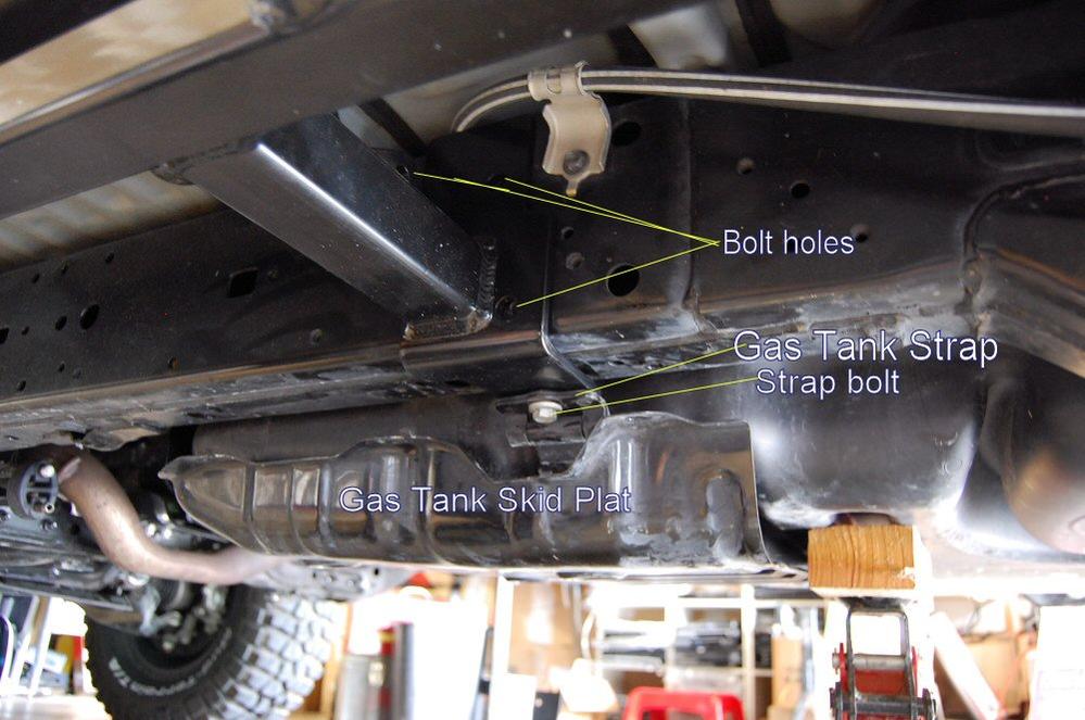

You will get a separate e-mail with generic 4th Gen instructions from Shrockworks.
You will need a 12,13 and 14mm wrench/socket and a floor jack or couple of friends with 3 arms each to lift it into place.
For your TE, unless your gas tank is almost completely empty you will need to remove the gas tank skid so you can support the gas tank.If your gas tank is almost empty just take out the 12mm outboard tank skid bolts and work with that side hanging down like you see in the pic.
The reason is, the drivers side rear slider leg goes under the front outboard gas tank strap. If you take out that bolt the weight of the gas will start to drop the tank down in the front and stress the rear gas tank strap and the tank ,if you know what I mean.
See in my pics how I supported it with a block of wood. I started to take that strap bolt out and I could see and hear the gas tank straining. Of course I hade over 3/4 tank of gas and 17+gallons of gas is heavy.
Line up front leg of slider with the frame crossmember and other then that pretty straight forward ,line up bolts/washers with holes and nuts already in the frame.Just a word of caution is these sliders are very thick walled tubing/brackets and are very heavy.
Here is a pic and link with pics to show what I'm talking about.
Drivers side pic.http://www.toyota-4runner.org/5th-g...-mod-see-if-you-even-notice-7.html#post565210

After looking at HARPER7's picture and comparing it to my TE (with KDSS) I'm a bit concerned.... It seems that the KDSS system is mounted on the outside of the drivers side frame. HARPER7's frame is completely clear. I'm concerned that the shrockwork mounting points may interfer with the KDSS...
Any idea if Shrockworks considered the KDSS system?

No worries,...... They took that into account and designed for it. Remember ,these are made for TE's and one with KDSS was used as the tester and is pictured on their website.
You can see the bolt holes in that pic where your KDSS reservoir bolts to the frame.
