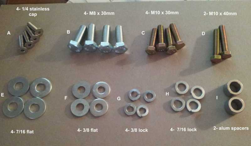

Got my engine skid yesterday but the bolts don't seem right. Below is the email I sent Shrockworks for clarifiction but I thought I'd ask here for help.
Attached is a pic of the parts. They don't fully match up with your instruction sheet. Perhaps this is because the kit is also for the FJ.
From your instructions:
1. Front needs 2-M8 and 2-M10. Which M8, anodized or not? B or C in my pic? Looks like the anodized, since you're noting the smaller washer. Are the M8's on the inside or outside? The M10 you specify uses the larger washers. That doesn't sound right.
2. Rear needs 2-M8 40mm. I don't have any.
3. Middle needs 2-M10. I used them in step 1, I have no more.
If you an refer to the letters in my pic to designate what goes where that would be helpful. Still, some bolts seem to be missing.

Will be interesting to see how they reply. I put the full set of skids on a couple months ago and had hardware issues (both missing and extra) but don't recall the specifics for the engine skid as I did the full set.
I found the aluminum spacers to be too long so replaced them with a stack of washers.
