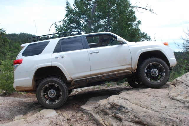

Shrockworks on an SR5. Rocker panels removed...it will work until I can get a bumper on it to hide what's missing. Just go get it dirty and no one will notice. :driving:

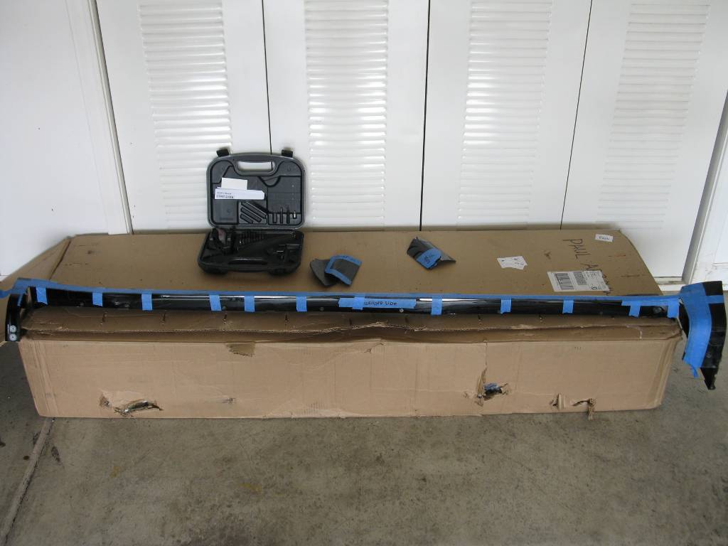

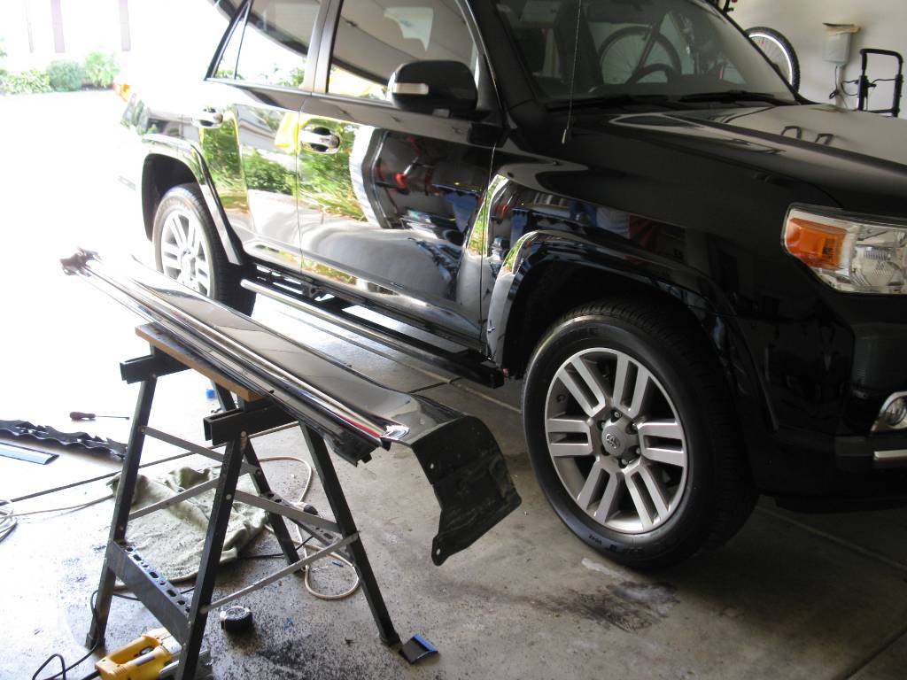

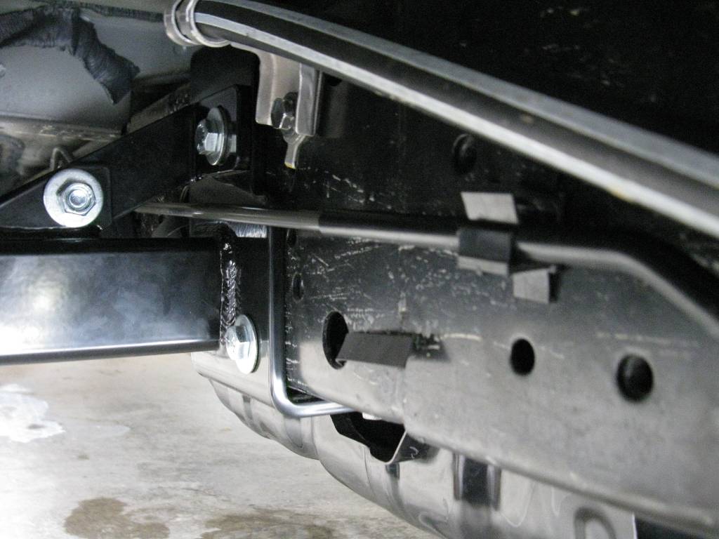

I installed the Shrockworks Rock Rails on my limited and ran into a few issues. I had to bend out the hard lines in the front and create a bracket out of a bolt, 2 nylon spacers and a hose-guide with rubber padding.
I also spent 2 weekends cutting the factory rocker panels and used the trimmings to clean up the rockers so it would have a more factory look when reinstalled.
The end result was that there was too much material (especially at the front wheel well) hanging to low and as a result when the truck moves, you would hear the plastic moving. I am now shopping around for the Trail Edition plastic (rockers, fender over molding and mud guard) and my dealer is painting it to match the factory black of my truck.
I would request (if Jim hasn't updated the design already for the Limited) to have the Bolt On gusset on all 4 corners; It means you don't have to mess with the hard lines on the Limited.
Okki
(I have more pics of the process, but since I think the experiment failed, I didn't include them here but can make them available on request.)
Image 1: Rockers off, Rails on the truck
Image 2: rockers cut and new plastic surfaces in place; ready for fiberglass
Image 3: Bolt On Gusset. (request this on all 4 corners for Limited).
Image 4: bracket to keep hard line away from welded gusset (front only).

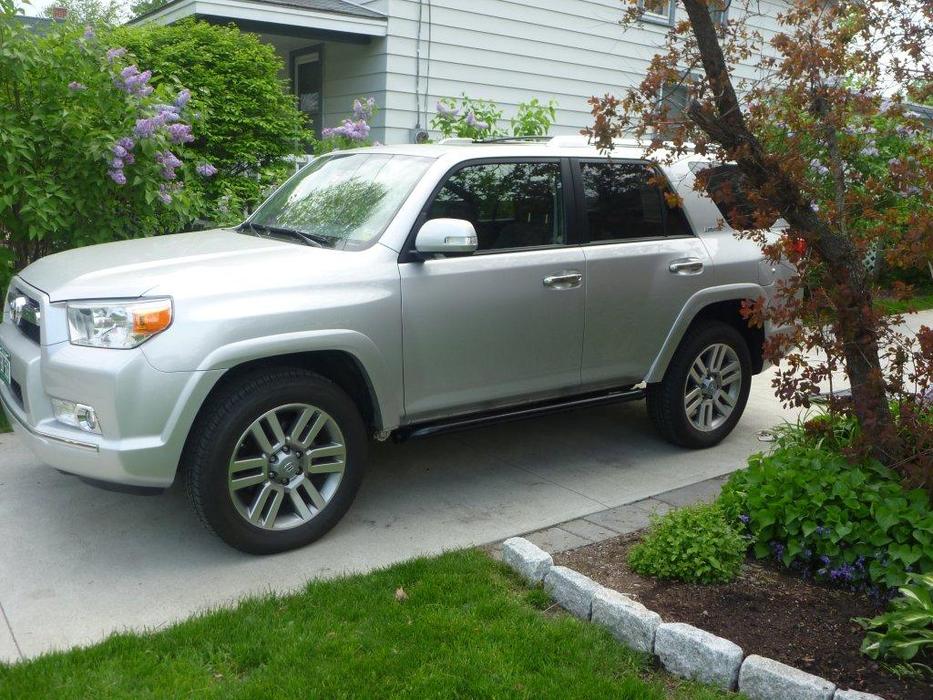

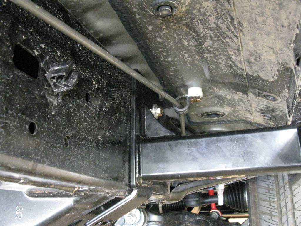

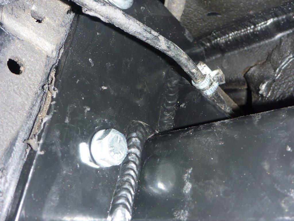

Well I finally had time to put the sliders on my limited today and I am less than pleased. I ordered them during the group buy many months ago but with such a great ski season I didn't get around to putting them on until now. I am having the same issue wtih the hardlines that Okki has and now I have to find a solution. Where did you get your parts for the brackets Okki?
What really ticks me off is that Okki had raised this issue and I was aware of it. Prior to ordering the sliders I checked with Shrockworks about getting all 4 brackets with the bolt on gussets as per Okki's suggestion. Mark from Shrock responded that Okki was "worrying about nothing" and insuated that Okki didn't know what he was talking about. Mark assured me that the hardlines were the same for all 4 runners. I figured I would trust a manufacturer instead of a random internet person, sorry Okki but you never know!
Now I have to go to the store and see if I can find something to use to hold the hardlines out of the way.
If you have a limited I would look for other sliders. This is my first experience with Shrockworks and obviously I am not pleased. The sliders look great and work fine but a manufacturer that ignores issues that others have identified and the fix is easy. I would have paid extra to get the gussetted brackets, now I have to cob something together and hope I don't hurt the hardlines.
The first photo shows the issue, I put a coupe of cable ties on until I can get brackets made to move the hardlines. The second photo is the installed sliders.

As for the hardlines I bought some hose clamps from Lowes and used those to bend the hardlines out of the way. I would still recommend the shrockworks, I think they are really good. My issue is that shrock knew of the issues with the limited and completely ignored the feedback they were getting. It is very easy for them to provide brackets that clear the hardlines, they already do it for at least one of the brackets so there is no design change. Shrock makes great products but you have to know going in that customer service isn't their top priority. You will wait for awhile to get the product as any google search will prove!
