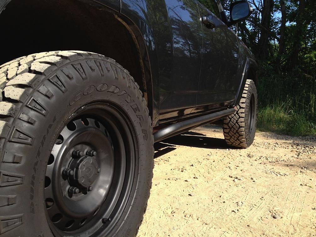

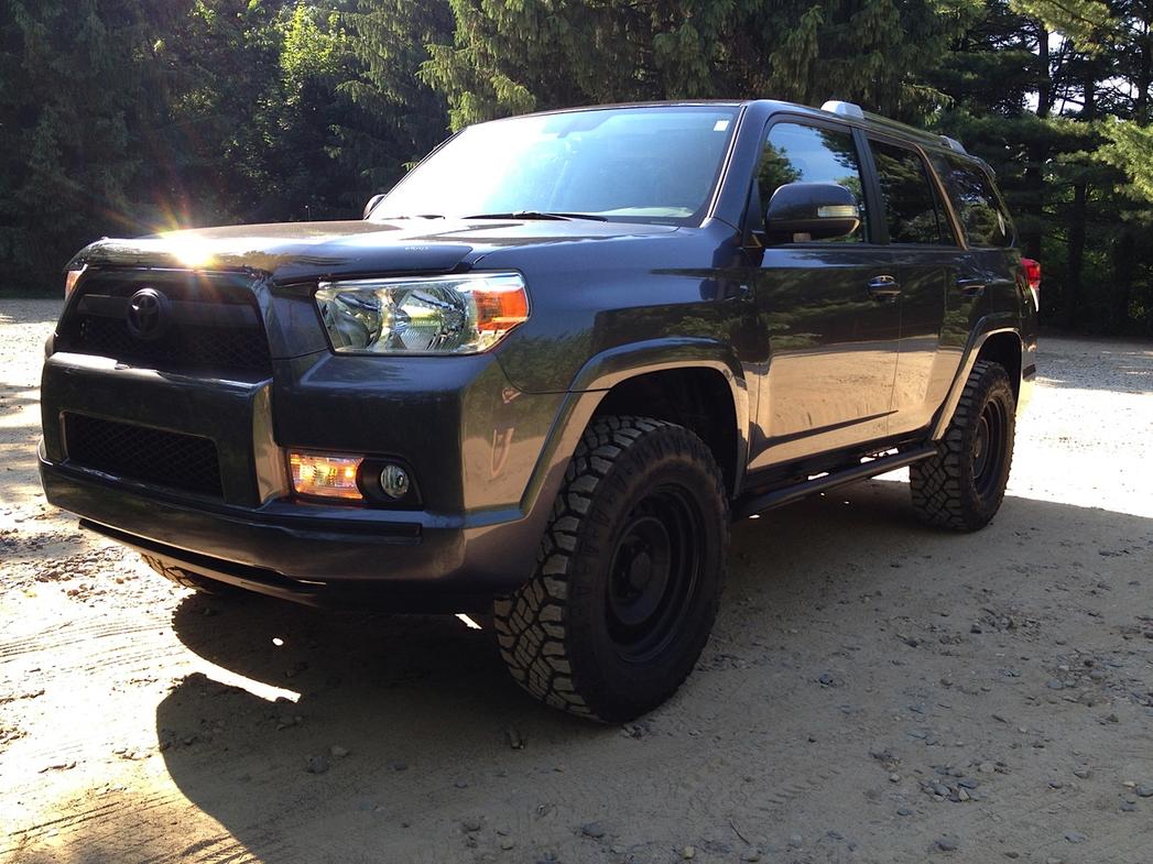

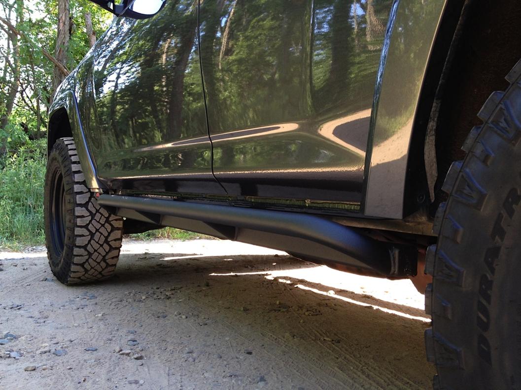

Okay all issues resolved. I just used a dremel to grind the sides of a nut-on-a-stick to fit it in the rear, and I had to drill a hole in to mount the front angled area of the slider. I now I have six bolts holding them on each side. Ready for some off-roading.
