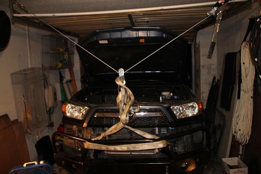

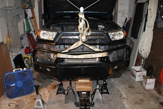

It's not easy but possible. This was my front install. I supported the winch puller from the garage door tracks. But, I NEVER supported the weight of the bumper this way. I only used it to stabilize the pitch of the bumper and the floor jack held all of the weight.
Thats damn clever!! Ill be using the shop lift to help me out.:croc:
