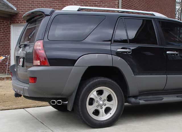

I had mine turned out to the side mainly because I hated the way thestock pipe was sticking straight out. I also hated that resontator bulge at the end of it. I didn't change out the muffler, I just had them cut it off behind the resonator, turn out the new pipe and put the tip on. I haven't really had a chance to ride around with the window down, but I shouldn't get any of the smell inside.

The resonator just helps keep the sound of the exhaust down. I was worried that when they cut it off that is was going to effect the sound, but it hardly made any difference. Just because I drive it every day I could tell, but it wasn't hardly enough to even mention. I left the stock muffler on, because I didn't want it to be any louder. It was just for the looks.

For cutting the pipe, then fitting the piece to turn it out and the tip, it was about $65....To me it was well worth it.

Mine is a 2WD. I just got back and had the window down a couple of times. I couldn't leave it down since it had just rained this morning and most of the roads still had moisture on them, but in the dry areas I put it down and didn't smell anything.
