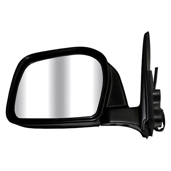

Watch the shape; sometime in late 99 they changed the mirror design to be more aerodynamic.
Here's a 96-99 mirror:
Here's a 99-02:
They smoothed the inside edge.
