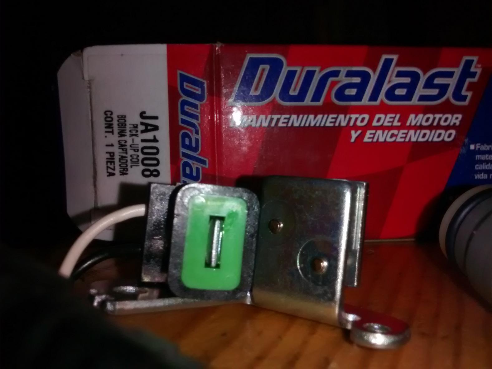

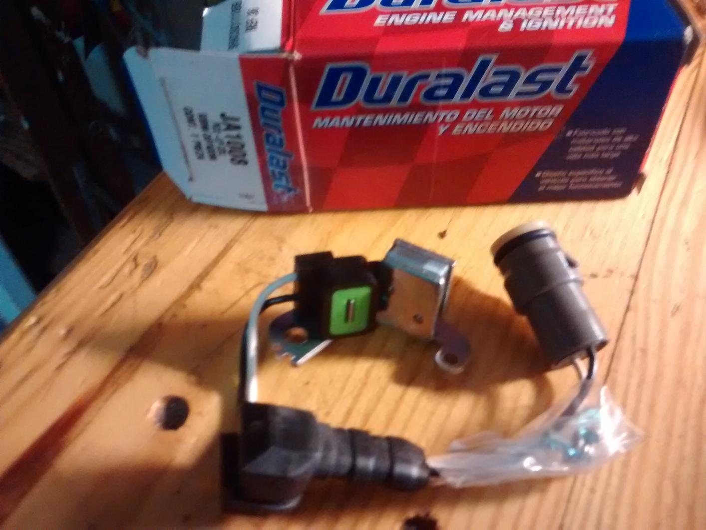

Purchased the New "Pickup Coil" a
Duralast p/n JA1008.
Measured resistance of this new part , it read ~ 235 ohms. The Chilton Repair Manual says 140 - 180 ohms per spec.
Why Does It Measure This ???
Decided not to install this new Pickup Coil -
Until I find out WHY Resistance reading is
Explained.
Original Dist. Pickup Coil reads 178 ohms with
Engine Cold.
