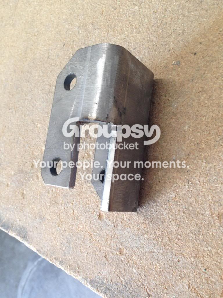

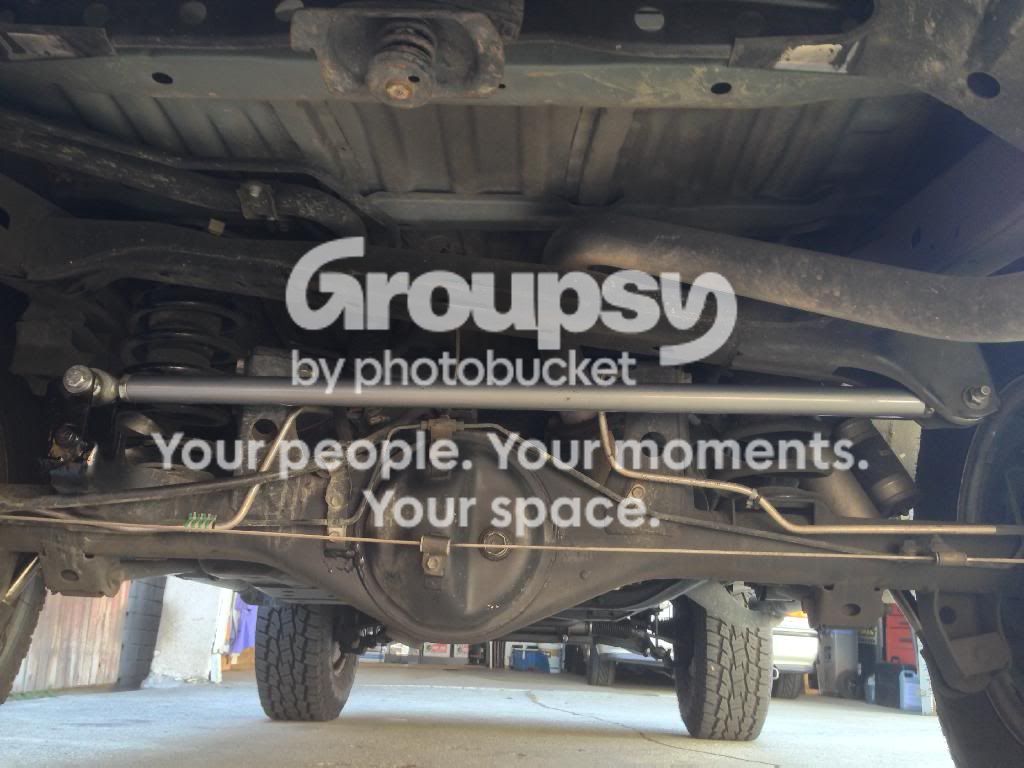

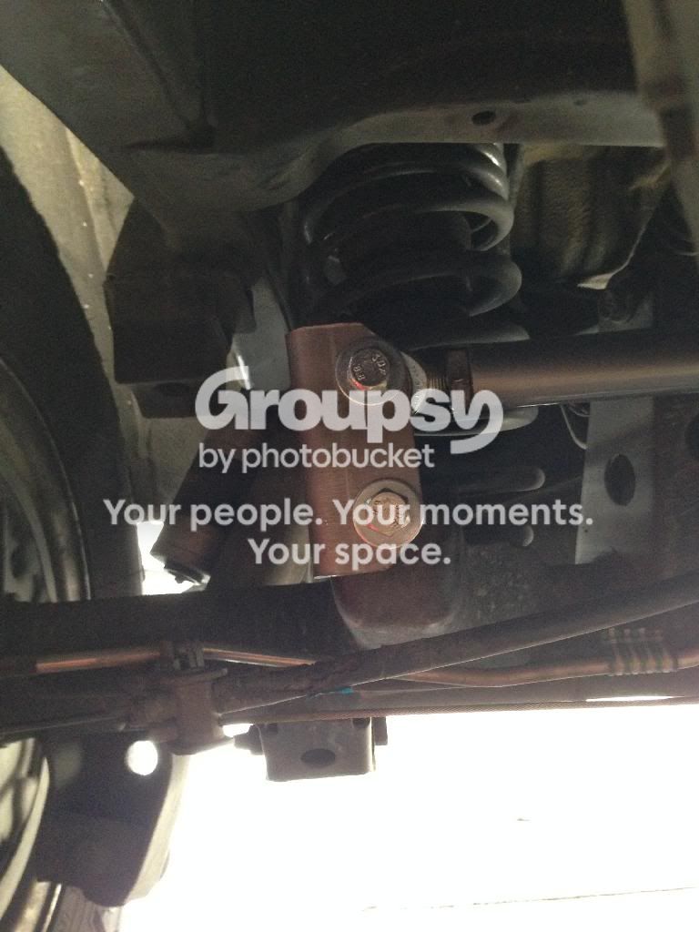

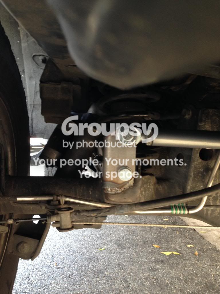

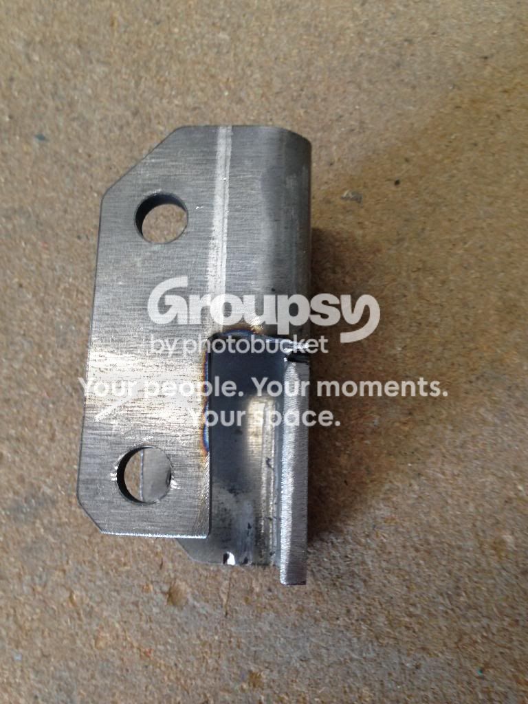

so i have procrastinated this bracket long enough and lost motivation to mod it to do a panhard lift on the axle side. well 2 years later its on lol.
43D981E6-4810-4AEF-92EA-6F593CE99B63.jpg~original
0BC130E2-9035-49F5-A793-483BE5F6052B.jpg~original
CE4F9733-8C70-4C9A-B986-311107C137F2.jpg~original

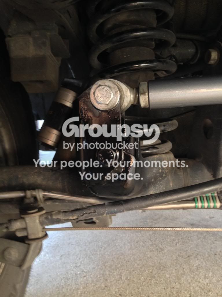

now to have it welded in place and paint it black. hopefully this will get rid of some of my tracking woes with the 4runner.
As you can see I did more modifications to the bracket to clear for suspension travel since the top part of the bracket was hitting the frame during hard dips. Now to figure out my front end clunk and install my rear icon external resi's and alignment and call it a day!

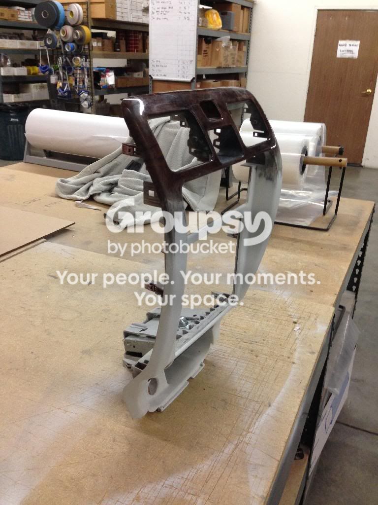

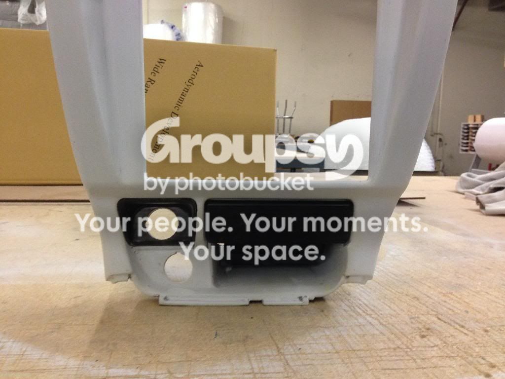

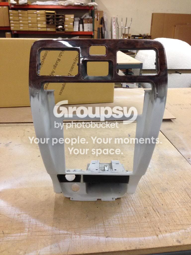

On a lighter note my custom center console is almost done I'm pretty excited.
If I had to do it again I might have thought twice before I would have attempted this again, but the results are actually really good. And I was able to keep that oem look.
