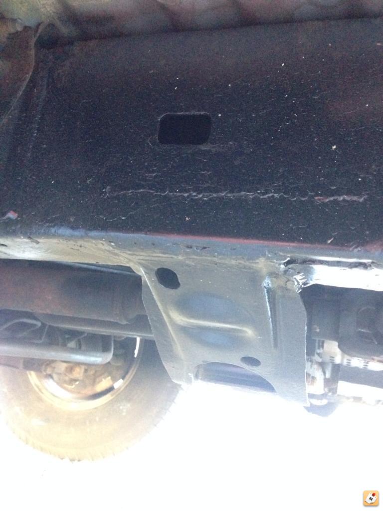

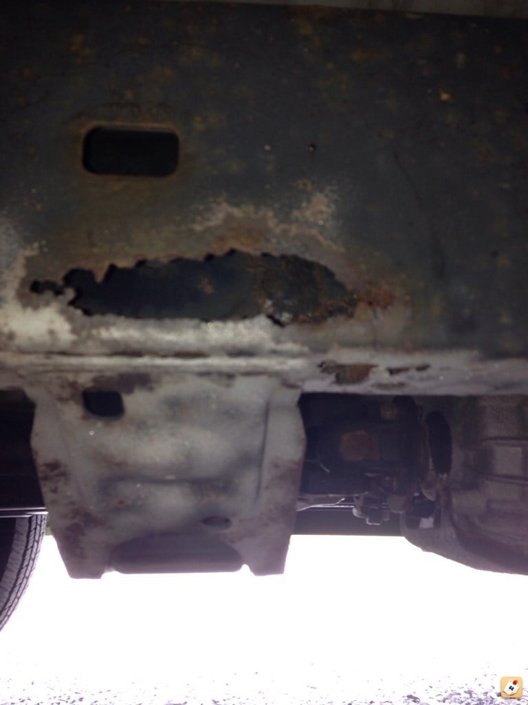

Before I Monstalined the body, I hit the majority of the rust with Chassis saver. It went on nice, and thin is in with this stuff. 2 coats is mandatory and again, the thinner the better.
Before....
After.....
