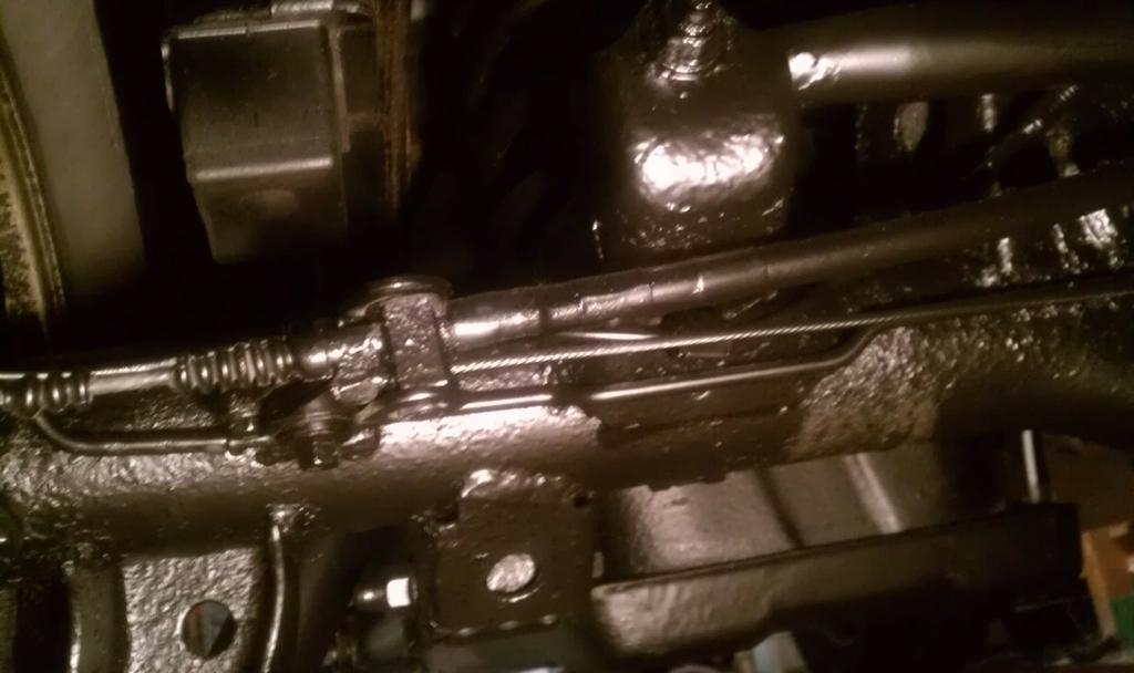

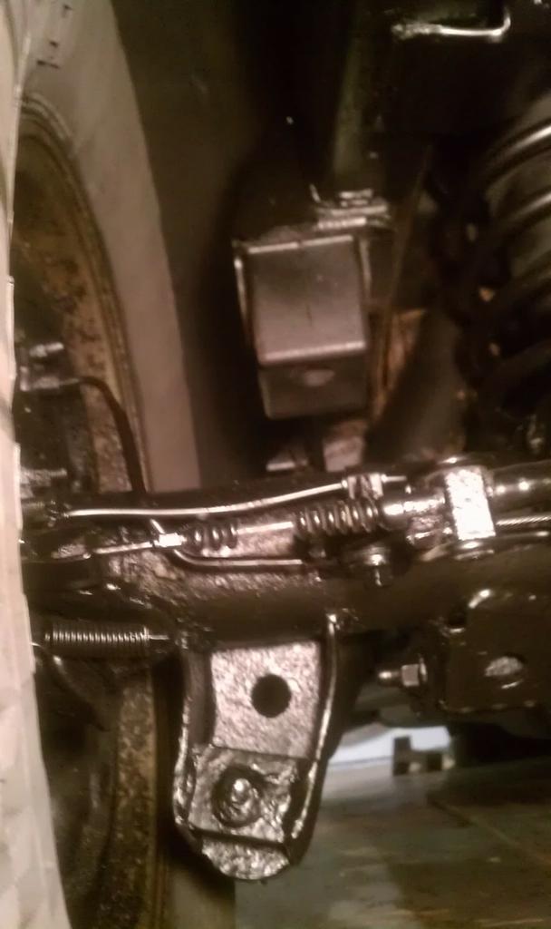

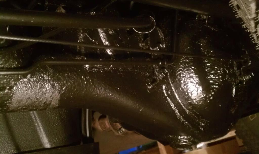

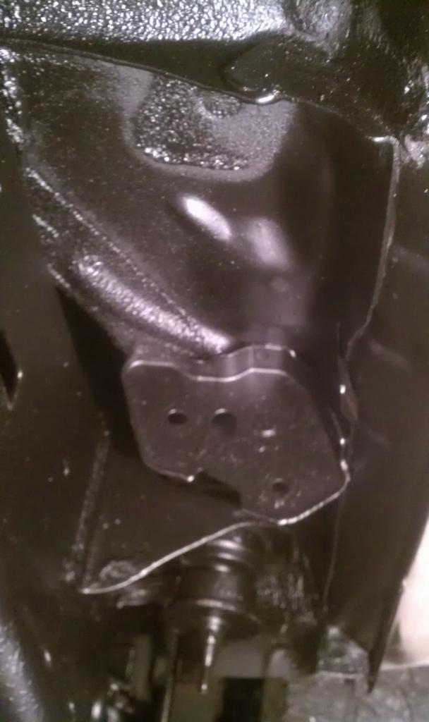

getting the rust off before applying any product is key. mine got eastwoods and a ureathane paint. will see how it holds up this winter. think i may have posted some of these pics somewhere else... not sure.
