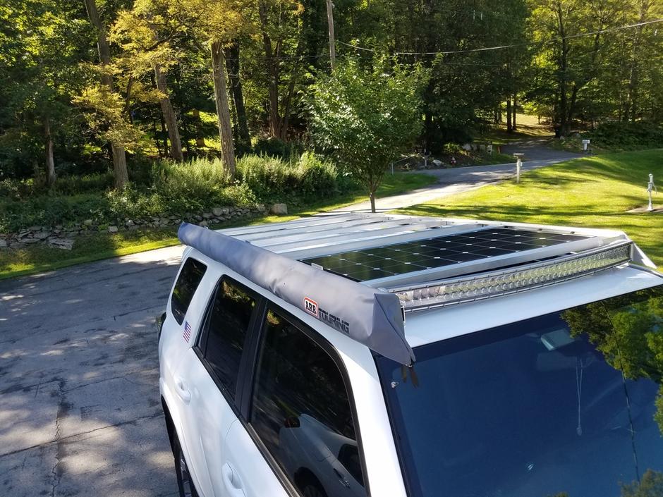

Don't do an inverter, it is inefficient to convert DC to AC. The Indel B will work more efficiently using the 12V DC plug over the AC plug. Get a cheap battery box, 33Ahr or better AGM battery, NOCO or Battery Tender etc. AC battery charger (to charge the battery from the rear AC port when driving), A BlueSea fuse block and bussman 100A circuit breaker and a BlueSea 12V plug. Put the battery in the box. Put attach the circuit breaker and panel inside the box and run install the BlueSea 12 plug into the side of the battery box with 8Ga wire to the BlueSea Fuse box. You can attached the ring terminals from the NOCO AC battery charger and run the quick disconnect cable out the side of the box. This setup will give you a Goal Zero Yeti function, with the portability for $180 (I added all to Amazon cart). For the solar get the 100W Renology with built in solar controller for $200. For $380 you will have a 33Ahr (or larger) portable battery box and 100W solar charging system. For reference, I bought the Goal Zero Yeti and 100W Goal Zero panel and it was $1000. The other option is to get an Odyssey main battery for your 4Runner and run a new 12V outlet in the rear and then use the solar panel to charge that battery when stationary. About the same cost, all in.

Solar is pretty inexpensive nowadays. Since you'd like yours on the roof, spend a few extra bucks (if you can) on a good charge controller and a polycrystalline solar panel. It'll run more efficient since the roof isn't always at an ideal angle for solar capture.
I'm currently running a portable 100w solar suitcase since I don't have any roof rack space. I can move it around and adjust the angle if I want. More details in my build thread linked above.
