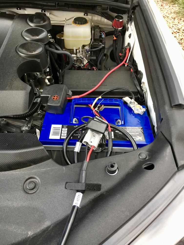

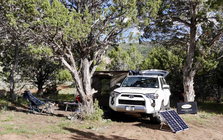

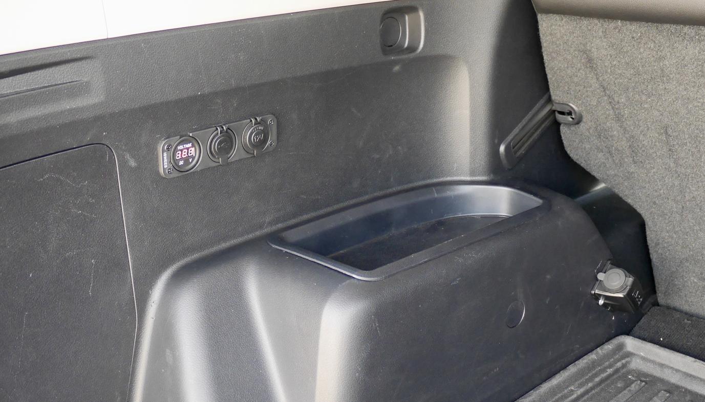

I am a bit of a newbie here but after reading a number of posts here and elsewhere, this is what I came up with and it worked well last weekend. I purchased as ARB 50 frig and did a hard wire to the rear with their 8 gauge wiring kit. I also ran a second 8 gauge to a BlueSea fuse box with a Voltage Meter and USB charger. Both of these run through a 100 A breaker at the battery. I changed out the OEM Panny battery for a Battery Plus version of the Northstar Group 27F (92Ah) and added both a quick disconnect for a 120 W suitcase style solar panels with controller and a NOCO battery charger so I can top off the battery when either on the grid or off the grid to the 13.8 V recommended for the battery depending where I am parked for the evening. I went with the 120 W solar as it gives me 6.8+a of charge so even if it is only for a couple of hours in the evening or morning as I pack up, it helps with topping off the battery. Last weekend I camped for two days without running the engine and my voltage never dropped below 12.7 V with frig set at 27 degrees. Once cold and keeping it fairly full, the ARB only draws 1 to 1.5 a per hour. All in, it was not inexpensive but works well and very simple to install in an hour or two.
