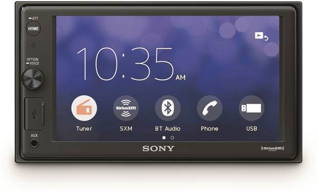

go to Crutchfield and get the Sony XAV-AX1000 I added the parking brake bypass from amazon. Kept steering controls. Takes more time to configure the wiring harness than anything, but works and fits perfect.
My son wanted a volume knob and front usb, that's why I chose it. but, it's a perfect look for 4th gen and is flawless.
