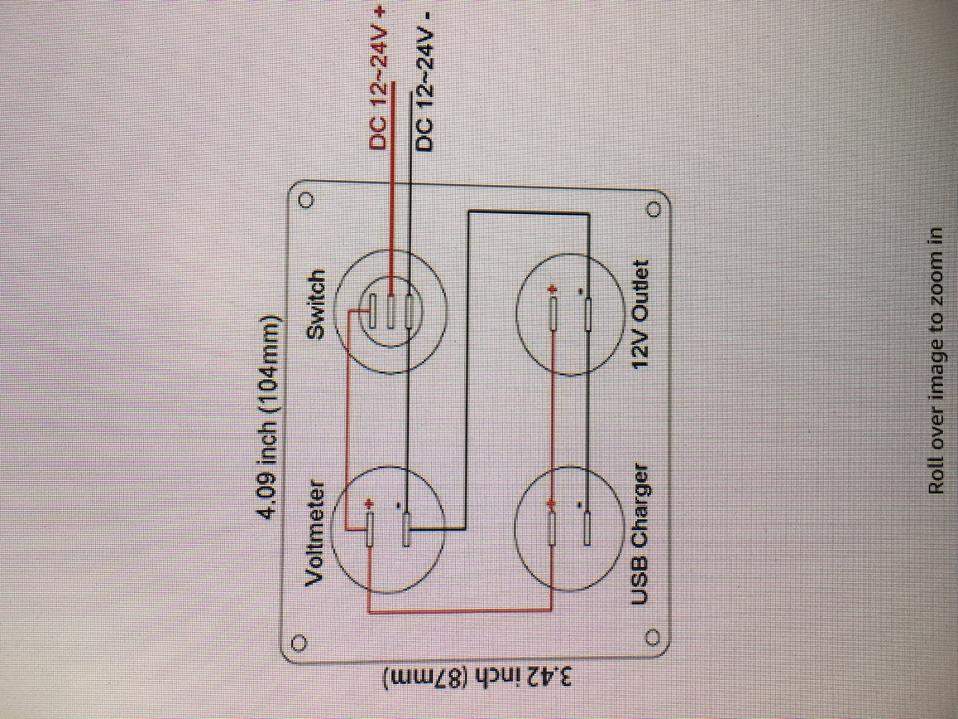

That's a great post. I think I'm going to install the same. Couple questions though.
I see how it comes with a standard 12v outlet. Did you simply remove that and install the ARB outlet in its place?
Also - can you provide more info on how you wired it? I attached a picture how they show below.
It seems as if you ran one set of wires directly for the ARB plug, and then another set specifically for the switch, voltmeter, and USB charger? With the power requirements for the ARB outlet it seems like it'd be better to run that separately.

I did remove the standard 12v and used the ARB female socket that screws in.
I wish I could upload a pic from my phone but this Tapatalk is not cooperating.
Basically I used the 8awg from the ARB wiring kit and ran it directly to the plug. Then I jumped off the plug to the switch, from the switch I jumped to the volt meter then jumped to the USB.
I know that probably doesn't help but from my phone that's the best explanation I can give.
All the connections run off the ARB refrigerator wiring harness. The switch when in the open position activates the USB and the Volt meter. When the switch is off the Volt meter and the USB are inactive.
Hope that helps. If not I can post picture later.

That is about as good of an explanation you can get without a picture lol. It also answers most of my question. The only thing I'm unsure of, is does the ARB socket have 3 connection points, two positive 1 negative, like the switch, or how do you do the first jump from the arb socket to the switch? Hope that makes sense.
I like what you've done a lot. Very practical and it looks clean and I'm about ready to pull the trigger, just want to make sure I do it right.
[MENTION=164485]Trixx[/MENTION],
If the ARB only has two terminals, you just keep running the RED +12. IOW, instead of it stopping, just keep it going to the switch center contact.
Then run from there to the meter and USB.
ETA: you see that screen shot of that wiring diagram just a couple posts up?
Disconnect the +USB(Red wire from Outlet to USB) and connect it to the SWITCH - CENTER. ( now outlet + to switch center )
Disconnect the +12V switch center and move it to OUTLET + ( there will two red wires on OUTLET RED + now. ( +12Vin and the one going to Switch center that you did in step above )
IF the ARB is a switched outlet, which I doubt, you would connect it just like that switch. But if the ARB socket is switched and you unplugged it, then the rest of the circuit would not work. So it's most likely just a two terminal outlet.
Also where that picture shows 12-24VDC - that will not be a -12VDC it will be GROUND... I mean I assume you are running a regular 12V system.
