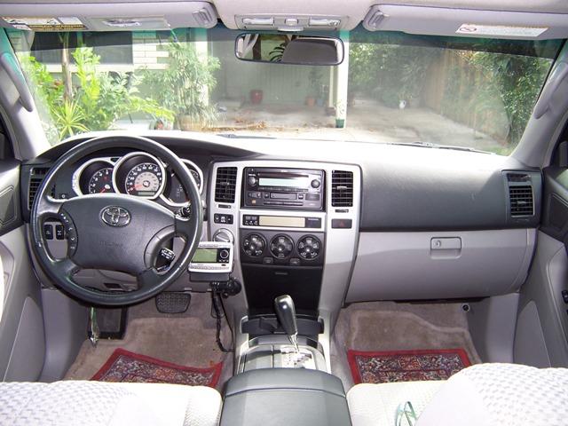

Here is my Sirius set up. I have the Sportster and boom box for the house. Just bring it inside with me when I get out of the rig. Not a fan of stuff like this and would prefer the sat through the head unit but have to listen to Howard Stern (King of all Media)when I drive. Only wires exposed are the ones from the unit that run under the center con and it's like 3 of them. I got power from the cig outlet.
