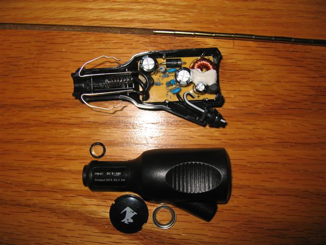

I did the "add-a-circuit". I found a really good ground. I had 12V at the tip of the plug...BUT THE PROBLEM is that the new units only want 5.2V. I opened up the DV adapter and there is a tiny electronic board and some simply components.
Now what? Either there is some clever way to reduce the 12V to 5V or else I have to literally build in this stupid adapter to function as a reducer.

the essential pic:
Hmmm, so that's what's inside that thing. What I did was just buy a cig lighter socket, wire it in and plugged the power adapter into it, hiding it all behind the dash.
That's probably your best bet.
Otherwise, I'd carefully solder wires to the contact points of that plug and epoxy them in place so they won't pull off.

Or, if you decide to tackle saving the $ and taking apart the actual plug, what you need to do then, is...
Open up the lighter plug (which you have already done) and look at the back (side with just circuit board and solder, doesnt have all the components on it) youll see where the wires are soldered from the circuit board, to the metal pices that make contact to your cigarette lighter, one leads to the outer metal pieces (negative), and the other to a spring/fuse (positive).
Solder on wire to the solder on the back of the circuit board where the wires FIRST MEET THE BOARD. Fuse the positive wires, and again, run the positive to your accessory wire behind your radio, and ground the ground wire like i previously mentioned...
There you go, installation instructions on wiring up a satellite radio power wire.

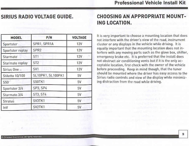

Hi,
Not sure if this will help - but I am installing a Sirius Sportster for my sister and I purchased the following kit from Circut City to hard-wire it in.
Sirius Car Installation Kit ( SIRPVK1) $35.99
Now I have a problem with static when using an FM station for Sirius and have to use the lighter socket for power.
I am doing the install today and will let you know how it goes.
Well after doing the install on my sisters civic today - I am sure this will work for your voltage problem. It will step down the voltage from 12vdc to 5vdc.
The install took about an hour and everything looks and sounds great !! No more static or power cord from the lighter !!
Also the kit comes with a nice mounting bracket.
Here are couple of pages from the installation guide.
Hope this helps !!
