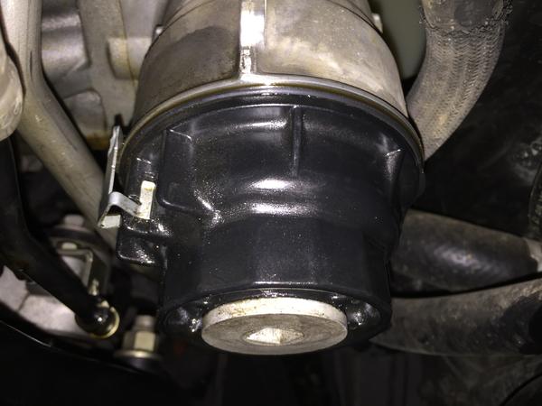

Removed the skid plate, and look what I found. Looks like the O-ring was installed incorrectly, and the filter was torqued way past the point it's supposed to go. Glad I didn't lose all my oil on the highway and seize the engine!

Sorry to hear it, man. I'm hoping the filter threads aren't jacked from dude torquing it down too tight. And you can see the O-ring in my pic...totally not where it's supposed to be.
The funny thing is, it was fine for two weeks, and then all of a sudden this weekend, I noticed a big puddle under the truck. Unbelievable.
O-ring should be in the inner groove near the threads, should not visible. The fact that is visible means it was incorrectly installed and not torqued down, tabs should line up.
You are correct; if it were in the right spot, it shouldn't be visible. Look at the pic; it's right between the housing and the filter flange...not at the end of the threads on the filter like it's supposed to be.
I had to leave so I haven't got to it yet, but it looks like it was torqued a good quarter turn (hopefully not a whole turn and a quarter!) past where it's supposed to be.

I think they may not have torqued it as much as normal (the O-ring is obviously in the wrong spot too). Shouldn’t the flange rest against the housing? I always torque to factory spec and I thought I remember it being that way.

it's not overtorqued, it's actually a few turns short of snugged up. as others have said above, the flange and filter housing should be flush, but since they didn't put the o-ring in its proper, recessed position, it's physically blocking the filter housing from setting properly. the way they messed it up, it looks like the o-ring itself was actually acting as a weak seal, which is why it was fine for a short time before it finally shit the bed.
