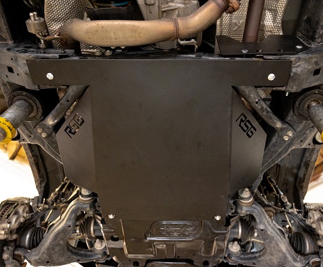

is there any need to be concerned about heat dissipation with the shields? Cats operate hot, but air can move freely around it. my concern with a shield is that hot air gets trapped under the cat and in the shield and not able to escape, causing overheating
I like the RSG one because it works with my factory skids which are in good shape but there are no install instructions. I'd like to know how many hours I'm going to have to spend cleaning out 10 year old any unused bolt threads I'd need for the shield lol
It is a very easy install. We use two allen head bolts as well as two carriage bolts. The carriage bolt going through the rear cross member on the driver side can be tricky to get at but isn't too bad. This skid is a deterrent. Most catalytic converter thieves will look underneath and move on to the next one when they see this. It would take some time and tools for them to really get at the Cats. We are working on uploading instructions here this week so stay tuned!

thanks for this. are the 4 mounting holes currently unsused or only the 2 on the crossmember? when I say unused I mean there are currently no bolts running through them currently (basically exposed threads)

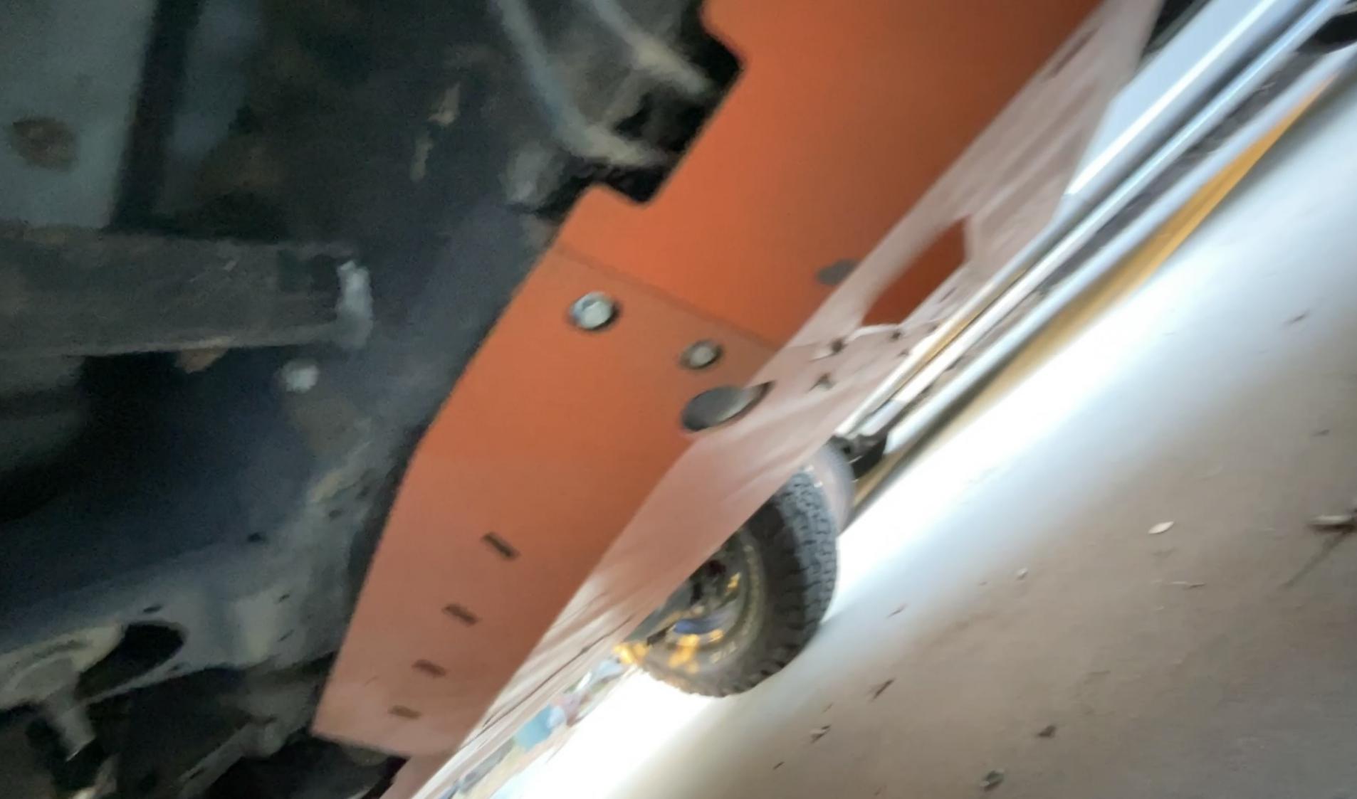

Works great and easy install. RCI pre-drilled holes in the transmission skid.
do you have the instructions for these? I want to see if I can install this without a lift. those carriage bolts look really tricky to do from your back
Rci cat shield
Did you have to ask rci to pre drill the holes for you on the transmission skid or did it already have them pre drilled when you got it?
I had put in an order for a full set before these came out so they weren’t going to have the holes pre drilled. They did offer to give me a trans skids with the holes if I was willing to wait for the next batch to finish.
I just installed my RCI’s, still no predrilled holes, but easy to do, took 5 minutes. Overall fit of everything was really good.
