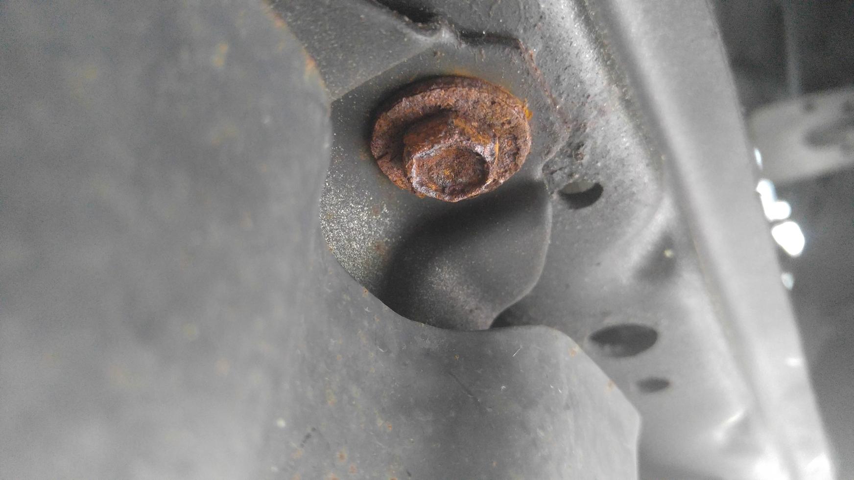

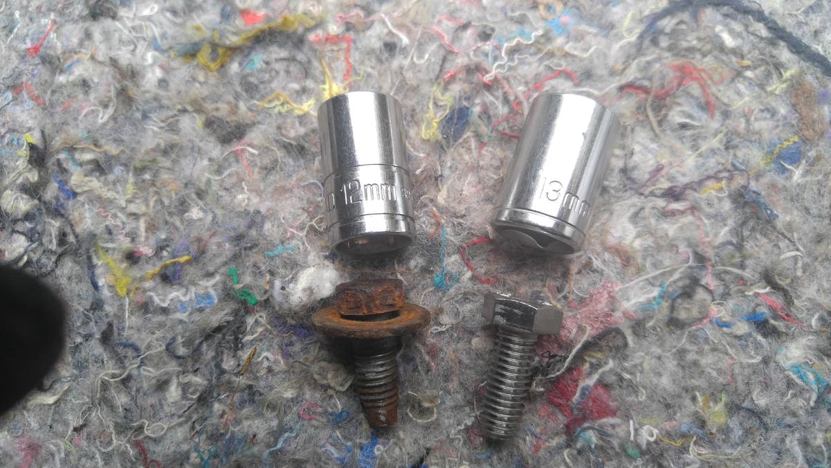

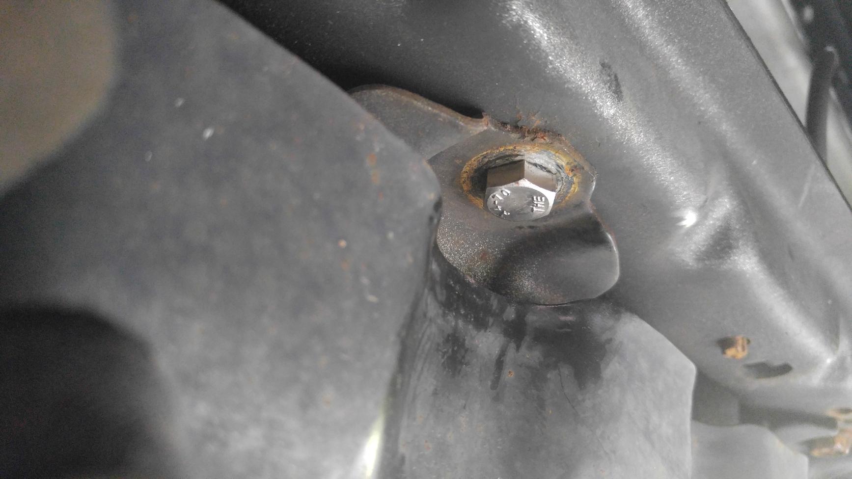

I guess I'm one of the less lucky ones.
Of the 4 bolts for the front/main skidplate, only 1 would tighten up with the new M8 bolts. When I tried cranking them down tight, the threads skipped. I guess I'll tap it to a M10, and see what happens. Might try use split washers and see if I can get away with less torque. It sure did seem like the metal of those nuts is really soft. It was pretty easy to tap.

^^ poster above...I would have put a flat washer under the bolt head. Its just good practice.
