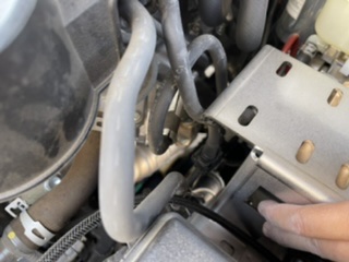

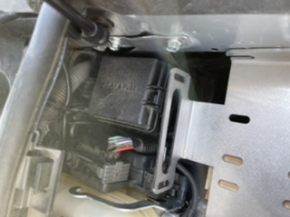

So I test fitted the bracket and noticed flex hoses rubbing against the side of the bracket which do happen to be on the sharp side. Has anyone had any issues with the bracket slowly eating at these hoses with regular vibrations? Or have people just relocated/adjusted these hoses to not run against it? Just wanted to see what people have done. Not sure if it’s different with models 2019 and below. I know a few things have moved a slight bit in 2020+ within the engine bay.

Mmm, I think you would be asking for trouble with the contact, and it seems like a lot of work to relocate hoses.
I had a Rago mount for 2 years in my 2019 and didn't have that problem (great fit and I liked that it was aluminum). I replaced that this summer with a PowerTray and it doesn't have that problem either (added a Switch Pros).
Can you send it back? Easiest to go with a different brand IMO.
Gonna contact SLEE about it. Sad, though. I’ve read nothing good stuff about the SLEE mount on this forum. I’m surprised it wasn’t mentioned. You actually have to push those hoses aside to get the mount in place so the hoses are sitting fairly firmly against the edge of the bracket once let go.
On the positive side their relay box relocation bracket worked perfectly to regain the space 2019 and below models have in the same area of the engine bay

funny I came across this thread. I had a slee bracket on my workbench that I hadn't installed yet. I went to do a test fit and ya you are right, in my 2012 there is an uncomfortable amount of movement of the hoses that needs to happen to fit this bracket. the only way it fits somewhat comfortably is to run the flex hose under the left side of the bracket, where it rests on a sharp edge.
I too have read many good reviews about slee but I can't put that in my truck as is. will be getting a rago now if I can't find a way to nicely move those hoses out of the way...
