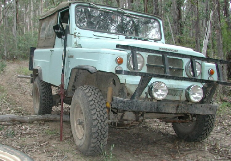

Here's my old Nissan and my high lift in action....

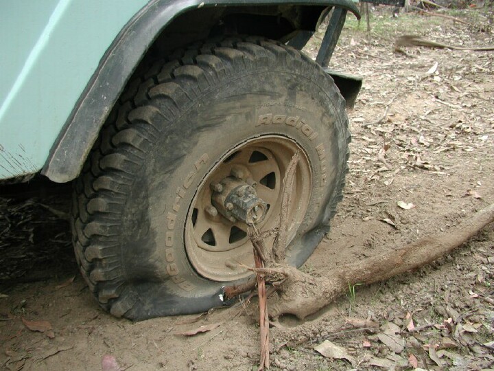

... and here's why I was using it. High lifts are awesome, dangerous sometimes, but still awesome. :)

Just a different opinion, nothing more:
For this condition I would have pulled out my bottle jack and lifted only the wheel in question, just like a car on the road. That way I am not working against the entire stretch of my suspension.
Yep, the bottle jack would have worked just fine too.
I prefered the high-lift because I dont have to crawl under the rig to position and use the jack and the high-lift is much faster to operate even with the suspension travel.

I do agree that in many conditions the bottle jack would be pain to get under the rig. It depends on so many factors...and probably my mood as well.
