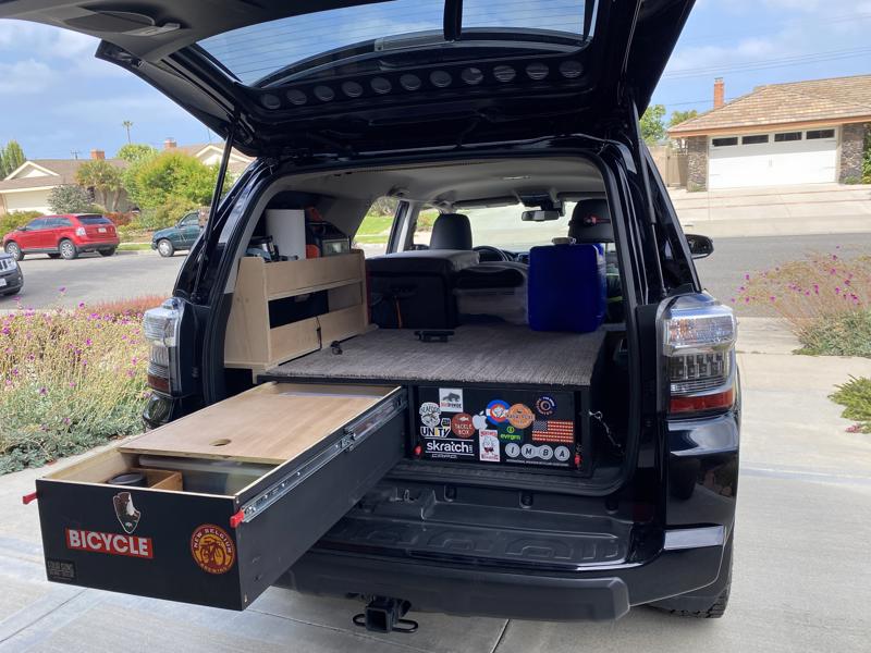

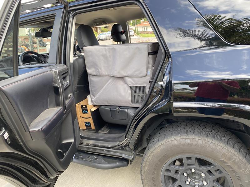

I had similar thoughts. After looking at a number of pre-built options I decided building my own would be cheaper/faster. I went with a two drawer box that fits behind the rear seats, with an extension that goes over the right side. I also went with removing the seat back and bottom on the right side to allow for more storage. The deck is at the height of the wheel wells, I have a 4" air mattress and there is plenty of room to move around although not enough to sit up (I'm 6'-2"). I'm new to this form and not to sure on how to get around....But, feel free to DM if you have questions!

I like what you did. How did you connect the extension to the drawers when it is used?
I did a similar one but only as tall as the stone inside so I have more headroom. My extension is in three parts so I can fold either seat if I have need.

I mounted a cleat/ledger to the drawer box and have a few screws down from the top of the extension. So far it’s held…at some point I’ll need to figure out a better method as the screws will wear out the cleat over time. That section is a work in progress, as it’s kinda a “B” to take in and out. I figured best to leave as is and beat it up a little or break it before improving with a second attempt.
Thanks! this is pretty much exactly what I was thinking, but probably making an addon for both sides and removing the entire rear seat during those solo trips. the storage underneath+drawers seems like a huge benefit. I have Plano boxes, but I hate to leave things outside if i don;t need to.

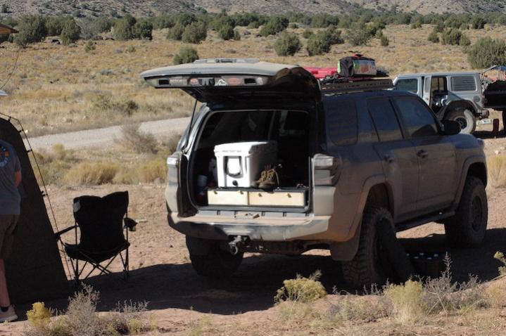

I actually have the same boxes as you. For me, the problem was that I don't like leaving the boxes out at night unattended especially if there are bears around. I haven't actually tried sleeping in the back with the boxes in it because I usually only go with the wife and use the RTT, but my upcoming trips will be offroading with a friend. I also usually have quite a bit of gear back there, but going solo won't have as much so maybe I will minimize and just tie the 2 boxes down like you did. Thanks for pic for ideas.

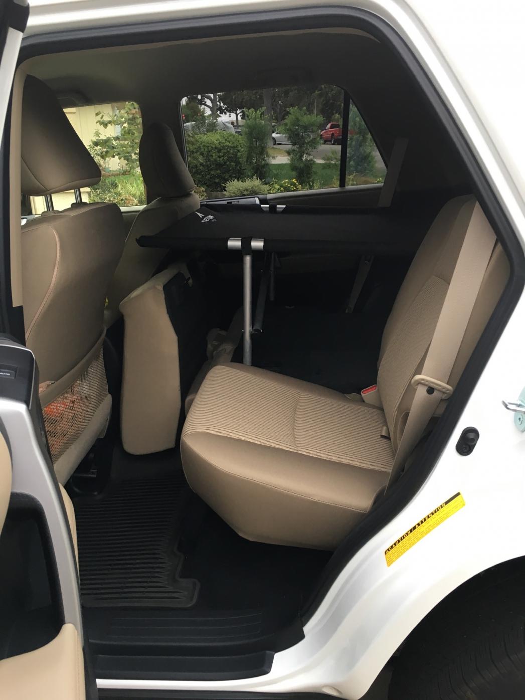

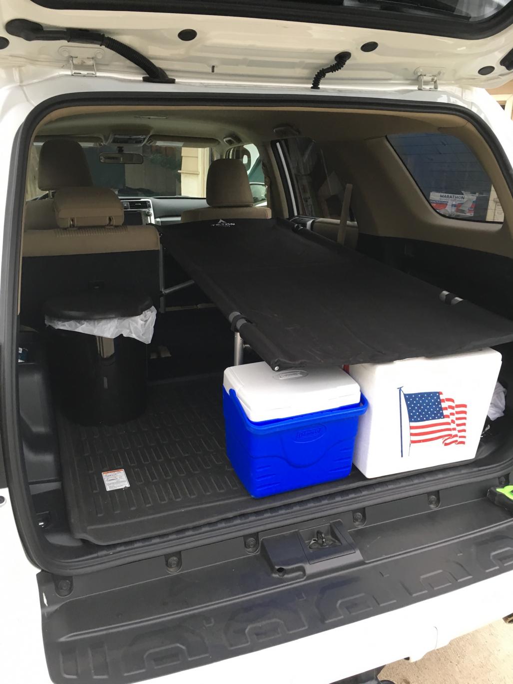

My 2017 SR5 is my daily driver too.
I made screen inserts for both passenger door windows and an aluminum frame cot.
Camping gear goes under cot.
Pics attached. The driver side rear split seat stays usable while cot is set up and allows easy access into cot.

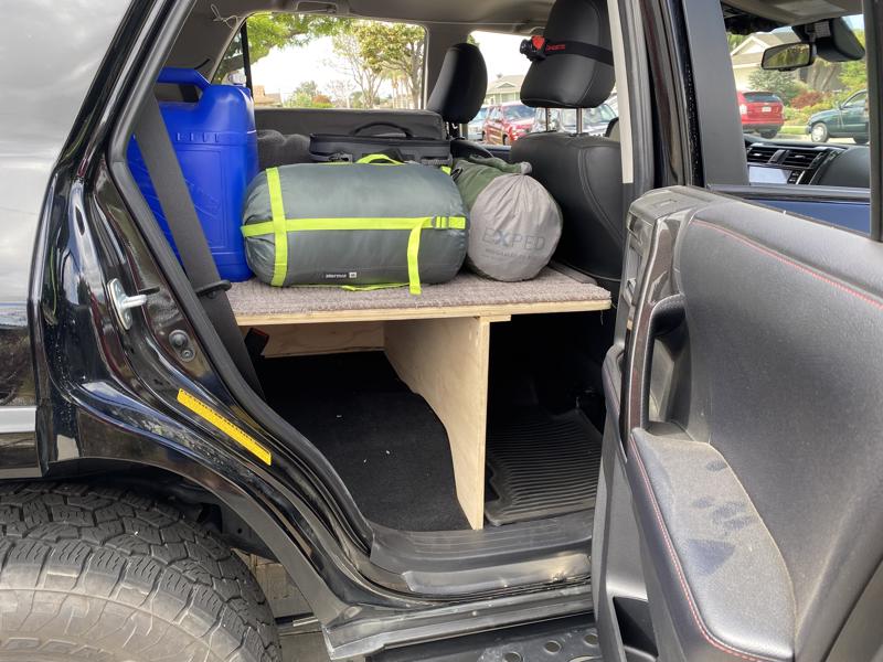

I made a leveling platform in the back to sleep on and ended up packing more efficiently into like 2 plano boxes and getting a fridge. It seems to work out pretty well and by packing more efficiently I have ended up with a LOT more space.
Any chance you have the dimensions and plans for this? I think your build is exactly what I'm looking for!
I don't have plans but I could probably take some measurements when I get a chance. I just cobbled mine together with some plywood and some extra wood pieces that I had left over from one of my other projects. It was a little bit of trial and error as I built it. The best thing I did was separate the platform into 2 pieces so I could leave the rear section in the back all of the time. When winter rolls around I like to put the seat bottoms back and have back seats again. I'm able to just remove the front folding portion and store it until I want to use it again. I wrapped the platform in cheap outdoor carpet and it's been holding up great. When I'm not using the platform for camping, I just put my rear cargo mat right back on top of it. For the front leg supports I just used some threaded pipe fittings and that's also worked out very well. However you do your build, I recommend that you use eyelets and turnbuckles and make use of all of your cargo tie downs in the back to keep your platform secured.
