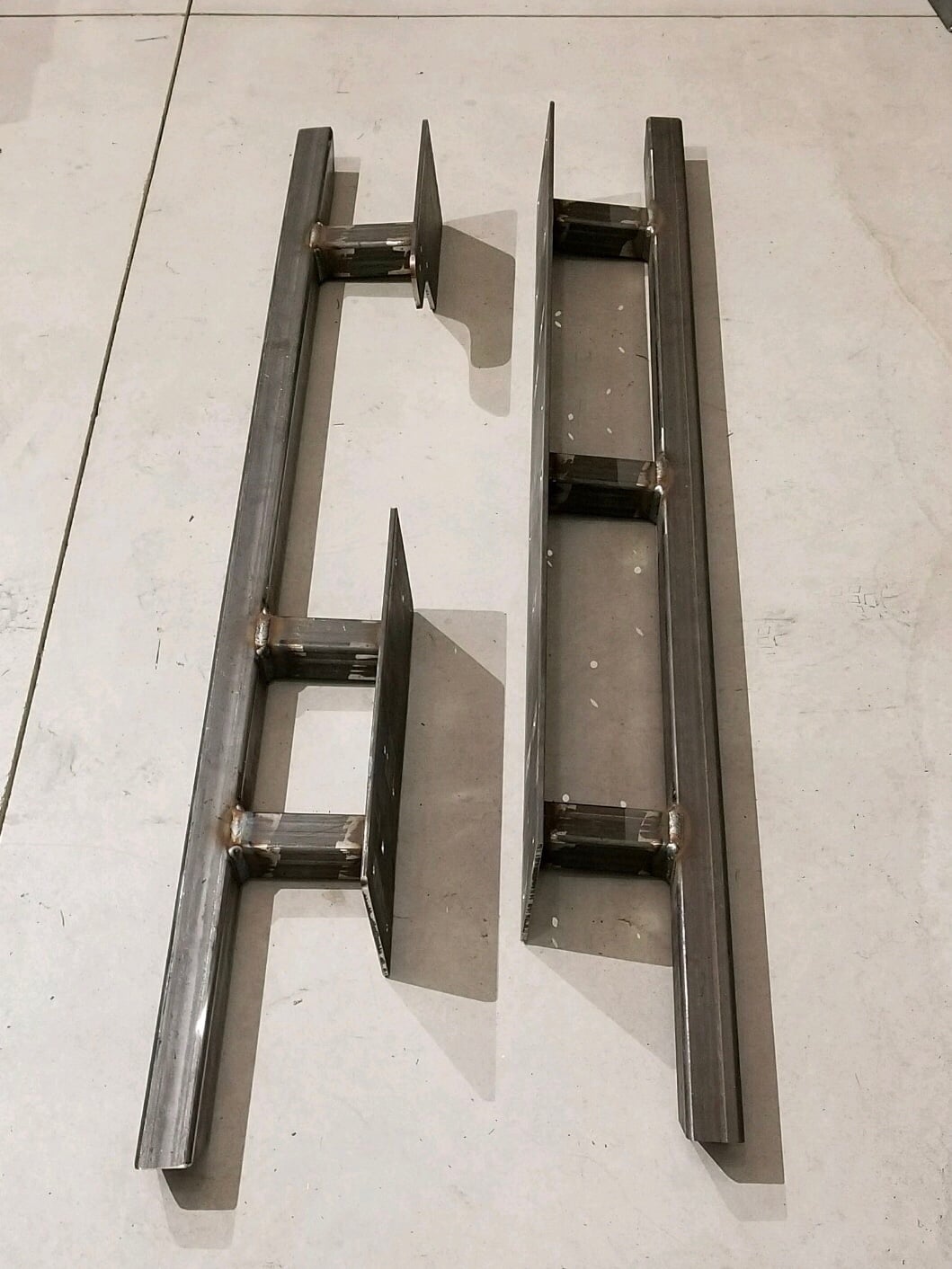

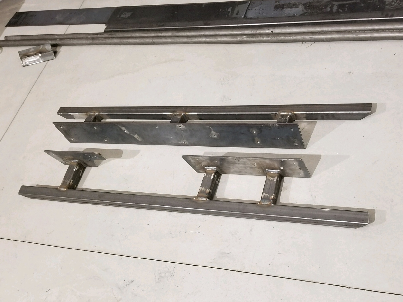

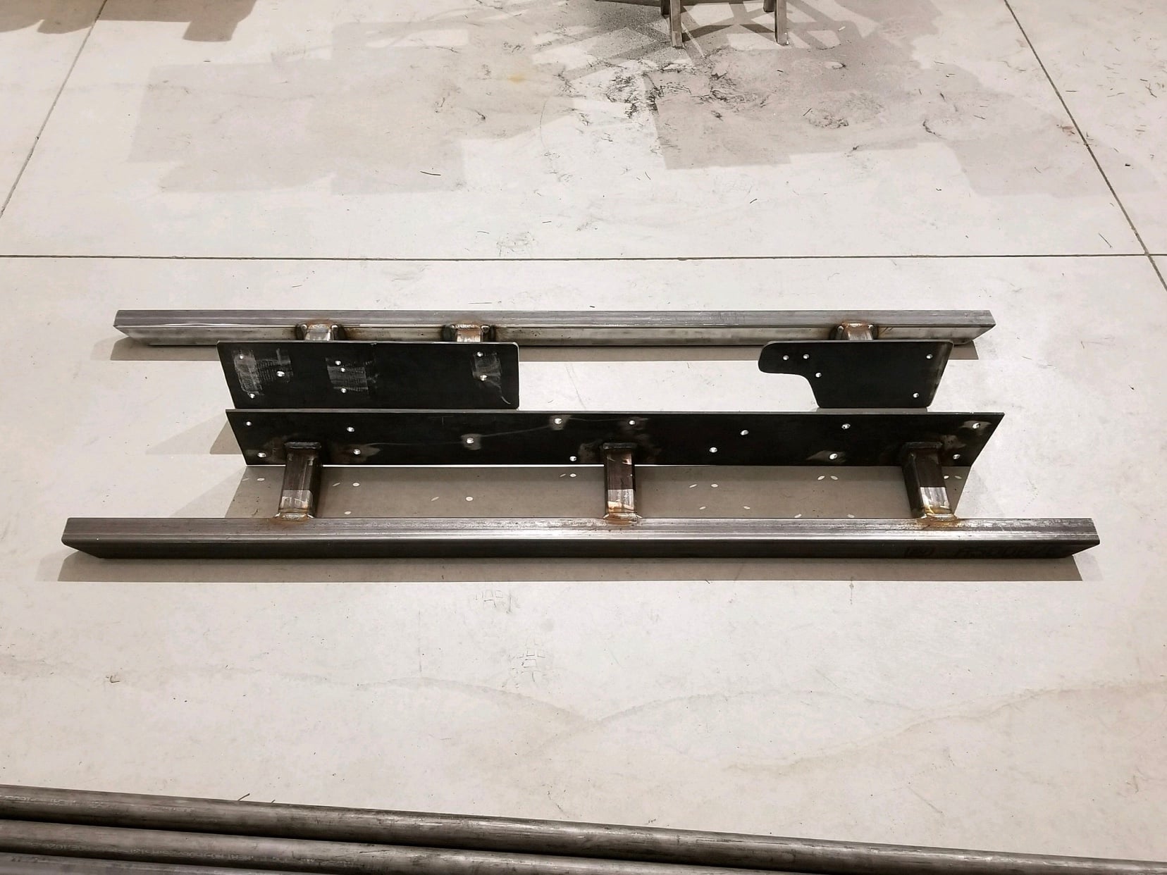

A friend of mine, Jake Burley, who has been doing custom fabrication work on the side, is about to pull the trigger and start fabricating full time. Perfect timing as sliders are on my list of upgrades to make on my currently stock (other than AT tire upgrade) 2016 Trail. So I asked him if he could fabricate a set for me. He started today. Pics of the progress are below. His focus over the winter is going to be on building a prototype adventure trailer, with the goal of production for sale sometime after the winter. But if you like the sliders once they’re done, or need some other custom fabrication work and live within driving distance to Boise, ID, Jake is a great guy and fabricator whose attention to detail is incredible. He gave me the material specs, which are .250"x6" flat plate. 2"x2"x.188" square tube. And .120" wall 1 3/4" DOM tubing. I’ll post more pics as the fabrication progresses.

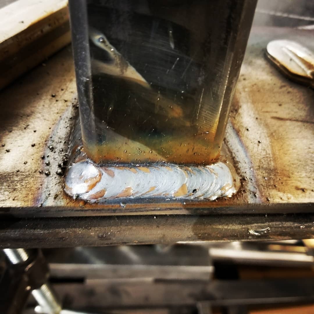

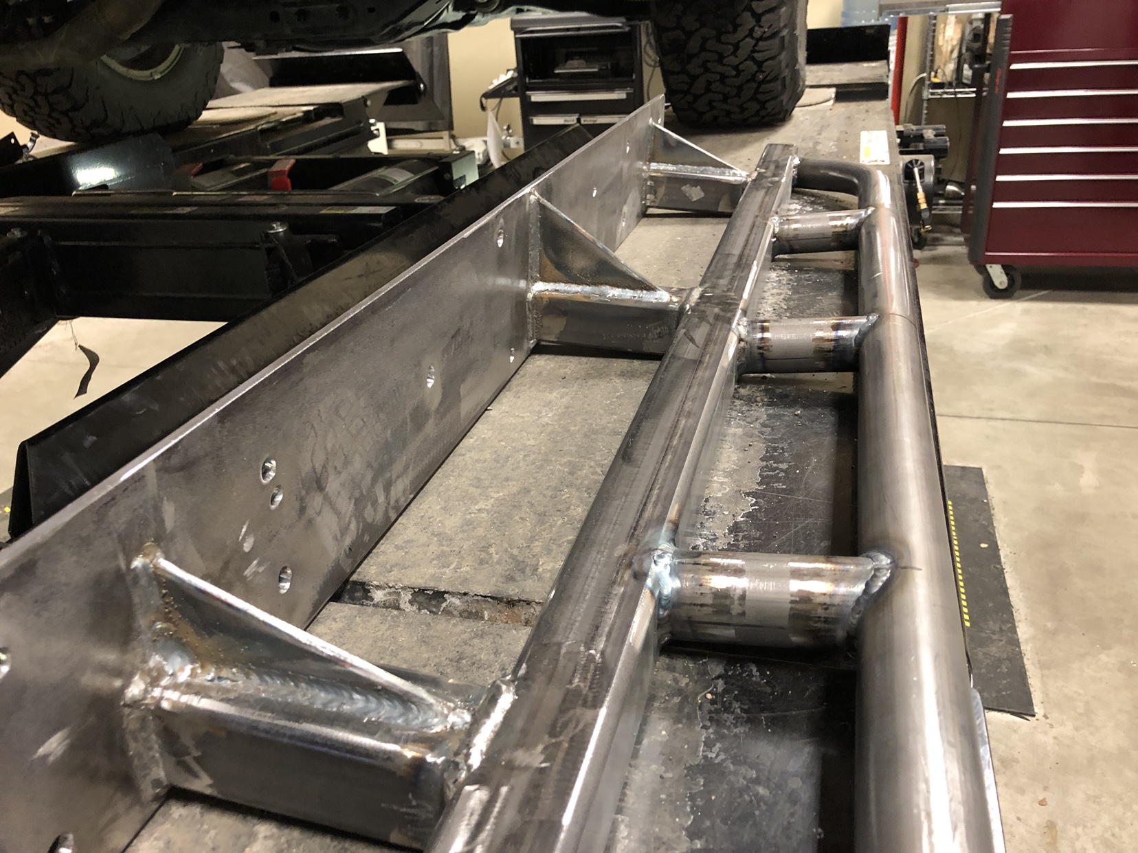

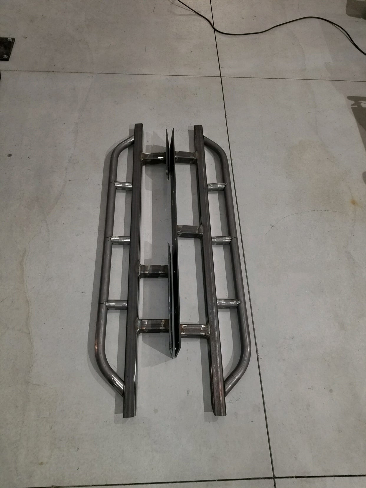

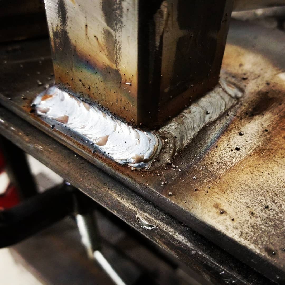

Coming together. Tubes bent and cut and everything tacked together and ready for welding. Jake has done a phenomenal job on these—I couldn’t be happier with how they are turning out.

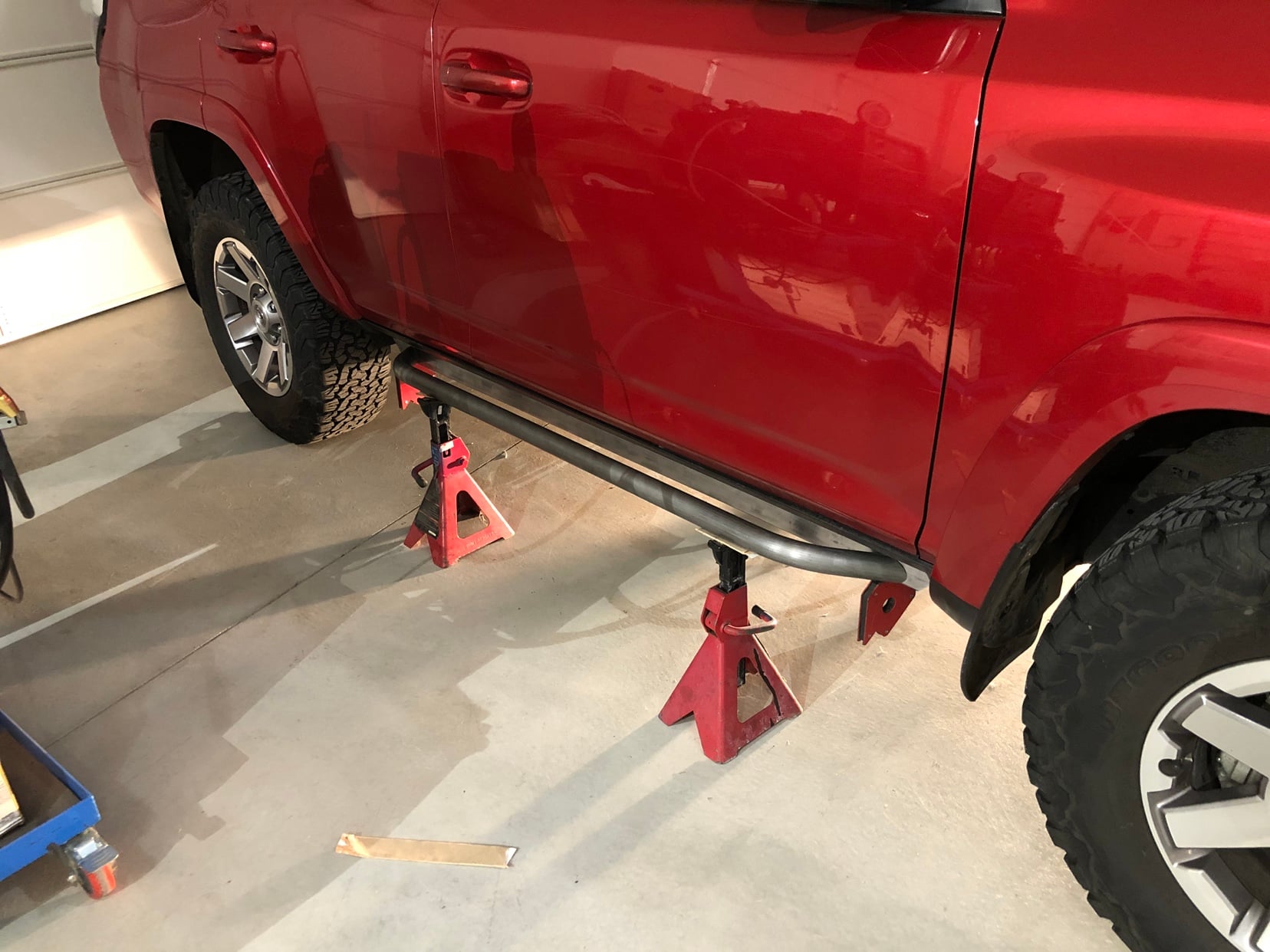

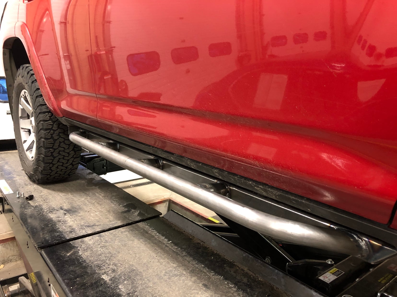

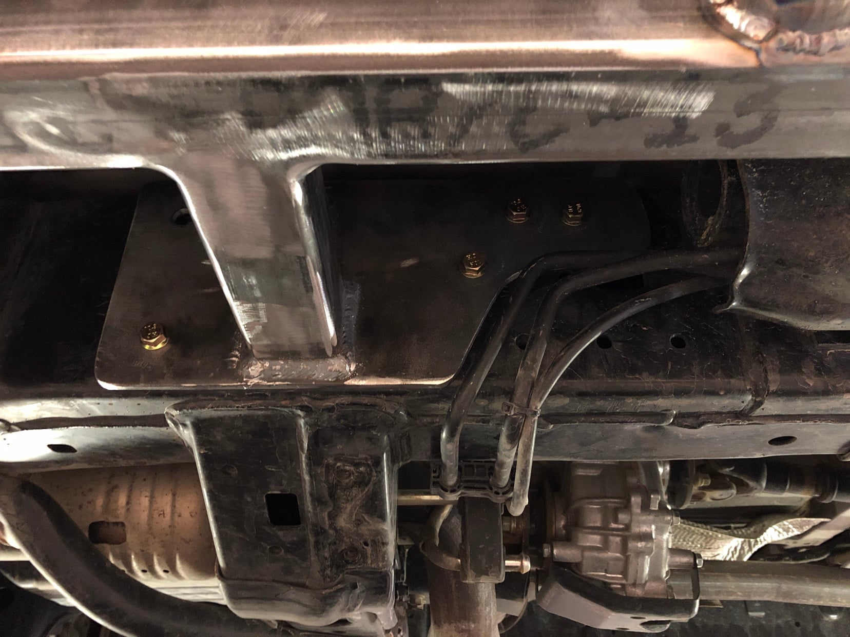

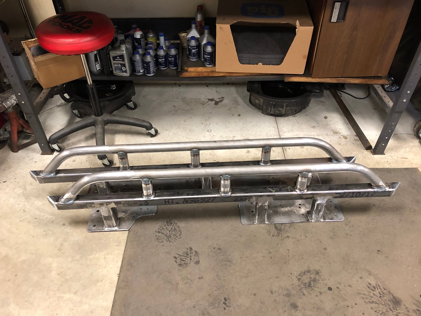

Bit of a break over the holidays, but sliders are now all welded up and tested for fit one last time. Really happy with how they turned out, Jake Burley did a fantastic job. Now off to powder coating.
