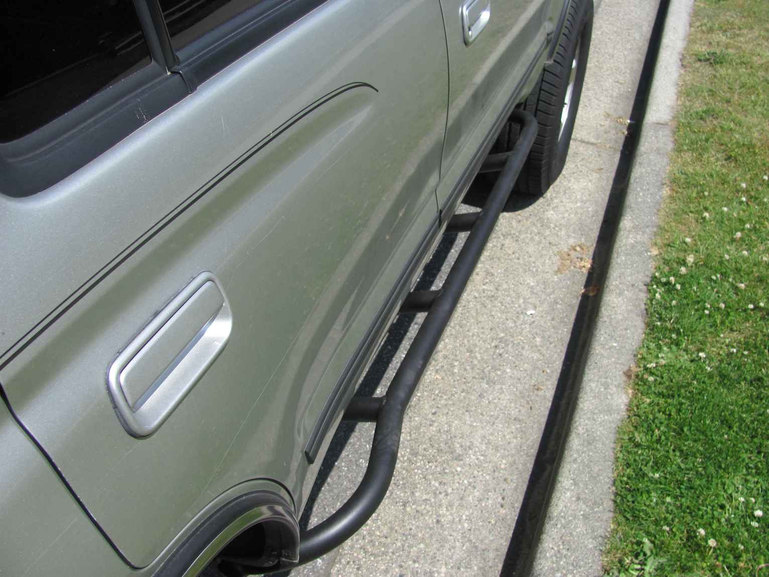

These aren't the greatest pictures of the sliders but it's all I've got. I ran mine up as high as possible. Actually had to notch the pinch weld underneath about 1/2" so they had enough clearance.
