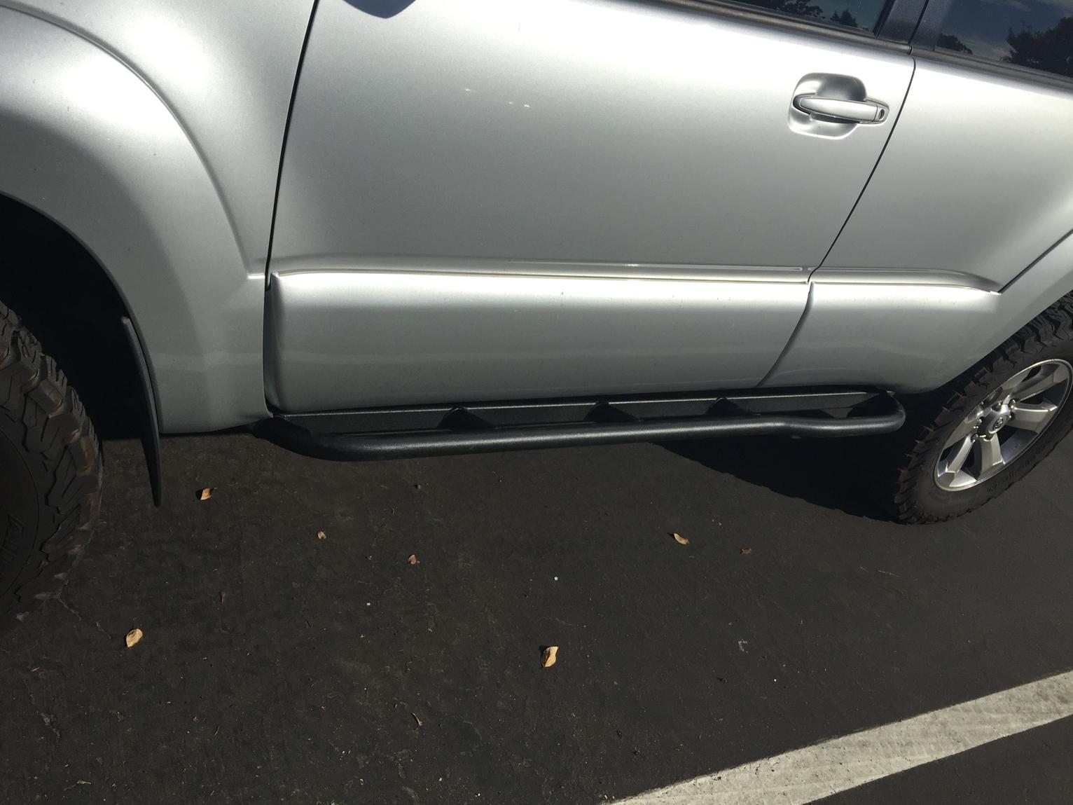

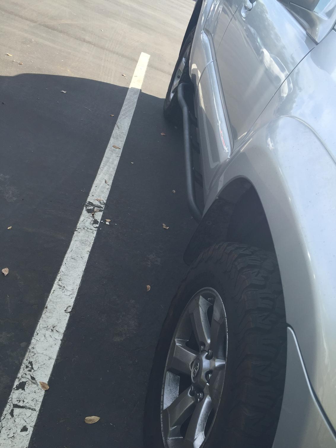

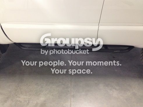

But... here's what my rock sliders look like on my '06 to give you an idea.

I don't currently have them on my black Runner but did go with 4x Innovations for my previous white one. Loved the look and price of these.

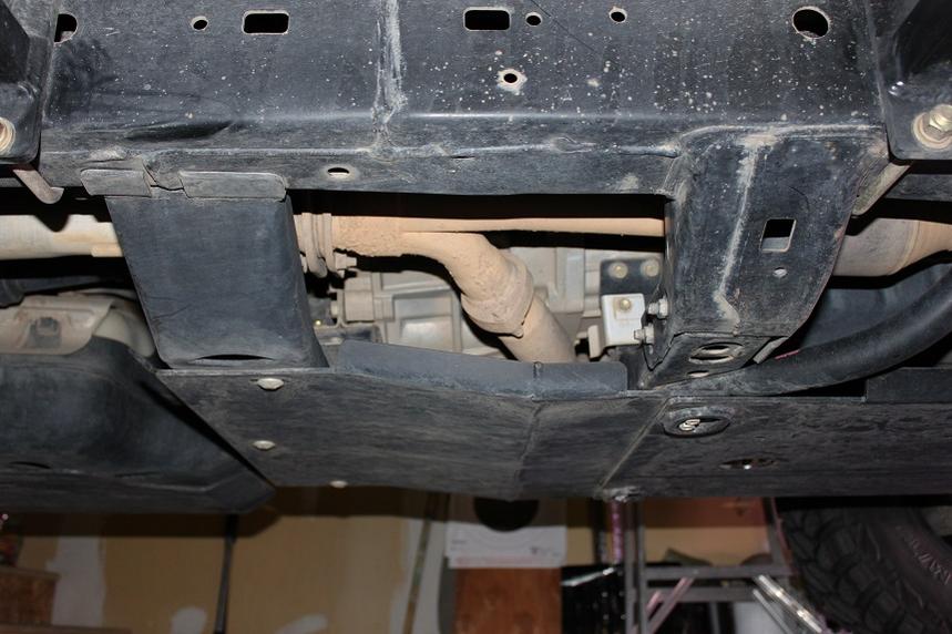

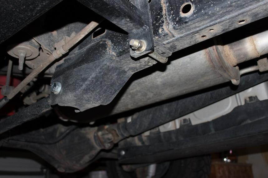

I have the White Knuckle kickout rock sliders (they use a set of 3 U-bolts around the frame to secure to vehicle... one in front, one in middle, one in back) and I have a bunch of RCI skid plates underneath. The problems (that Ive noted so far) are:
[1] The RCI Transfer Case skid plate bolts to the frame in the same spot where the middle U-bolt for the WK Rocksliders is supposed to wrap around the frame. (see the red arrow in the first picture)
[2] The RCI Lower Link skids are supposed to bolt to the frame in the same spot as the rear U-Bolt for the WK Rocksliders is supposed to wrap around the frame. (see the red arrow in the second picture).
[Note - pictures are from RCI's website... the arrows show where the U-Bolts from my sliders are interfering.]

My RCI steel skids play fine with my WK DOM sliders.
Rear link skid tucks under the slider ubolt and help keeps it from shifting upward.
