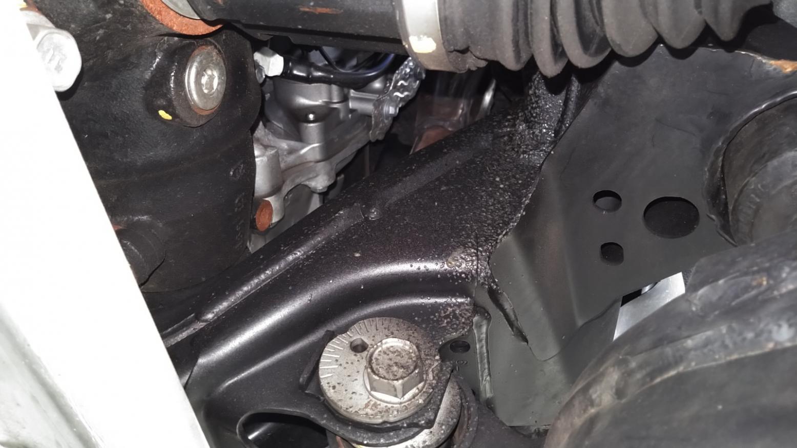

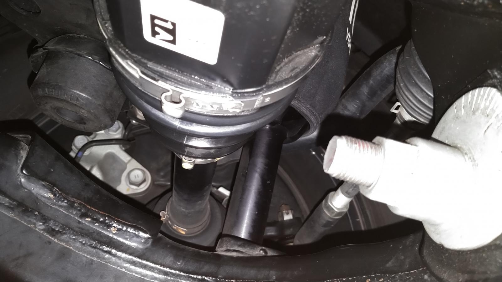

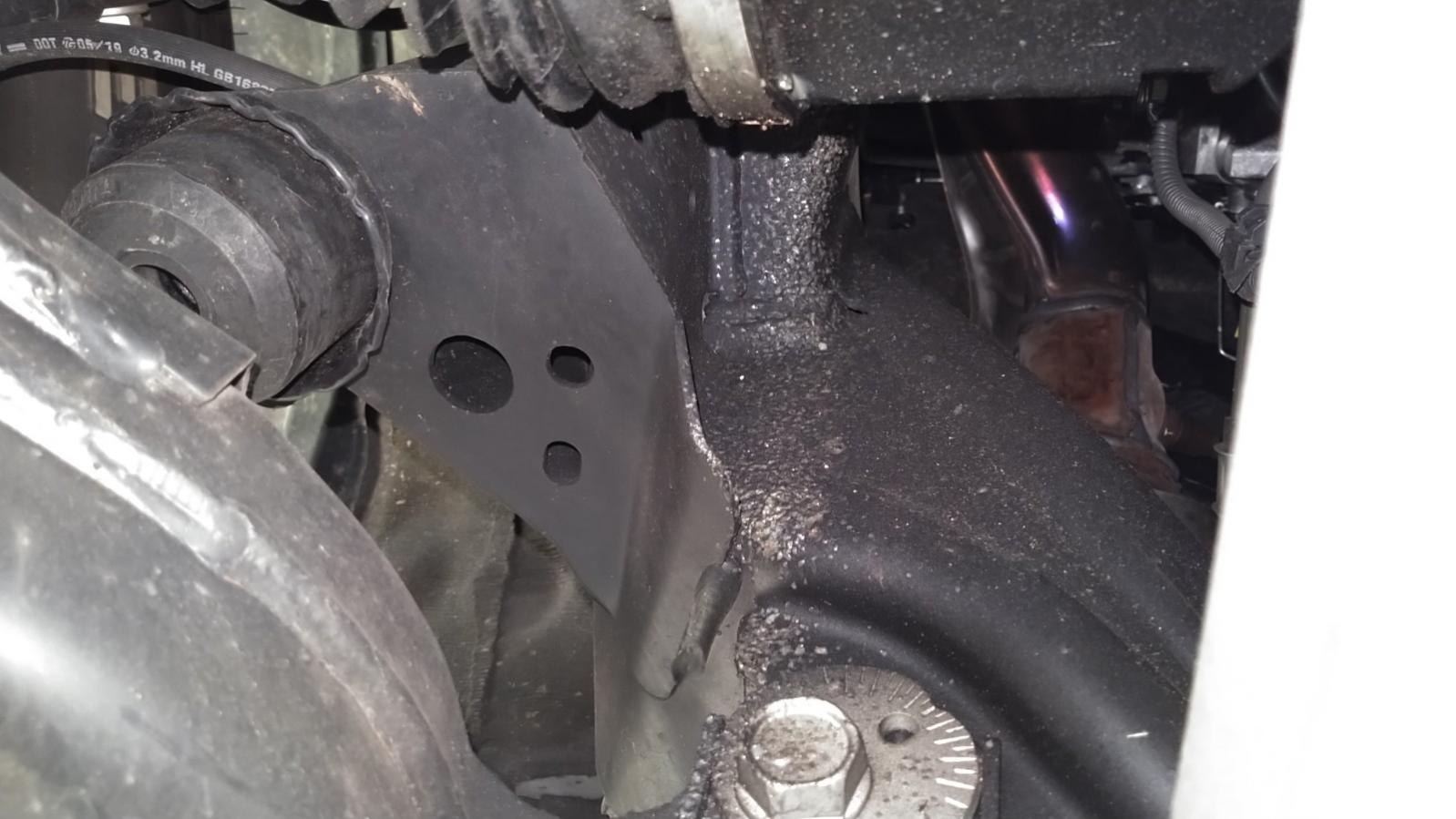

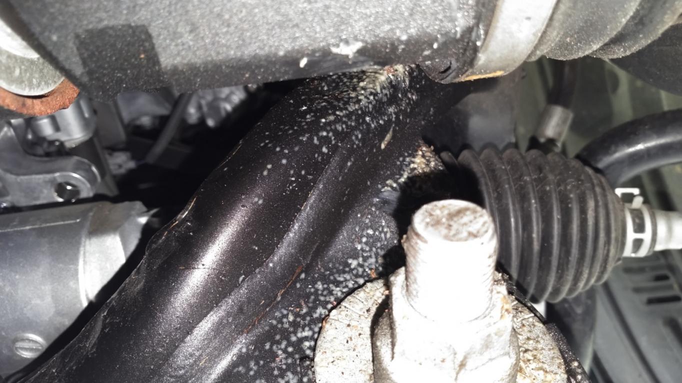

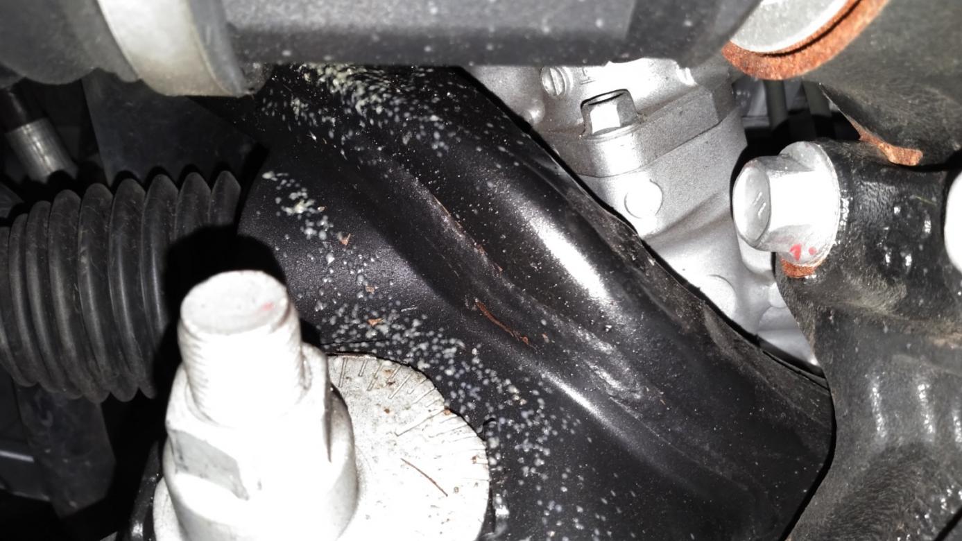

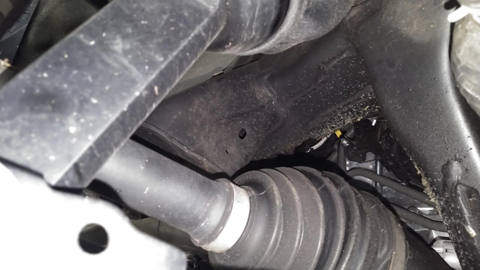

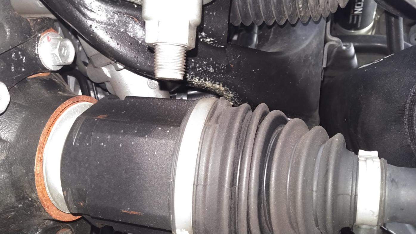

ncflyer
2019 with about 24K miles and majority on road. Not primary vehicle and today moved it, grease on the floor. Looked underneath and there is grease in the area around the inside boot on the front dif. on both side. I have a lift but not extreme, 2" maybe, boots look ok and clamps look fine.
Anybody seen or had this occur?

Yep, been there, done that. Happened on my '19 ORP when it had 27k miles. Fixed under warranty and it's been dry every since (50k miles now).
Inner CV axle boot leaking...
Make sure whoever fixes it crimps the clamps properly.
Also, several other '19 owners had the same problem. Makes me wonder if there was a bad batch that weren't properly crimped from the factory.

Maybe not crimped enough? I do recall doing a handful under warranty a couple years ago, thought it was a little weird.

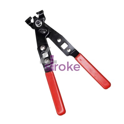

To the OP, you're probably still under warranty for that; can't hurt to ask at least? I wish the really nice CV Boot clamp tool we have wasn't so expensive, I'd recommend everyone get one vs. those boot pliers. :/
Thanks gents. I would think warranty should cover it but when I was asked about the lift got me thinking a good way for them to deny warranty. We'll see.
Same with my 19 and covered under warranty.

Don't change anything, OEM boots are probably the best thing available. All you need to do is fully crimp the Oetiker clamp. Any decent set of the pliers ($30+) should easily do the job in about 5 minutes.
OEM CV axles are $350, and you can change the boots. A kit with inner and outer boots, grease, and clamps is sold as a kit by Toyota for like $60. Also, lift has nothing to do with this problem.
ETA: As BlackWorks mentions, the Toyota tool for these is tits, but I haven't seen the same design on the aftermarket anywhere. I have some Knipex that are great for smaller ones like the TRE boots, but not big enough for the CVs. I have this style, and they sort of work with some long prybars to get a lot of leverage, but because of the slop and poor tolerance and they don't do a very good job.

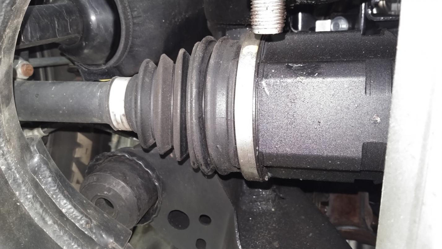

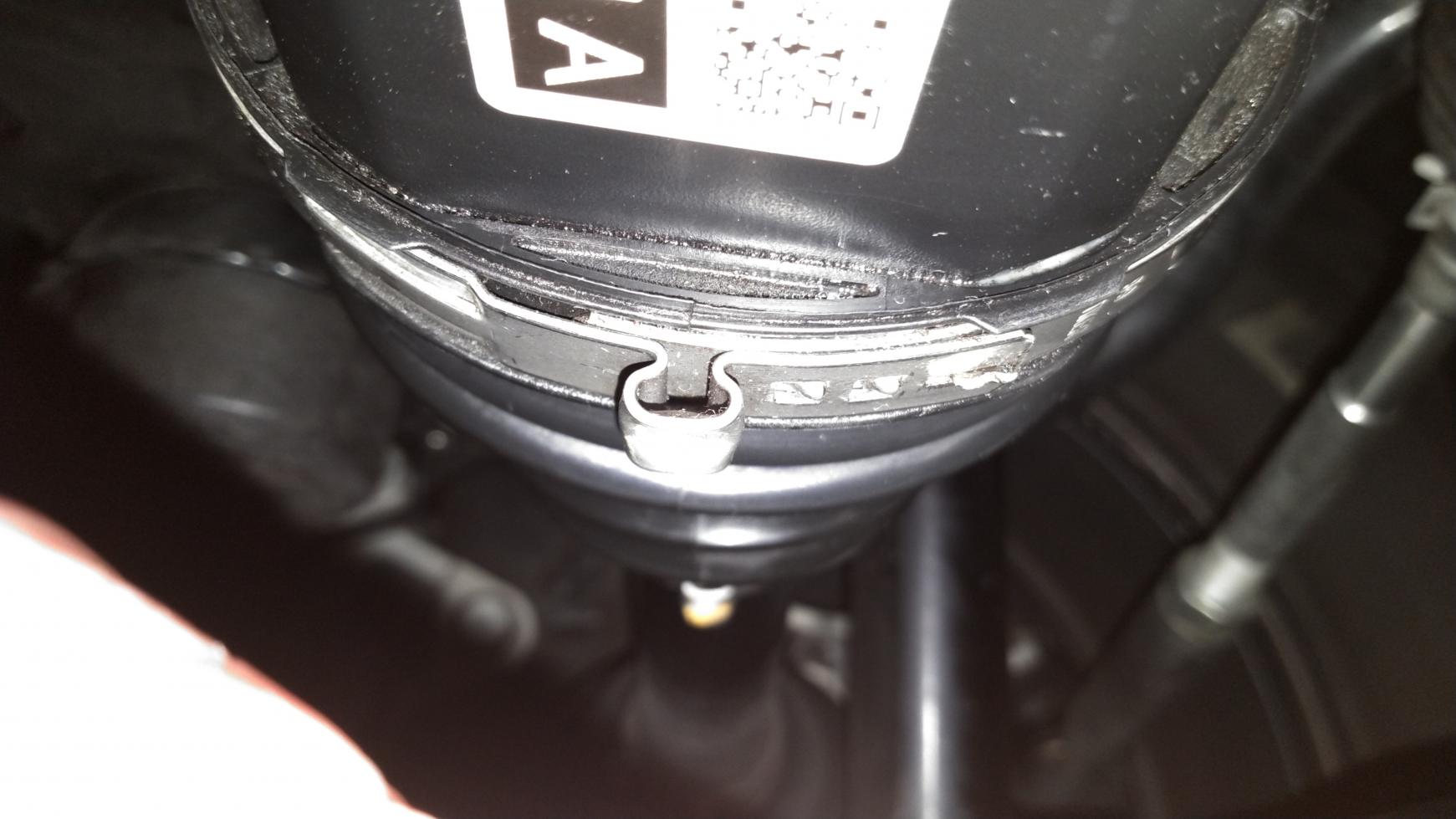

Little follow up if it may help if you see this, one possible issue...
I cleaned up the area good around the boot/axle and grease on parts around. All things looked okay best I could tell and then found this on both sides, same location. On the inside (towards diff) of the boot, at the lower part of the clamp where it's crimped, found if I pushed on this area it seemed to give slightly. You could see grease but no coming out so maybe the "point of failure" so to speak when it turning.
In the pic, the area is where the ridge and clamp/boot meet and can see the grease in the area. Cleaned it up a bit more and gonna try silicone to see how it works out. May want to do some minor moves with the vehicle to see the other ridges to see if they may be the same but think it may be just these areas since same on both sides.
I have a mild lift so may not apply to others that are 3" or so since the angle will definitely be more.

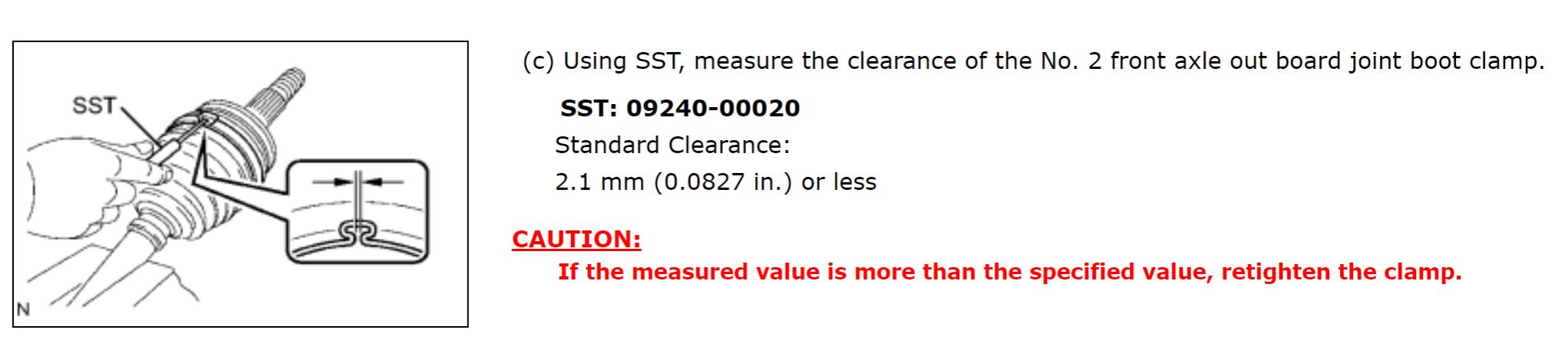

I think the clamp may be a little loose. If so, a rise in ambient temperature combined with a recent lift may force out some grease. Here is a spec for checking the clamp.

As to the OP's concern, the clamp looks like it could do with a little more crimp. I'd go and buy one of the tools that was pictured earlier, they're not the best; but unless you want to dole out the cash for a Toyota SST, they'll work fine. Get two 1/2" breaker bars and carefully squeeze the crimp on the clamp a bit tighter, I say carefully because with the tool that Jeremy556 mentioned it's easy to twist the pliers and either stretch or break the clamp when you're trying to tighten them (especially if your using breaker bars.
But I can tell you that the majority of the time I have seen that type of light grease seepage it's been due to a slightly loose clamp. In most cases I just snug the clamp up, hit it with brake clean, and have them keep an eye on it; rarely had any that came back needing to be fully replaced.

Thought I'd try one more time to see what a tech thought and went to a local dealer vs the previous one (had purchased from there).
I did mention I had taken it to a dealer and what their decision was. After looking at it, this dealership will be changing both cv axles under warranty. I asked about the lift as mentioned by the first one and was told the tech said there was still enough movement/range that it wouldn't have caused the leaking. He said pretty much BlackworksInc wrote. About the same to replace it all vs trying to fix a certain part so I get new axles.
Thanks all for the information/advise. Safe travels.
Still some sort of leak?
Hadn't seen any issues after the warranty swap and has been mostly sitting in a garage since. I drove it about 300mils or so and though not slinging grease or dripping, did find "fluid" grease on skid and around boots were wet. Looks like a coating but no obvious spots as before. It has been in the 90s so maybe residual from Remove and replace and just "melted" so to speak with the heat?
Will wipe it down and see how it goes after and may go by dealer just to make sure.
