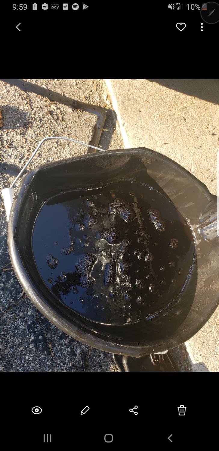

I drain the fluid and it looked like the attached picture of black fluid in a bucket. I also noticed that there was a rubber gasket which wasnt OEM obviously because it wasnt Toyota FIPG.

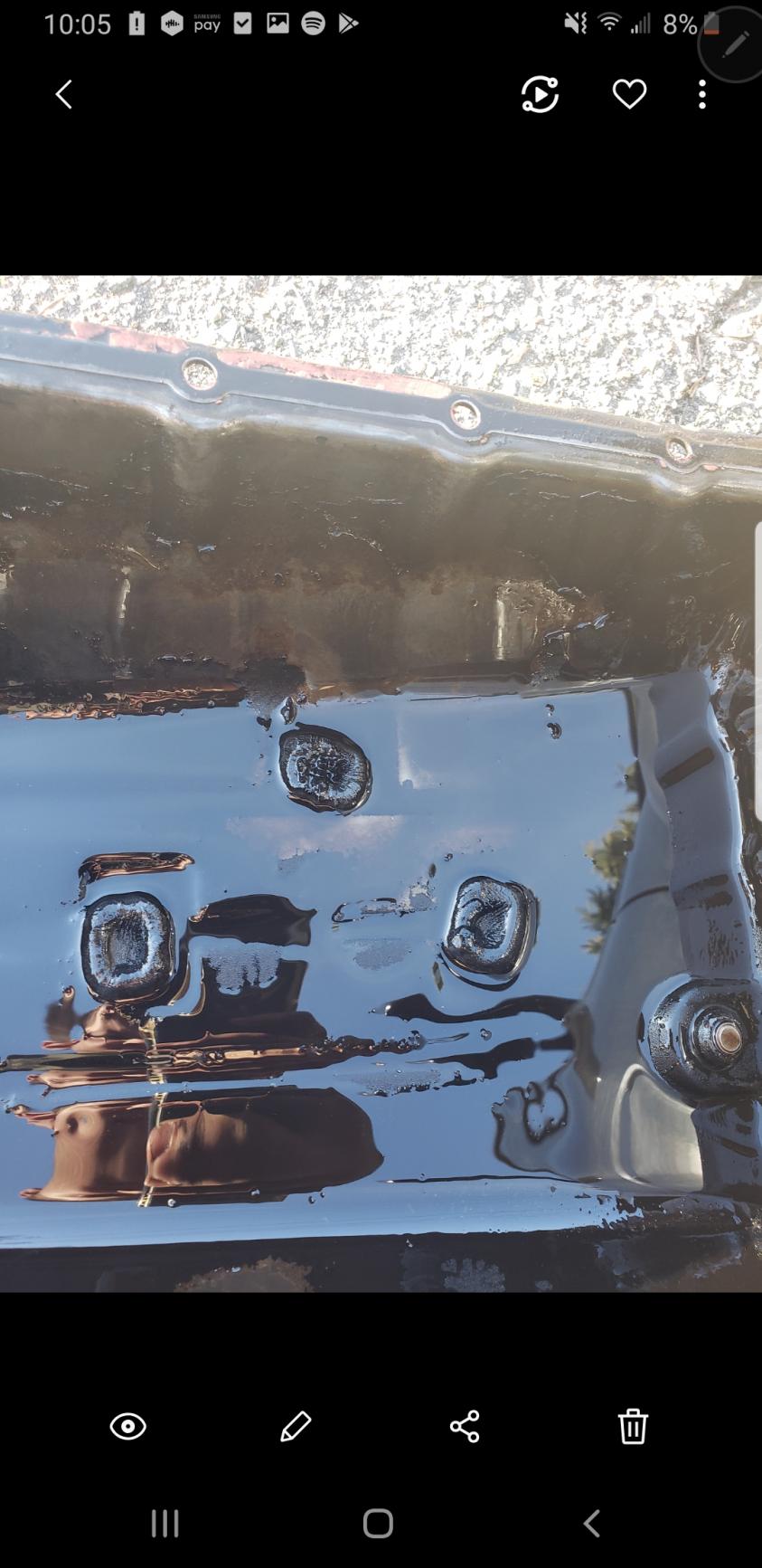

The magnets were filled with goop more so than the other unit I purchased and more so than any other documented magnets I had ever seen on this forum or any YouTube footage.
I cleaned the pan and the magnets, installed the new filter and reinstalled the pan, this time with JB Weld high temp RTV as I didnt want to risk using the good stuff (the Toyota fipg I have) if it didnt work out.

P.S. I quite literally called a mechanic buddy of mine during this process to ask if trans fluid and oil could mix. (Out of my own stupidity.) And those magnets have a pit in the center of them because I had already pressed on them with my finger. Before I had done so it was just a mound of crap. But no large shards. Cheers!

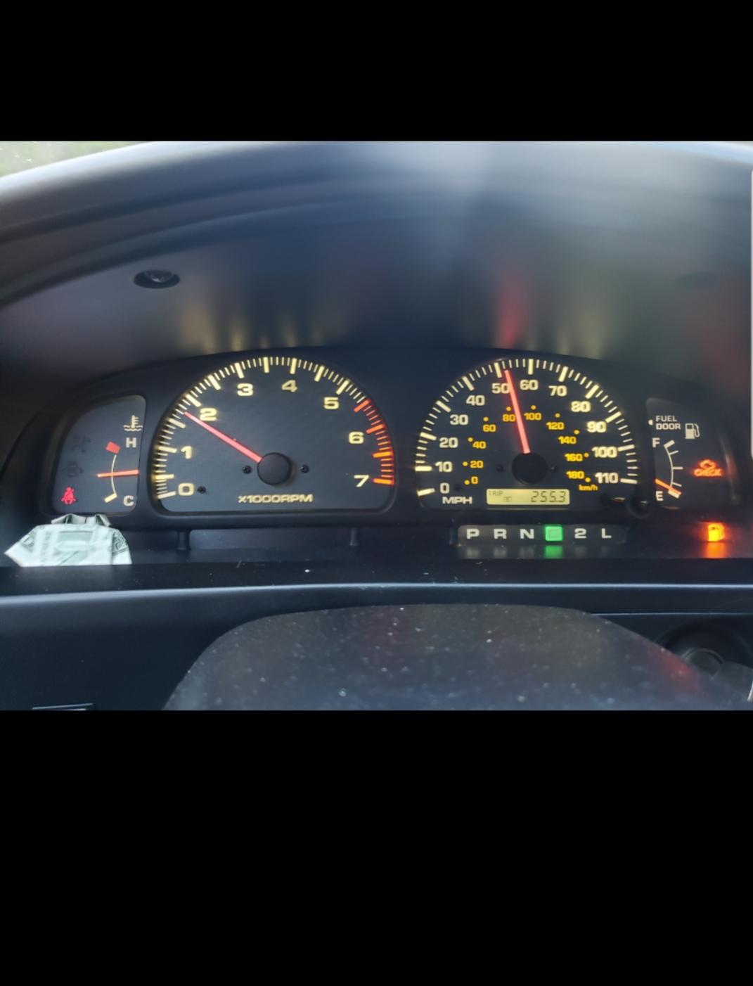

First tank of gas through and trans is still running great at all temps. Even on cold starts. My magnafine trans filter is on it's way. I got the black ribbed 1/2" one from the website. I'll use an adapter if need be. Check engine light is from a misfire due to Injector. Need to send my extras out to be cleaned and flow tested.

No wonder it survived. Looks like you have a 99-00. Nice save but definitely keep that spare transmission on the side.
