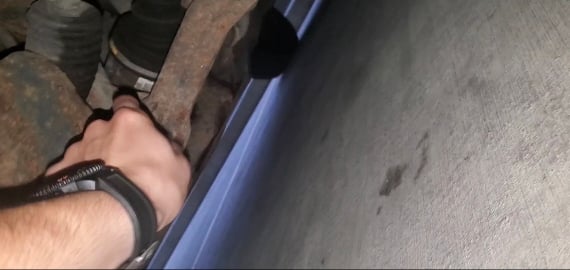

Upon closer inspection the steering bar thing that connects the wheels to the steering wheel has some up and down play to it.
The inner tie rod end on the FL side is leaking something. Not sure what.

Is that leak grease or steering fluid? Hopefully ball joint grease. If not you may have seals going bad in your steering rack. That would also explain your contaminated, burnt fluid. Possibly aeration occurring within rack also. Would cause all sorts of steering issues. Are you having to add fluid occasionally? Hopefully that's not the issue, that sucks. For your other steering components you can check for excessive play at the bushings and joints carefully with a pry bar. Was the other CV axle replaced, that going bad could also cause those symptoms. Check at the joints for lateral side to side play. There should be none but you will have about an eighth inch of in, out play. I would first rule out the steering rack because that's a pretty in depth rack replacement or rebuild if you're into doing that kind of work. Very expensive part and a mechanic will charge the crap out of you. Hope it's something easy

You're pointing at the CV axle inner joint. The other boot is your inner tie rod joint. It looks like it's leaking from there. If that's steering fluid which I hope for you it's not the rack seals are going bad. That would explain your fluid issues also.
