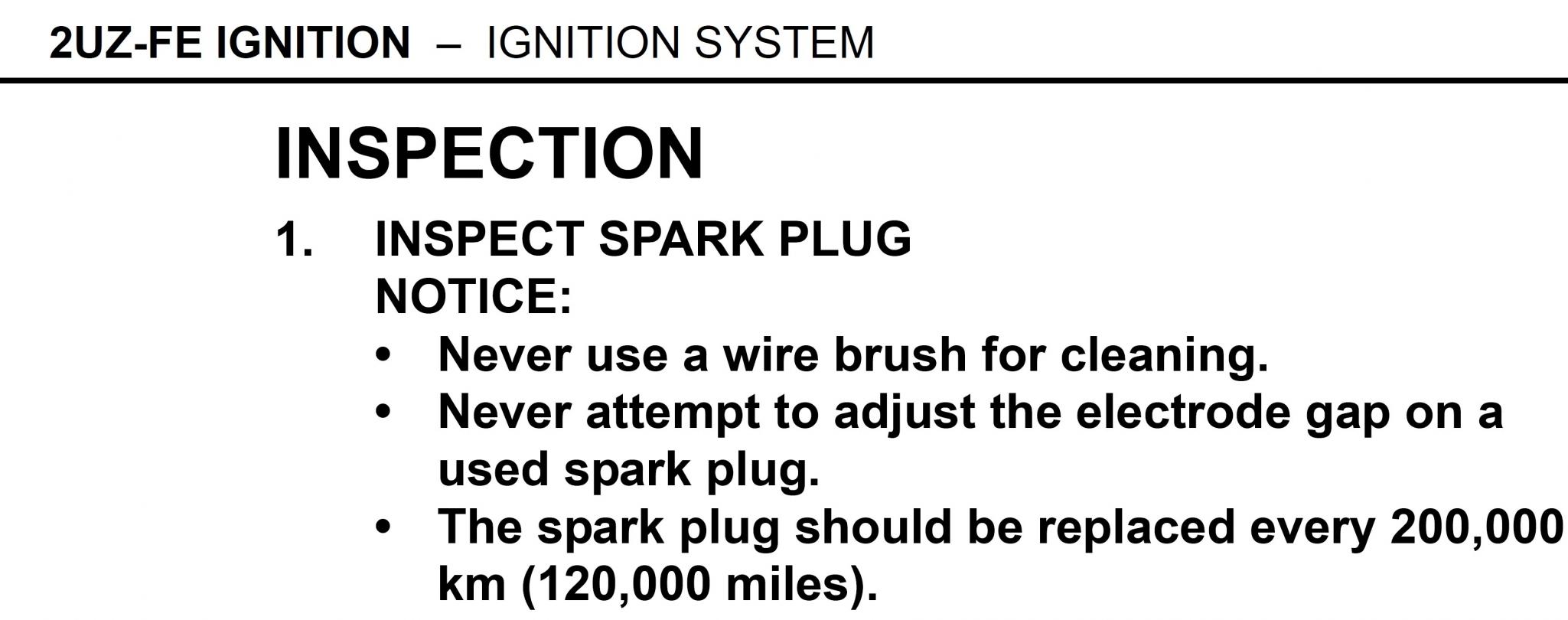

Manual states spark plug interval is 120,000 miles on page IG-2 for the V8. Then it recommends Denso Plug P/N SK20R11 or NGK P/N IFR6A11.
Gives a spark plug gap of .039-.043 inches.
The 30k statement in this thread is incorrect.

I am quoting the Toyota Factory Service Manual for a 2003 4Runner. A haynes manual means nothing compared to what the Japanese published as official OEM document. They even tell you what spark plugs to use....
