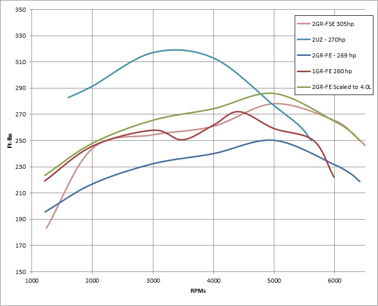

If the TIS charts for the 3.5 and 4.0 are correct, the 3.5 holds its own with the 4.0 on a ft-lb/L basis. The 'problem' of the current 3.5L is it simply smaller than the 4.0, thus down ~15% on torque during the meat of the powerband, even if it does quite well for being just 3.5L. A DI 3.5L should help quite a bit, although the 1GR-FSE is lacking below 2000rpm.
I've driven a 2012 rental Acadia (wider/taller/longer/heavier than a 4Runner)with the 3.6 LLT. It has better dyno stats than the 1GR-FE, although I can't find an actual chart to compare torque curves. One the one hand, the engine felt more anemic cruising than our 2014 4Runner, but I was in the Santa Fe area and was around 5,000-10,000 ft the whole extended weekend. However, when I wanted it to get up and go, it did so without hesitation. The 6-sp tranny was nice on the interstate. I was able to coax 25mpg out of it, whereas 20mpg is the best I can get out of the 4Runner, with similar driving strategies.

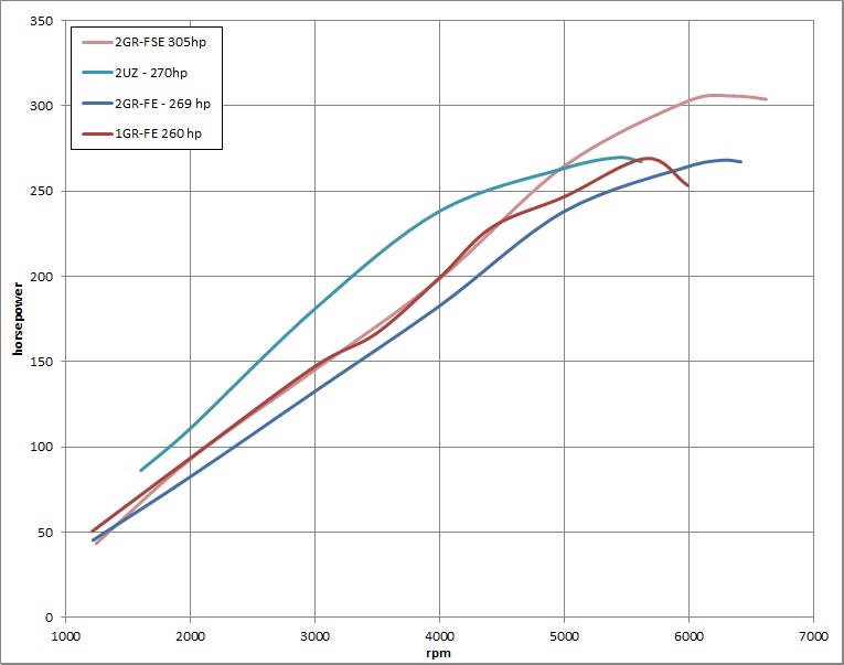

Nice plots! The y axis scale is a little misleading at first glance, though. Mind plotting the power graphs as well?

I'll post up the hp plot when I get home this evening. I like plotting torque more than hp as it is easier to see the % difference between engines because the y-axis has more resolution when plotting hp.

Doesnt the 1GRFE make 270 HP with dual VVTI? Are those wheel torque or crank torque?
The dyno for the 270hp version of the 1GR-FE hasn't leaked onto the internet yet. So, the 260hp version is the best I've got. Fairly certain the 270hp version has a very similar curve at low/mid rpms.
The charts are the crank numbers from TIS.

Is this version of the 1GRFE dual-vvti? If so, we clearly see the VVTI acting-up at 3500rpm in the torque curve. I agree about resolution of HP and torque graphs, never thought of that before.

This chart shows why the 2uz V8 in the 4th gen is so widely loved. It makes a lot of torque at low rpm and feels very responsive without having to rev it to 5000 rpm. Torque is what make a vehicle feel very responsive. The 2uz has good instant torque and requires very little throttle opening to get moving quickly.
It's the FJ flavor of the 1GR. It has dual-vvti, but is missing 10hp for whatever reason (more constrictive exhaust system?).

Last time I read about that, the reason given was a chocked intake system that was causing a slight loss of HP on the fj.
Ours must be nearly identical to this one, only dropping slightly slower toward the last third of the torque curve due to a less restrictive intake system.
