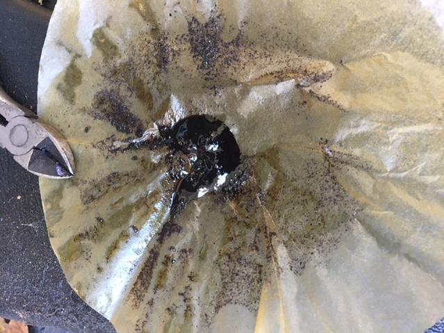

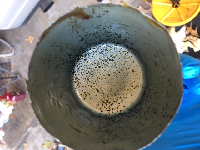

I've been running Quaker State synthetic 5W-30 the past 2 oil changes, adding 6oz of Marvel Mystery oil the day before each oil change. Most recent change is shown in the pics below...2100 miles on this oil fill, the oil on the dipstick was dark brown again.

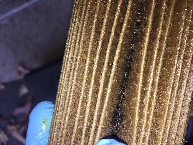

The oil & filter seem to be doing the job here. The coffee filter was inserted into my funnel, and the contents of the oil filter can were poured through it after it was cut open. The black goop in the center was left after sitting overnight, too thick to pass thru the filter.
This was the 5th oil change over nearly 9k miles since I bought it. First oil change was with Shell Rotella T6 0W-40 diesel truck oil and it really busted sludge, but it's very thick for cold weather use in this engine. QS synthetic oil has nearly as much calcium detergent, and plenty of antiwear additives. And it was on clearance at Advance Auto for cheap. Goal is to gently minimize the sludge before I open it up next year to replace the stretched timing chain, so the new chain isn't bathed in soot particles.

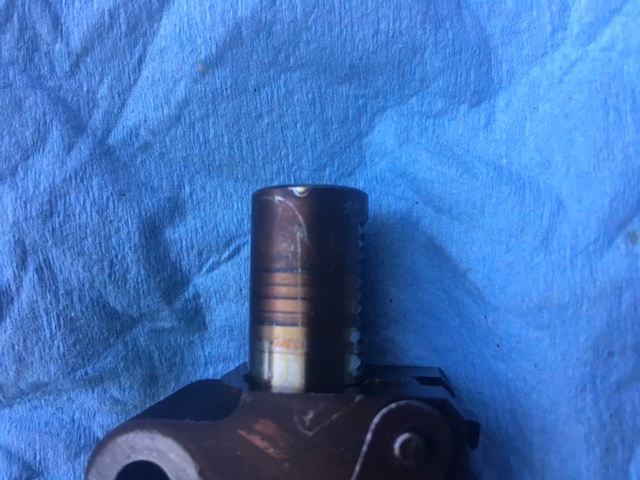

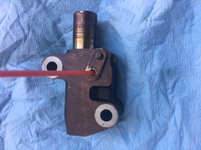

Easy way to tell if the chain is stretched: remove the small 4-bolt cover plate on the front of the timing cover, just above the power steering pump. Stick a mirror or your phone camera in front of it and get a view of the timing chain tensioner. If the piston is over-extended as shown in the pic below, it's stretched. Mine runs well even in this condition, as long as I let it warm up in the morning after the first start each day before driving off. If not, P0016 and the check engine light are guaranteed.
